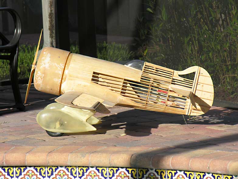

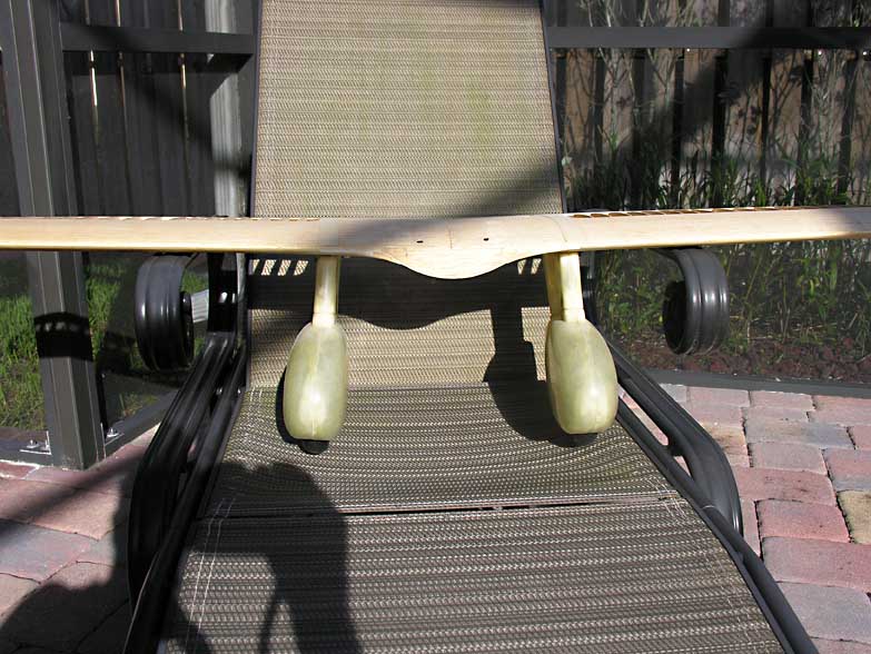

I'm converting my R/C Gee Bee Z to CL. I've already had a few conversations and help, from others, in another Thread. Thanks for that.
What I don't want are "slots" in the fuselage side for the bellcrank/control lines. I'd like to have only two small holes with grommets.
I'm thinking some kind of roller set up, or possibly just changing a grommet from time to time because of wear.
Are others eliminating these slots for some other cleaner set-up? Is there a system?
OR! Is it possible that the control lines will be in the wing only? If that's the case, I'm home free!

Unfortunately you can't really have the lines inside the wing because the CG of the model will be located well above the wing which would cause the model to fly rolled outwards. A couple of ways to avoid having large slots in the fuselage side would be to use a circular bellcrank where the leadouts wrap around the bellcrank and just roll off it with control movements. Another possibility is monoline as used in speed models but it'd be worthwhile building a trainer to get used to how it all reacts. What I'd do though is to use a quite large bellcrank, at least 4" but the bigger the better. That way the variation in line spacing from neutral to full up/down at the bellcrank could be kept to a minimum.

Indeed you would be wise to bite the bullet and use over wing standoffs with a large bellcrank located somewhere near the vertical CG point with fuselage side exits. The KISS principle always trumps complexity just for the sake of a couple of exit holes.
It is afterall control line and the lines on anything are always going to be obvious.

There is no reason why you could not have small exit holes in the side of the fuselage though just for the lead outs. Maybe you could fabricate a removable lead out guide at the tip when not flying? It will have to be there though for sure. It could be made out of a transparent material so it will not be as easily seen. You do need to adhere to the vertical CG though.

If your lead out guides on the wingtip are at the same height as the vertical position of the CG on your airplane, all should be well.

And to find that point one could just set the height at or level with the center line of the crankshaft or just a little below.
If you want to find it precisely cut, fabricate and install the leadout guides now in such a way that the airplane can be suspended by the guide above the left wing. Simply find the point on the plate that the airplane will hang perfectly straight down and that is where you make the guide holes.
Why you are at it I would make this plate adjustable fore and aft for flight trimming. The idea is to allow the lines to be adjusted from ninety degrees to fuselage axis to slightly aft of that point. In other words this allow the airplane to point slightly to the outside of the circle. This fore and aft adjustability of the guides will be important in trimming the airplane to stay on the lines, I.e. keeping it from chasing you across the circle.

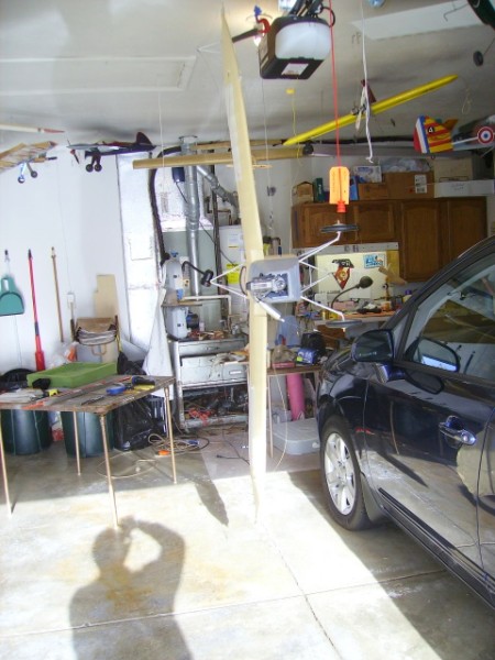

The pictures below show the technique I use to set the leadout guide.
The first picture shows adjusting the vertical location of the line guides for flying wings level.
The second picture shows adjusting the line guides horizontally to have the model hang slightly nose down to retain line tension.
Clancy
