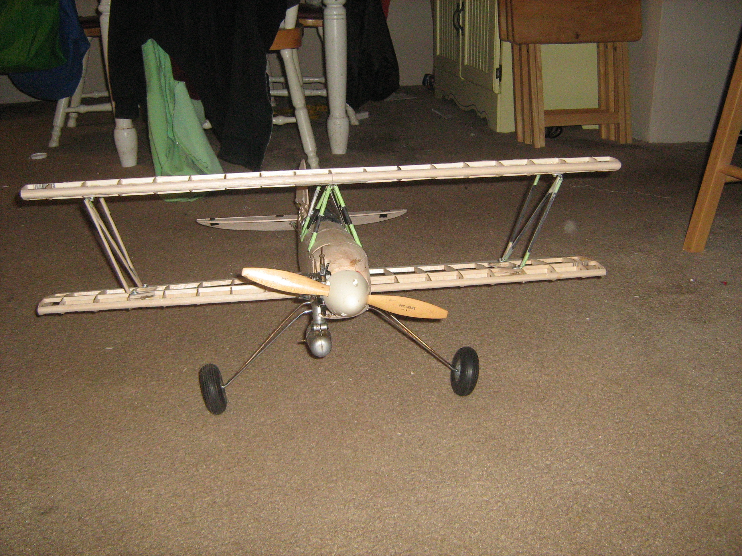

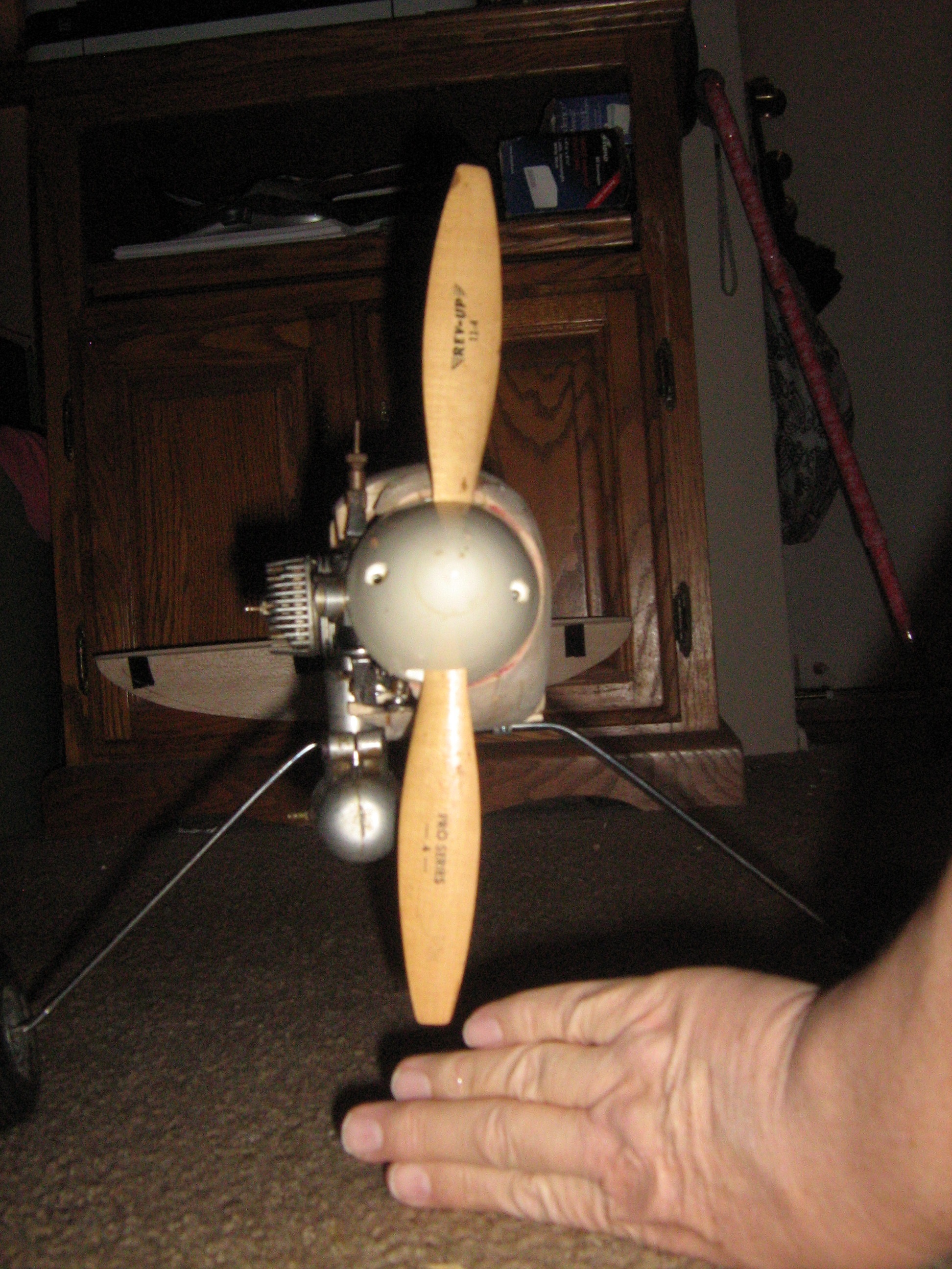

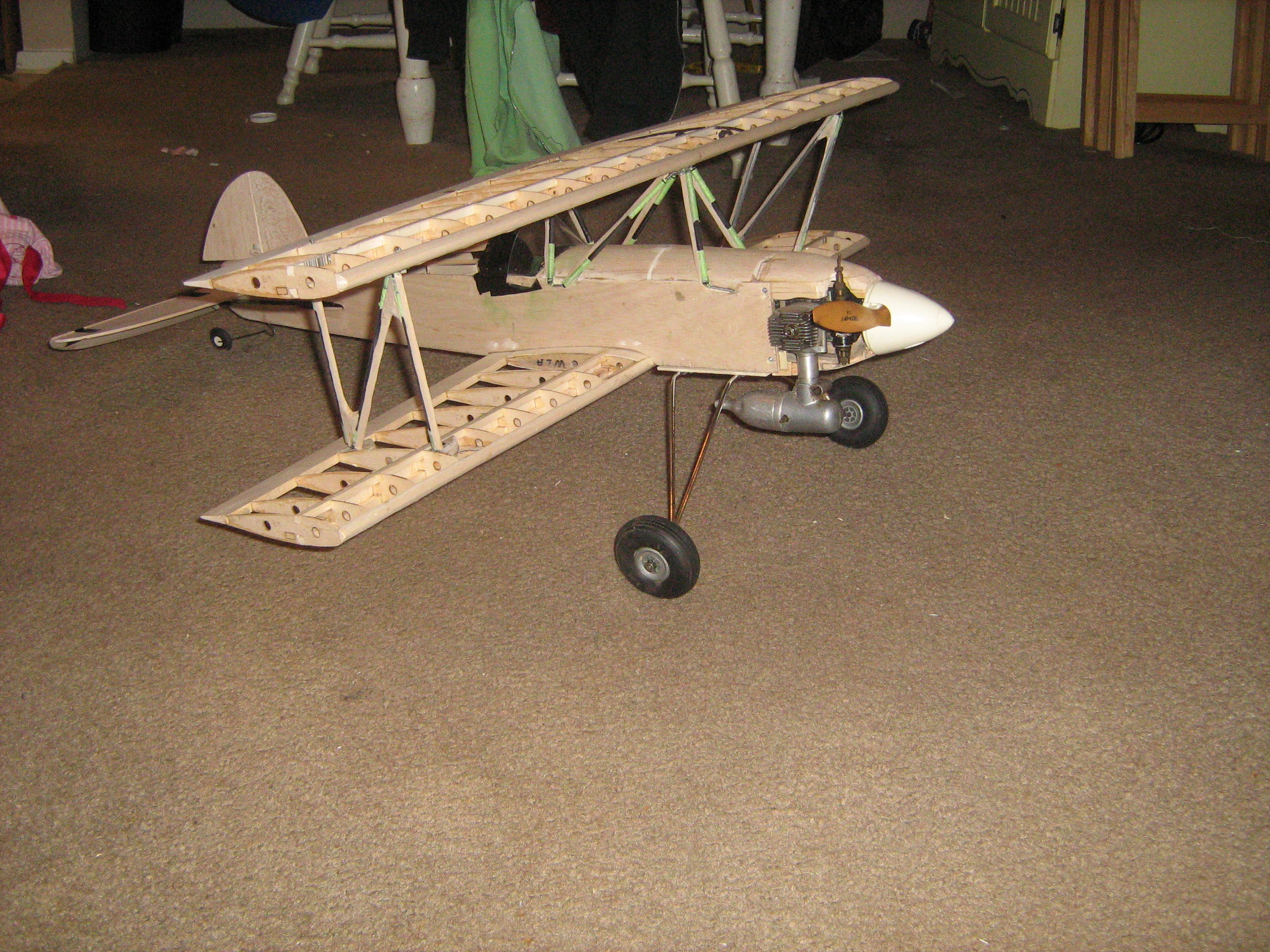

Well today I put her on her feet. Well two of them.
The main landing gear is fastened to a ply plate with plastic landing gear straps. And then the ply plate is held with screws to the bottom of the plane. The landing gear plate is also access to the tank area.
I was completely bone headed When I closed up the back of the plane. I FORGOT THE STUPID TAIL WHEEL. I will have to cut open a small section for a mounting block and install a tail wheel.
I think I should have plenty of ground clearance.
Now I got to get back on the struts.

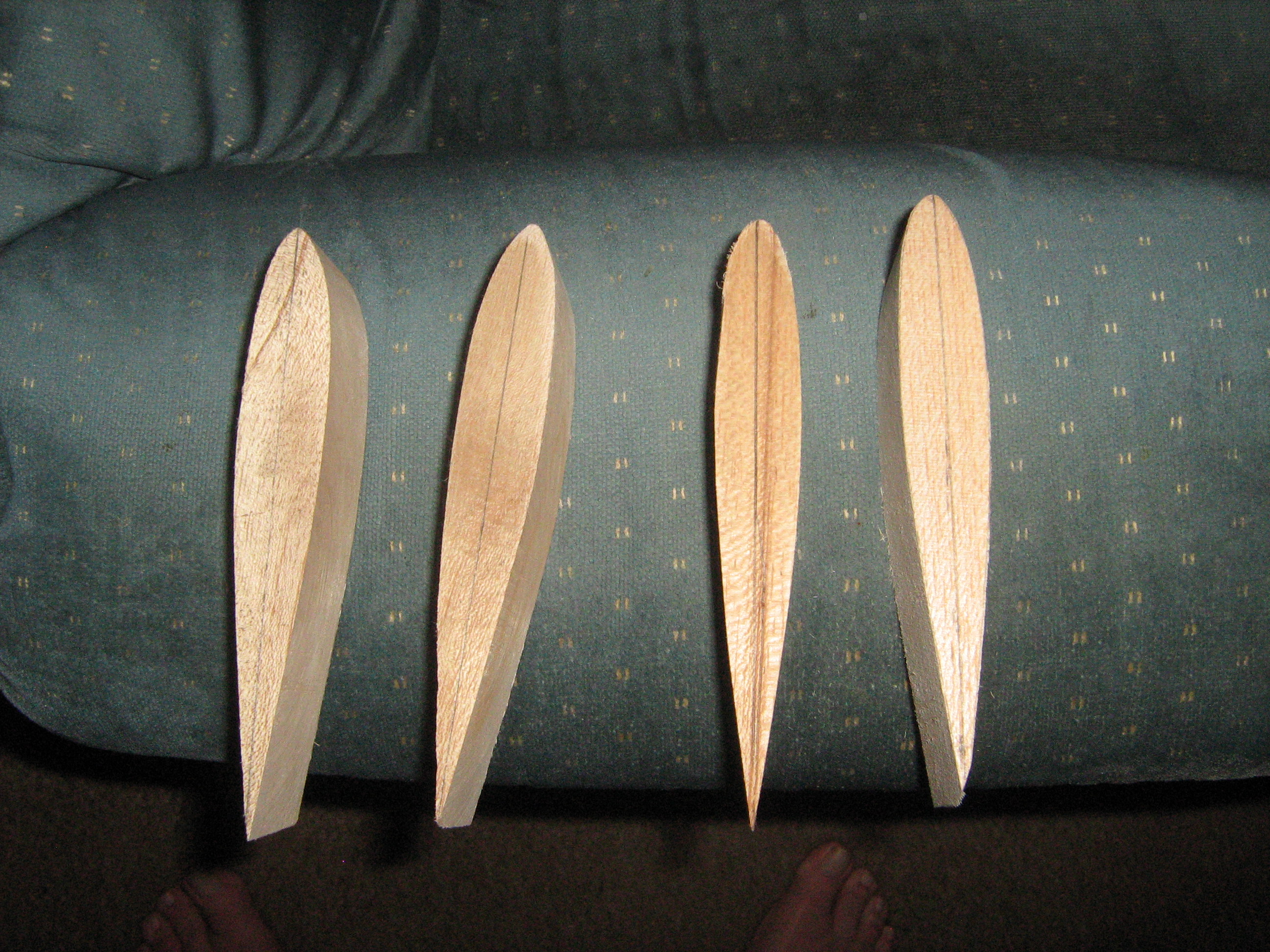

Carved on the struts. I decided to remove the front fairing on them, and just leave the rear fairing.
So time to mount em up. Here she is all her bones.

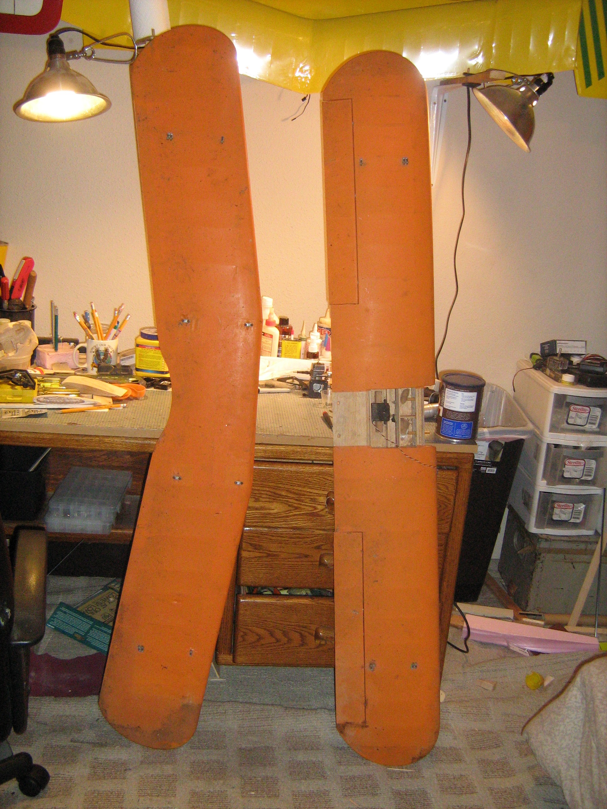

I just check the wing stiffness. They are way stiffer and stronger than I expected. The L.E.s seemed rather light and small. So each wing seemed week in torsion. But when they are joined at all three points they are actually very stiff torsionaly. So I am no longer concerned about structural integrity.

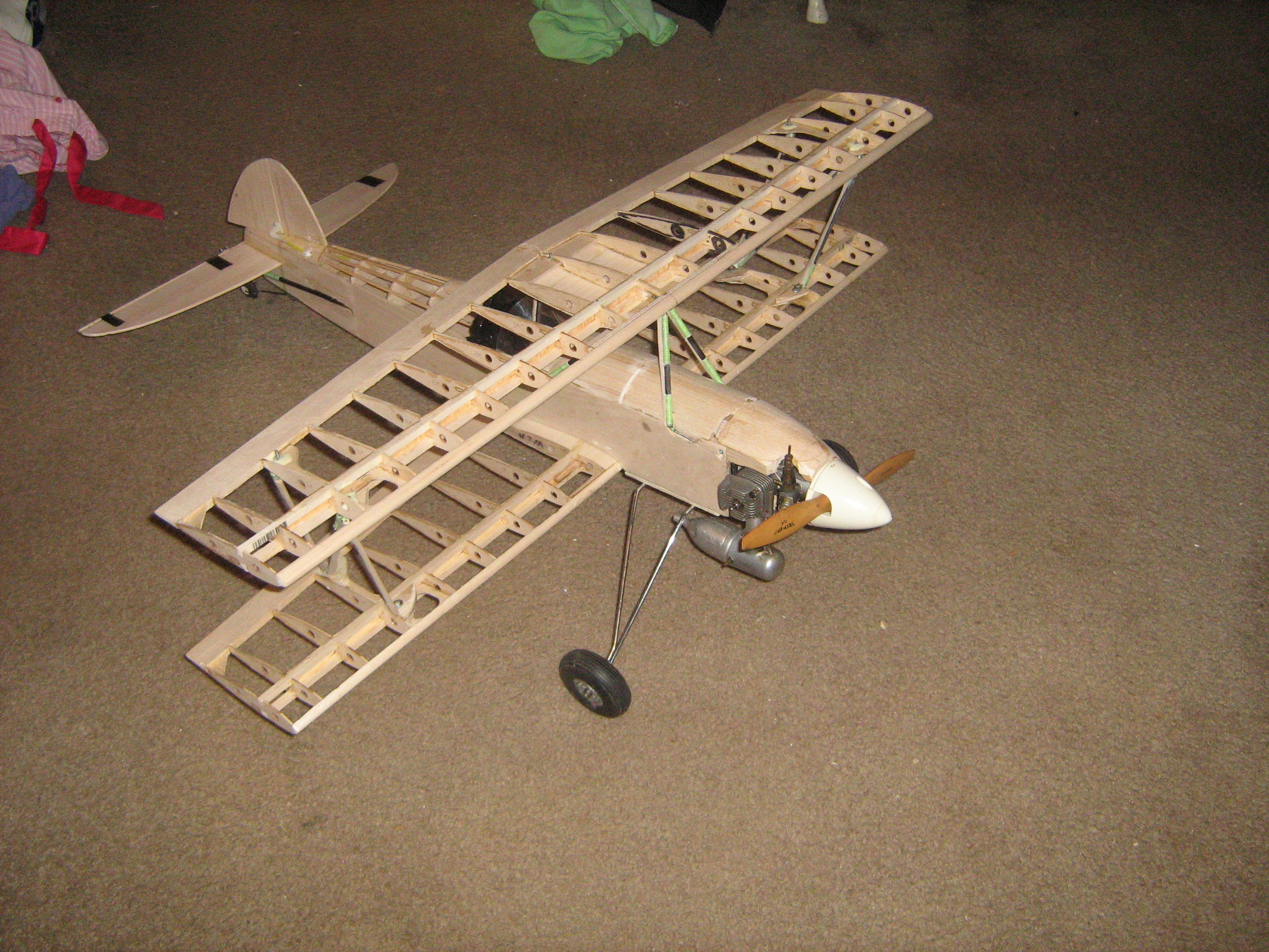

Epoxying the cabanes to the fuse as I type. It will be a bit before I can touch as it is 30 minute epoxy.
I am not making any changes to the bird, but I am at that point where I can fully see it and see things I should have and will do different on another build. Some structural, some assembly. And I see some aesthetic things. Even longer wings would look better and lower the wing loading. That would have been a good thing to have done.

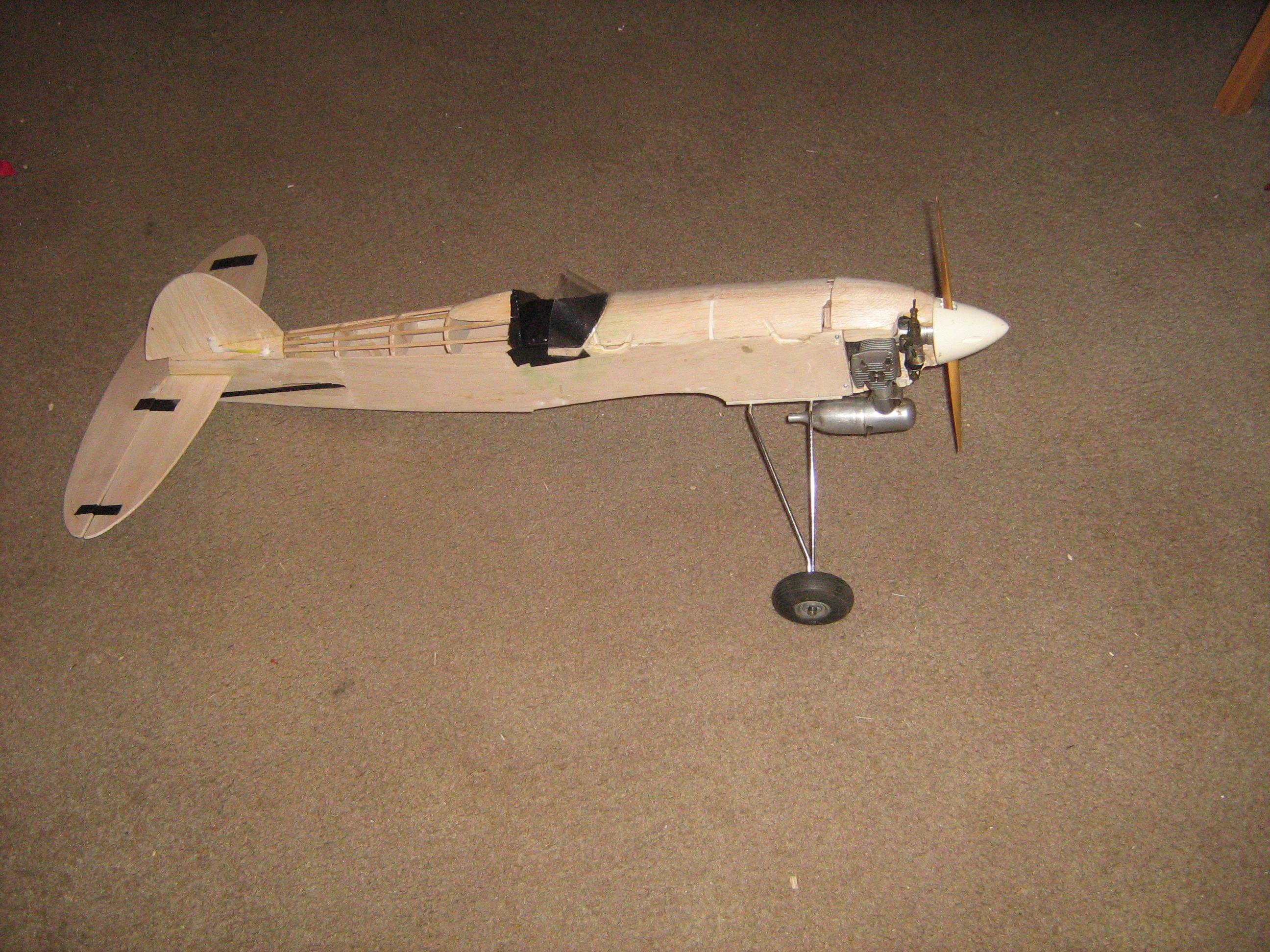

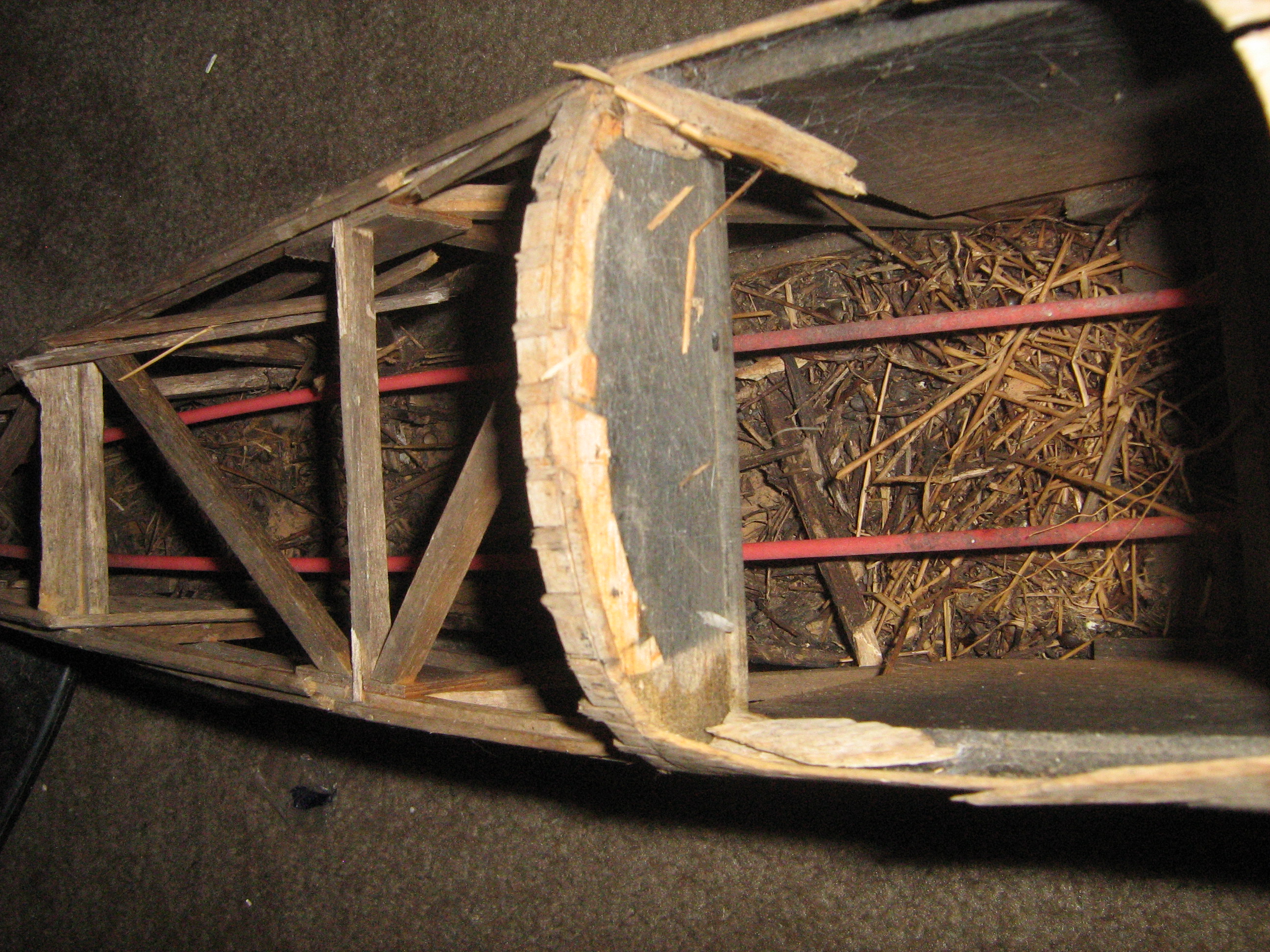

This last week between pack and out right lazy, I have been working to salvage another plane that I pulled out of a friends garage he has in the country. It is the sole building on the property and so not in good repair. I had and still have a bunch of stuff stored out there. I had some planes and wings stored there. Well We needed to get some things out and so I took a look at my planes and decided they had to come out and come out now. The weather was getting to them, and critters. Mud Dobbers had used them to build mud nest in, and mice also. I am surprised I have not encountered in rattle snakes or black widows. I know they are there.
The plane I valued the most out there was in by far the worse shape, a Great Lakes T2A. Mice had nested in the aft belly and it was rotted. I thought the tail might just fall or snap off moving it. And knew it could not survive a move to a new storage. So I decided to clean all the planes up and upon George's (ghostler) suggestion I sprayed the GT 2A fuse with a 50 50 bleach water solution to guard against rodent born diseases. ?? Hantavirus ??
So between packing I have been busy trying to get the fuse strong enough to safely move. Only the top two braces were intact, spruce and maybe 3 upright braces.
Long story short I restored all the aft structure and removed the stab that was just hanging. So now the plane is safe to move and store till I can work on it later.

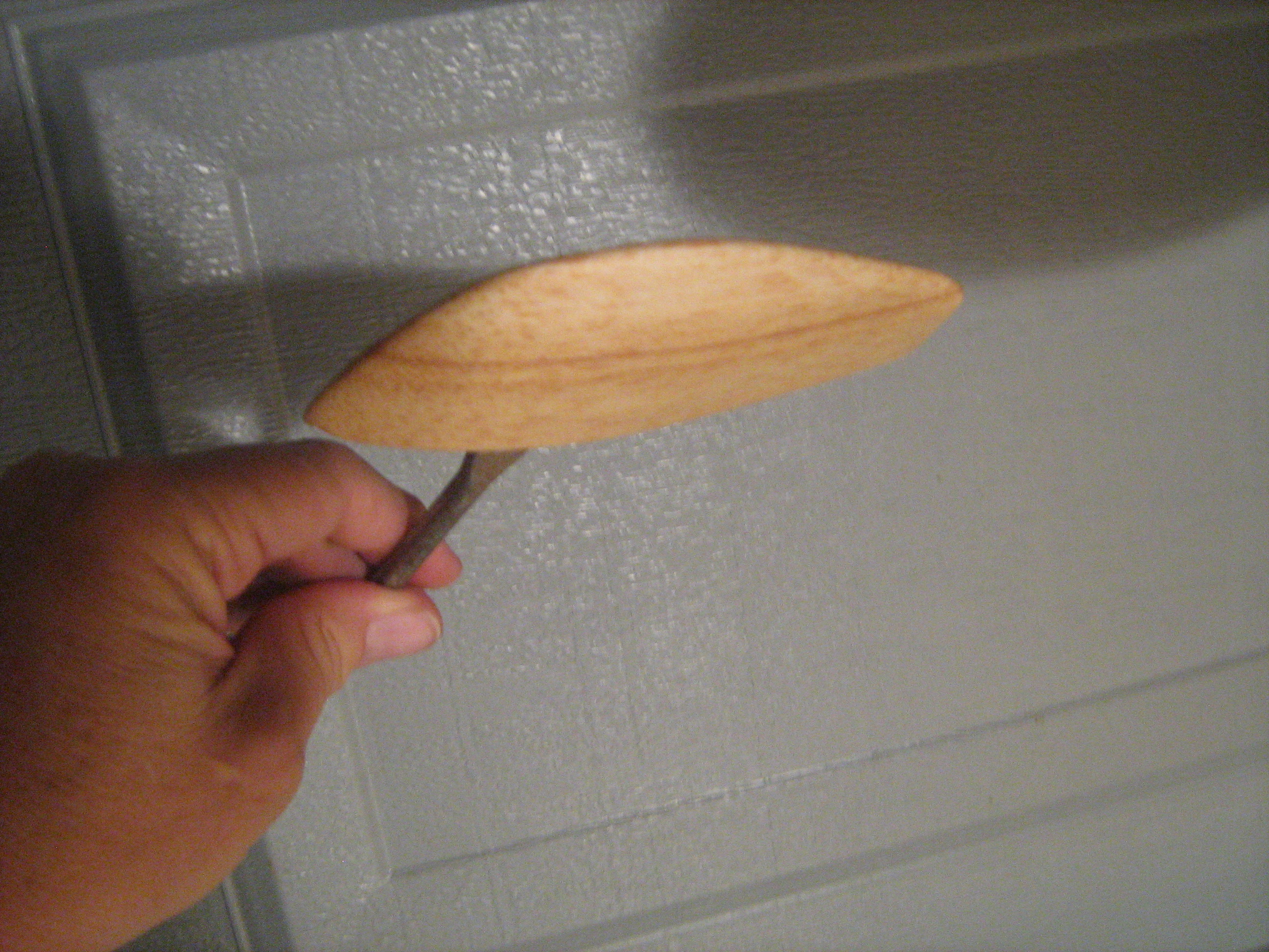

I did get a bit of time in building. I am working on two at the same time. The RM bi-plane and the GL T2A.
The wing tips I had made I sanded to deep and went through in several spots. Big holes too.
So I made a new tip. Not hollow! I am going to use it as a plug to make a PoP (Plaster of Paris) female mold. Then I will make four identical (that was the other problem) fiber glass tips.
I am coating the tip with epoxy and sanding that down. I quess I should then hit it with some self etching primer and paint. I have read that hair spray works as good or better than PVA release for making the PoP mold. I have a test piece I will experiment on.

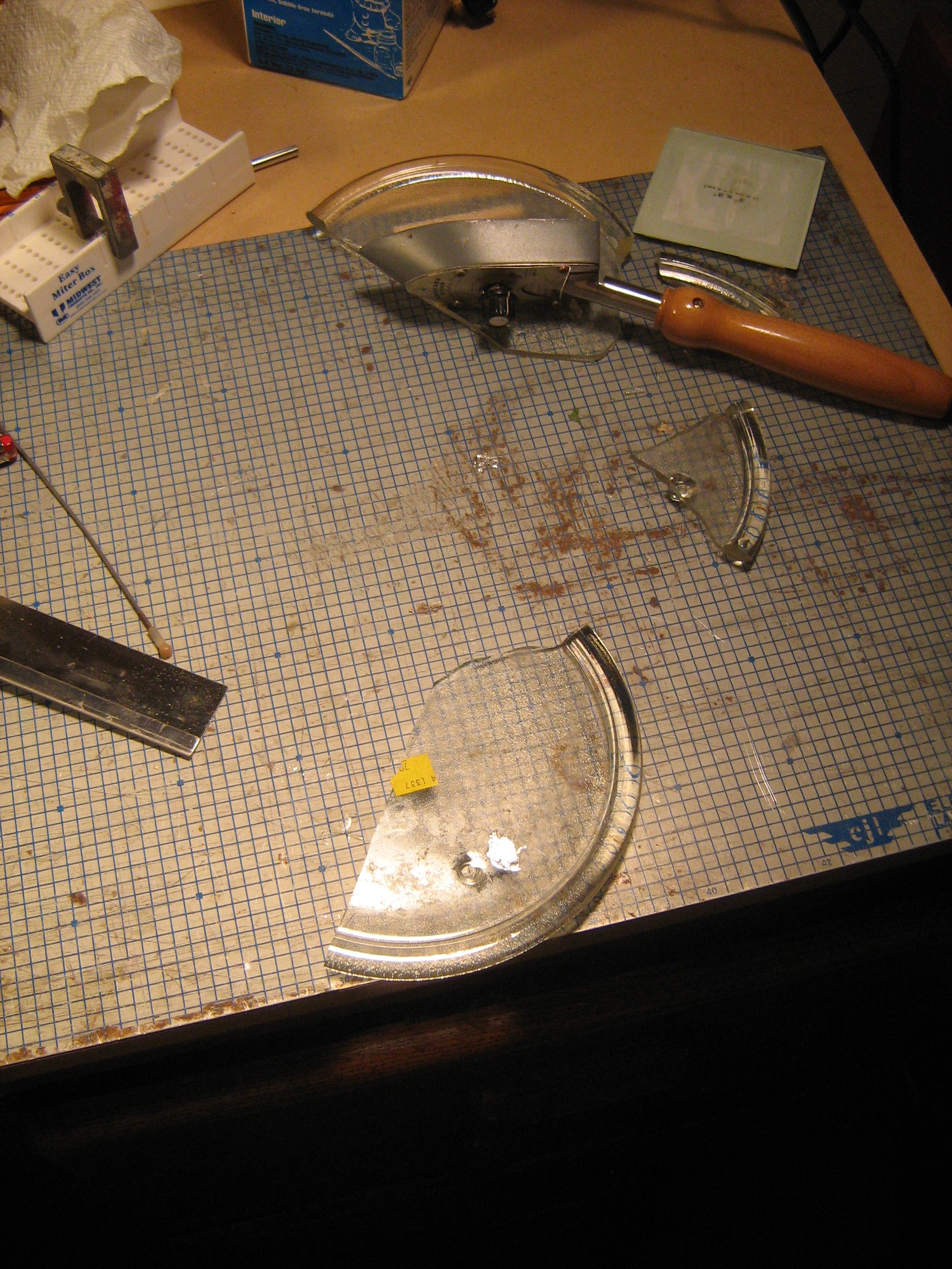

And I was using my covering iron (but not for covering). Had it sitting on the plate I use for hot things while doing the gussets. Then POP! real loud right next to me. I jumped about a foot. Followed by a what the h*ll was that. Looked over to were the iron was and that plate had shattered. You can see in the pic how far pieces went on their on. My ear is still ringing a hour later. The plate was glass. I will have to find a piece of ceramic.
Thinking about it some more even ceramic is a bad choice. Uneven heating will cause that to shatter also. Shattered a $60 Lasagna pan that way. A wire trivet is what I need to get my mitts on.
Ken
