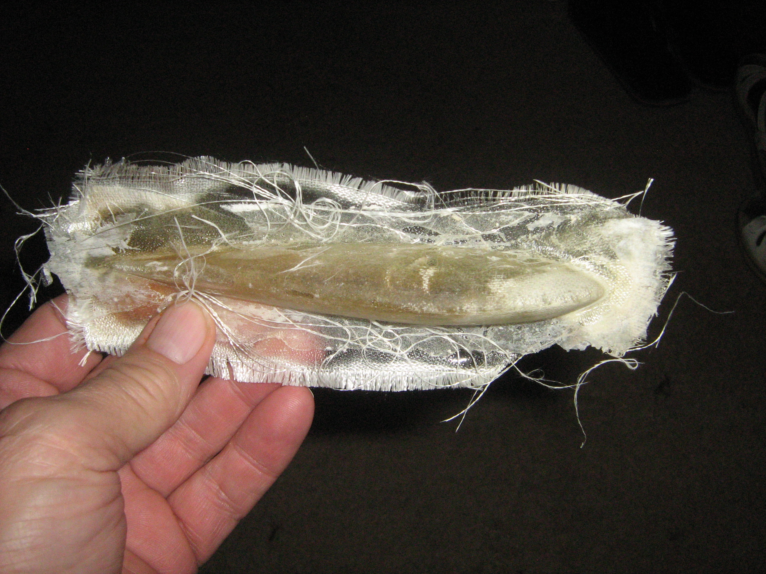

#161
Yesterday I prepared a new test. better waxing of the mold, better laying of the cloth. more cloth.
Then I was liberal with the resin and tried to work it in to the cloth better.
So today I pulled the part out of the mold.
Bye bye mold, it cracked and chunks came off of it. It was just a test mold any way.
The glass part came out with a lot of resistance, and ruined the mold.
So raw unpainted PoP ain't going to work!
The glass tip is terrible. Even though I tried to lay the cloth in better and more of it. It was real difficult to position in the depth of the mold. And this is a much more shallow mold than the real tip mold.
I am going to have to change tactics. But at least I leaned what not to do.
I got three choices I think.
#1 give up on glass wing tips and make 3 more wooden tips............Not happening (at least not yet). This was supposed to be a learning experience to enable me to make parts for other planes.
#2 make another PoP mold and paint it to seal it. then because there is 0 chance I can manipulate the cloth in as deep and narrow a mold as the real tip mold will be, I can pour the PoP mold full of silicon to make a male mold that I can the lay my cloth up on the outside, and wet the cloth out real good. After wich I can then press the the male silicon mold and cloth / resin into the female PoP mold. Not rea sure such a complex thing is with in my abilities.
#3 Use the wooden plug as a male mold. Just lay up class on it, After making sure I can get good release of the glass tips. Paint the male wooden mold and wax the snot out of it.
Any way here are a couple of pics of the real poor glass tips..
Ken

The wing tips, all four of 'em are final shaped.
And yes I remembered my dust mask this time sanding.
Now to the lead outs, and leadout guide. The guide will be adjustable back and forth, and also up and down. Aod at least that is what I am planning. When I get into the nitty gritty we will see how much of that I can accomplish.
Computer cam shot of the tips
Ken
Ken

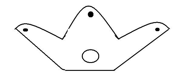

#171
2nd issue. The lead out terminations at the bell crank are hitting the fuse. Cant move or revers the bc. I can make shorter terminations but they will still hit. I may just make the holes bigger,that is the simplest. That coupled with some sort of guides
Ken
Ken
HOWEVER, is your aim is to get your movement & control maximized AND keep your appearance as clean as possible, you're going to need to re-design your belcrank so it doesn't hit the sides anymore. It might look something like this:
Forgive the crudity of the drawing - took about 3 minutes using MS Paint, but I think you get the idea. I had to do this same thing many years ago when I was building my Skylarks. The belcranks kept beating up the first rib inside the wings and they'd eventually jam when the slot they were creating got big enough. I just built my own belcranks (thus keeping the near 90 degree elevator deflection that I like with the Skylark) and went with that. Only thing you have to do with a design like this is to make sure you bend the crank up a bit on the "up" side so the rod to the elevators doesn't get hung up on it when you deflect for down elevator.
Of course, you're making the belcrank out of carbon sheet which probably doesn't bend real well, so you'll have to cant the whole mount a few degrees instead, which will give you a "low" leadout and a "high" leadout, but I don't think that's really much of an issue either.
Just some ideas.
