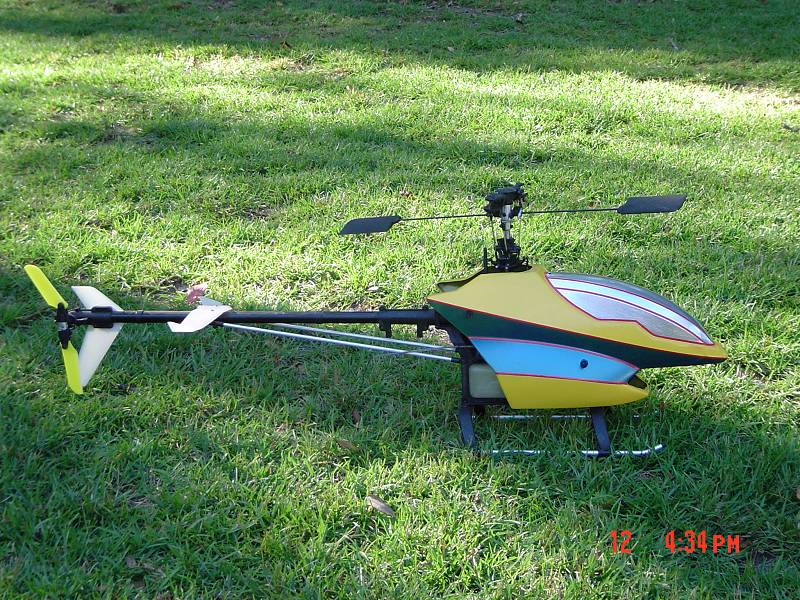

She ain't black no mo
Wonder if nitro fuel is gonna mess this up

If it's lacquer, it should be OK. If it's enamel, it won't stand up to fuel..

The yellow is commercial grade, the blue is auto paint. The chrome is Home Depot krylon. So basicly what you're saying is let it cure a couple days and then hit it with laquer clearcoat.

If you put lacquer over enamel, it may crack the enamel. Unless you're going for the mosaic look (doubtful), you'll want to take it easy. If you're going to try a clear lacquer, yes, do wait for a couple days. Then, put on a very light coat. You want it to almost go on dry. Do several coats this way, and don't get the old paint too wet or it will still crack. This is the way I've done it in the past. The times I've been patient, it's worked. The other times, it didn't.
You might want to check with your local hobby shop to see if they can recommend another way or a new product.

Gary, I use laquer on practically everything I make, however, it's hard to get mahogany thin enough for a canopy I rarely use paint, always stain. I'll put about three "misted" coats on if not more.

That looks alot better,when is the
maiden flight??? Tooo Windy here.
