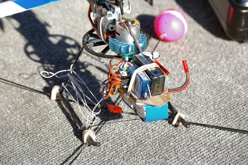

I'm flying an Eflite CP 4-in-1 in my Walkera Dragonfly 4, using a Hitec Flash 5 transmitter. (it doesn't need CCPM)
I needed the positive Expo to overcome the sluggish response of the heli.
Any aftermarket transmitter will need 120 degree CCPM mixing, as wall as the proper shift.. negative, for the Eflite receiver.
I'm using a Berg 7-channel receiver in my Blade CP, with the Eflite transmitter.

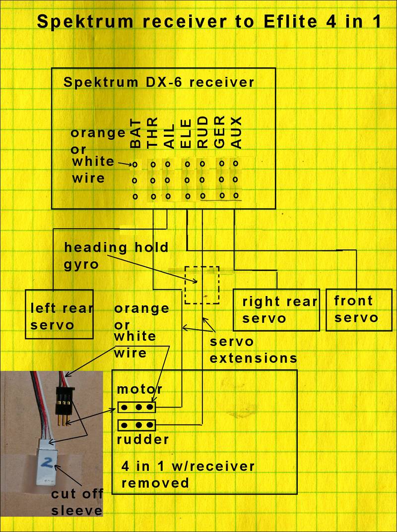

Ghaws--in order to use JR equipment you'll have to replace the receiver half of the 4-in-1 with a positive shift. The stock Rx is compatable with Futaba and Hitec.

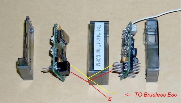

Hey, anyone here interested in how to mod the HeliDirect CNC center hub to work with the CP? It is definitely worth the effort (I speak from experience). No slop, no sticky collective and seems to be fairly crash resistant. Not to mention you dont need any shims added to the spindle to tighten it up. Very solid.
One thing tho...I did find a fix to the problem of loose tolerances when mounting it to the main shaft. A friend of mine also had problems when installing his MH beauuuutiful CNC BH Head.
Simply place a drop of MEDIUM (or low strength if you can find it) loctite in the shaft hole in the head (if the hole is bored through into the spindle shaft opening just use a piece of heat shrink tubing or whatever stuffed in there to keep the loctite from gumming up the works) and mount the head on the shaft WHILE HOLDING HELI UPSIDE DOWN!! This keeps the excess loctite from running down into the swash. Just clean up the stuff that runs out with a paper towel or whatever. True up the head as much as possible and set the heli somewhere upside down over night for the loctite to cure. This really works! The loctite serves to take up the slack in tolerances and if you need to remove the head after 'custom bending' a mainshaft just pop off the grips and slide a screwdriver or similar through the spindle hole and twist the main gear and head in oppossite directions after loosening the grub screws. The cured loctite seems to crumble and, for the most part, clean itself out. I have already had to change a few mainshafts and I havn't had any probs. Yet...He he.
Just make sure you dont use anything stronger than medium grade. My friend used the high strength and wound up having to cut the shaft to get a new one in. Oh yeah, he never did get the shaft out of the Micro Heli head and gave it to me!!!! Needless to say I was laughing all the way to the heat gun lol!!! Can't beat free shiny blue parts!!!

Not the best quality pic but you get the idea...
The receiver pic is for the last post question. Gives you an idea how it looks and how to mod for an ESC. Found it on here somewheres I think but cant remember exactly where. Credit goes to the original poster of course.

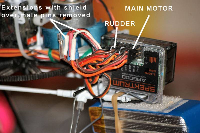

What kind of Rx can I get that will be small enough to replace the origional in the 4-in-1? I need it to be positive shift so it can work with my JR7202 Controller.

So something like that will actuialy allow you to change the reciever inside the 4-in-1 unit of the blade cp? Will it then work with my JR 7202 no problem? Also, is it possible to do the change on the Blade CX? What about the CX2 could you take the DSM reciever out and put in a Micro FM or PCM reciever so I could use my JR controller? I like some of those heli's but honestly I hate having a million controllers... thats why i got the JR7202!

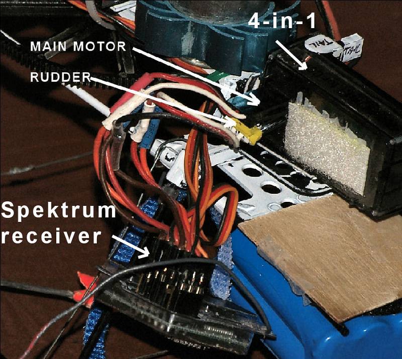

I honestly am getting ready to do the swap. I have an older jrxp652 and thats why I picked up the gws receiver. The receiver in the 4in1 is removeable and the pins you see plugging into the gyro and esc are the throttle and rudder channels. Its just a plain ol 6ch receiver they mated up to the esc. In the 3in1 they have made them easily seperable.
One note..If you want to use an aftermarket esc of some sort all you need to do is tap into the throttle channel of the receiver while still allowing the receiver to plug into the gyro esc and y into the power for the seperate esc. Very simple if you are handy with a soldering iron, potentially very bad if you aren't. Be sure to tap only into the signal and ground of the receiver if your separate esc has an bec cirquit. the receiver will still get its power from the original gyro and esc.

Ok so i would need to get a new esc in order to put the dx6 reciever in it, or just 2 servo extensions? Or how do it get it to "plug" into the 3 in 1? Yes i agree the dx7 is way way way better! But i just got my dx6 bout 3 months ago before horizon made any announcements of the dx7 so im stuck with it or i can plunk down 350 bucks? No way id rather use that on a trex which i am planning to lol. Sucks that the new small reciever will only work with the dx7, what kinda of rip off is that, oh well, as everyone says this is an expensive hobby.
