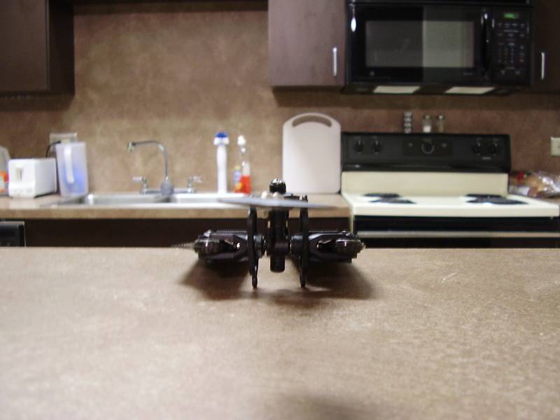

Hi there I am new and have had my Blade for a week now and I love it. I do have one question though, I saw a bulletin saying to make sure you cut the throttle before it crashes or else it will mess up the 4 in 1. I was wondering if a symptom of this would be a wobbling main rotor. When I run up the throttle you can see the see the blades wobble as if I was making slow circles with the cyclic control. It makes it super unstable and non flyable, I was wondering if it was the 4 in 1 because I was wondering if it was just lagging in it's compensation. If any of you are airplane pilots it looks like pilot induced oscillations. I was planning on buying a new 4 in 1 or two, but would like some verification before I spend $70 a pop on them. Thanks for any help you can give!

You probably just have a bent main rotor. You could also have out-of-balance blades or flybar. Your 4-in-1 would not cause a wobbly main rotor. Remove the blades and carefully run the main rotor while holding on to the landing gear (watch your hands). It is fairly easy to see if the rotor is bent this way. The shaft and gear are cheap (around $5.00). The reason you want to cut power as soon as possible when crashed is that you will be putting way too much stress on the electronics in the ESC (and could also be putting way too much current through the brushes on your motor(s)). A 4-in-1 failure due to a stalled motor would probalby result in total loss of rotor power (tail or main).

Do you mean that the wobble is slow circles at lower throttle or whole rotor disk does circles as though your were moving right stick in slow circles? After numerous "pilot induced" crashes, I've yet to have 4-1 problems. I usually have the stick and trim off immediatly. I have bent the shaft once though and it does make it nearly unflyable. I just ran it up enough to determine the direction of the bend and progressively bent it in the opposite direction till there was no dicernable wobble. I did not disasseble it for this repair. Just held the main gear firmly. Good luck.

Do you mean that the .....................................whole rotor disk does circles as though your were moving right stick in slow circles?
smercernary,
That's exactly what is happening, I pulled it all apart and the main shaft looks fine. Although I was looking at the spindle and the main blade grips assembly and it looks like it is a little bent, but it looks symmetrical so is it supposed to be that way or should the blade grips be in line with each other? I really appreciate all the help you guys are giving me.

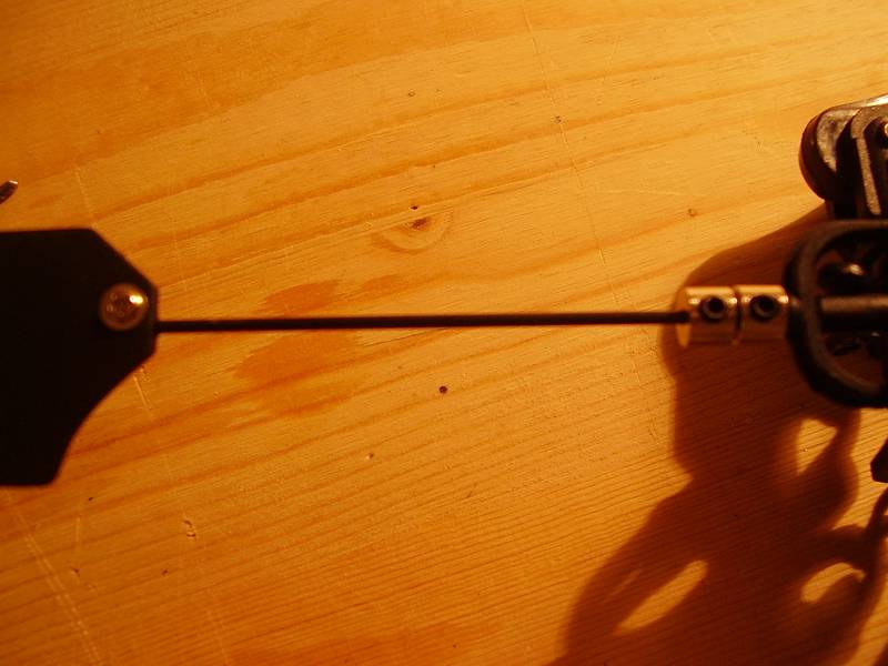

did someone mention that adding a second o ring on both sides of the spindle increased responsiveness? I put them on but when I tighten the end cap screws it squishes them and binds the grips. I can't really see how they can help when they are just out there floating on the spindle. Or am I supposed to countersink the rotor hub some more?

The blade grips should be in-line with each other. If your spindle is bent, I can only imagine what grief that must be causing. Especially if it were to rotate within the head as the head were rotating.

Haven't seen anything myself about adding another o-ring. And I would think that the only way to make the o-ring equiped head tighter would be to compress the rubber making it bind as you mentioned. JMO but I would think replacing the o-rings with bearings would be the only real way to make the head more rigid. I'd be interested to hear how it goes if you try it..

remove the two orings and replace them with two 180 gearbox bearings (perfect fit ). then remove the two inner washers and reasemble i did it to mine and well it gets a little bit better response and lift is more responsive if you do not remove two wahsers one side or the other will bind

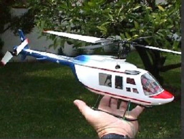

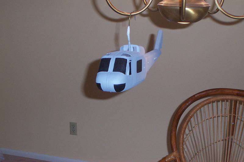

Here's a question for anyone, I want to get a cool looking fuselage for my blade. I've found this website that sells them for micro heli's. It states will fit a piccolo. I was wondering what is the size in relationship to the blade CP. Here's a photo of it.

My guess is that it doesn't fit the Blade exactly. I just got a Huey a couple of days ago and have been cutting it to fit my Blade. I talked to the guy at the (online) store that I bought from and he said that it would fit the micro heli's with some modifications. I had to cut the top so the servo arms would fit and the swash plate could turn. I also had to cut so the struts would come through the plastic. It took a couple of hours to get it all right. I just painted it today and am looking for a couple of ideas to spice it up a little....however, still keeping the miltary theme!
Brian
