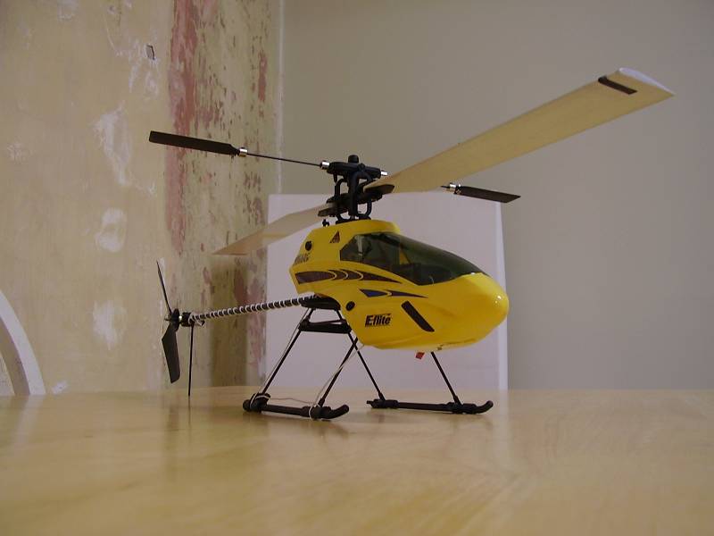

Just thought I'd share with you my new toy. I got this thing on Monday, got it to hover on Tuesday, flew all over the apartment on Wednesday morning. And yes I've never flown a heli before, I do admit that it's different than flying an airplane but it does help to have that basic knowledge of flight when going into heli's. I Brought it to work to show my buddies and they were amazed that I got it to hover for more than 30sec and only having it for only one day. I'm not bragging here, I'm just telling this because I'm amazed at how fast I picked this up. I did spend alot ( I mean a lot ) of time setting the heli up to get it to fly almost hands off for 2-3 secs in hover mode. I also did alot of reading on how to train myself on learning to fly a heli. I hope this inspires others that it can be done in less than a few weeks or months. I'm still a novice at it but I'm getting better and better, soon I hope to start flying nose-in. Usually I keep the tail at me and any time it gets going sideways from me I get disoriented. SO I'm still not mastered the 360 flight yet. Just tail in for now.

Congrats on you purchase of the BCP and you killer skilz. It took me a little longer to get the hang of it since I had no prior RC flight experience and no one in my area (that I know of) that could teach me. Everything I have learned came from these wonderful forums and trial and error. (lots of errors..LOL). But anyway I noticed in your pic that you have your ant. wrapped around the CF tail boom. Have you had any glitching problems? When I first bought my BCP I did the same thing and all of a sudden I started having the glitching problems in flight. It was more noticeable at about 5 ft. away and further. It got a little scary at times. Anyway, I started looking around the forums for similar problems and found out the the glitching was being caused from the ant. being wrapped around the boom. Some thing I did not realize was that the Carbon Fiber causes interference problems and therefore causing the glitching. I moved my ant. off of the boom and everything worked fine again. There was no more glitching. If you were having any problems or start having this problem then I hope this helps and saves you troubleshooting time. The less time fixing problems means more time in the air!!! Anyway, great job on the quick advancement and hope all goes well. These lil Heli’s ROCK!!!

Good point... I have been hovering it really close to me so that I can maintain orientaion. I have not had it more than 10-15 ft away from me. I haven't experienced any glitching at close range but I'll wrap it back around the landing skids so I don't say, ( I wish I would have unwraped it from the boom.)
