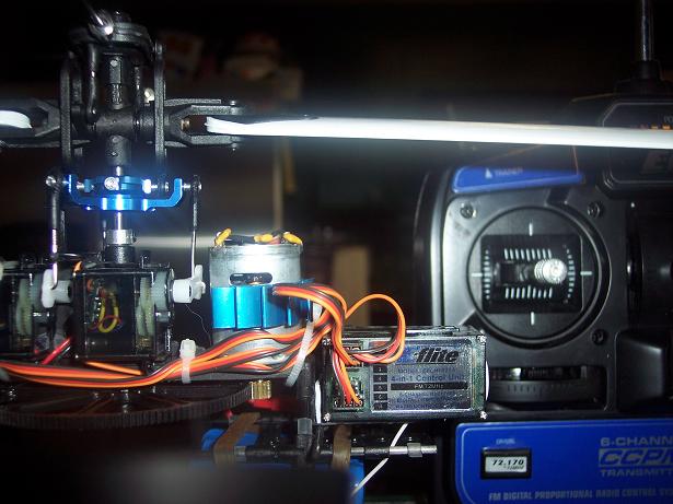

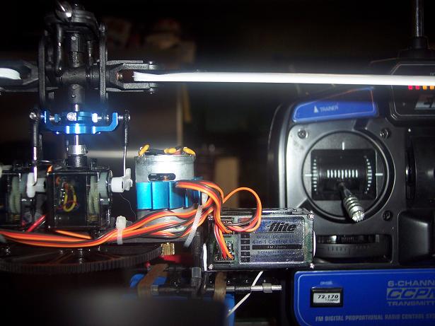

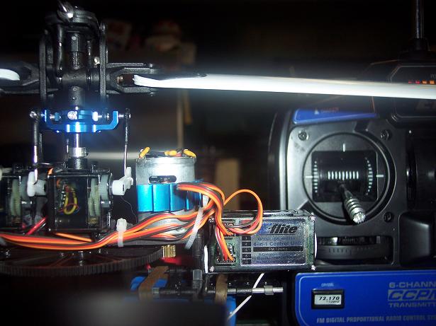

Well i adjusted the servo throws on the swashplate one full turn to achive the proper distance 7/16th to comp for the thicker cnc alum swashplate. Now when the head is resting in the idle throtle all down stick the blades are at a serious - blade angle. I tried it anyways and the copter didnt even attempt to more off the ground. Should i adjust the angle of the blades as well a full turn also ? I am seriously lost here and ready to put back the stock swash if it wasnt for how dang smooth the copter is now with the new swash.

You have too much pitch.......You'll either need a pitch gauge to set it up right OR play around with the pitch (eyeball) until it looks like where it should be. I'm waiting on my pitch gauge and have only adjusted mine by sound and feel which I HATE doing. Here's what I do, unplug the main motor then power everything up and switch to idle-up, move the collective to 1/2 position and look at the blade pitch from the side. I then set the blade pitch by adjusting the linkage until it looks like zero pitch. Once you get that far move the collective all the way up and you should get +8 to +10 pitch, now move the collective all the way down and you should get -8 to -10 pitch. If you're in that range the heli should fly. Last thing to do is switch back to normal mode and move the stick all the way down. The pitch should look close to zero pitch, as you slowly raise the collective the pitch should increase to somewhere around +10.
Once the bird is hovering you can get a feel/sound of the heli by watching and listening. From there you can either slightly add/remove pitch by increasing/decreasing the pitch links until the desired head speed is reached.

With the TX in normal mode, are the rotors at zero pitch with the throttle all the way down. Make sure the trim is down, too. You really don't need a pitch gauge on a micro. The tracking is key. Hold a piece of paper on the bottom edge of the blade and site to the flybar rod. If you have the sym or CF blades, you align by the center axis. Using the stock radio; when you raise the throttle (unplug the motors first) you can't really exceed 10 degrees, it's preprogrammed. Using a replacement TX it is possible to extend pitch beyond 10.
I made a pitch gauge from a cheap angle protractor from harbour freight. Got the idea from bladecprepair.com. It works pretty well but isn't really necessary as long as my tracking matches.
One more thing. Are you setting tracking at max throttle. Clamp a small board across the LG to a table and you can turn up the rotors and not worry. That's how I set mine and have had no trouble. Keep in mind though that if your main shaft is even slightly bent, it will vibrate a bit when clamped down. If it vibrates a lot, you may need to replace the shaft or spindle.
Just trying to hit everything I can think of off the top of my head.

I will try to adjust the pitch on the blades and check it out . I know my LHS has a micro pitch guage , might see about picking it up. Off I go !

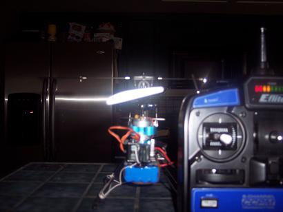

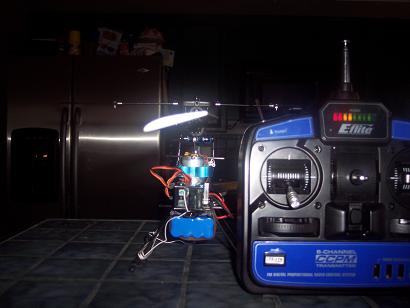

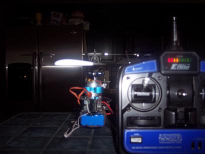

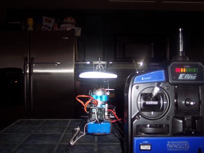

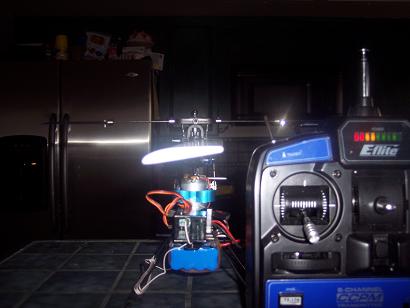

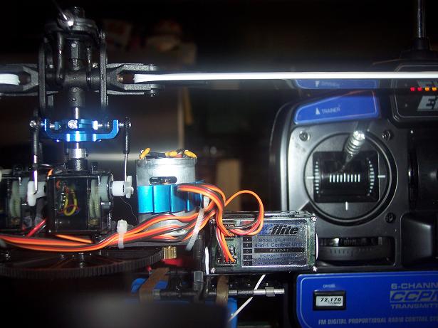

Ok figured looking at pics will help the situation as well
Ok i took the head back off and comfirmed in the idle up mode / power off the swashplate is sitting at exactly 7/16 from the top of the swash to the top of the drive shaft and the plate is 100' level. I also confirmed all 4 of the pitch mounts are the same lenght.
20 ,21,22 are in normal mode ( The first 3)
23 and 24 are in idle up mode ( last 2 )

You need MORE pitch then........Pic1 shows full collective, meaning that the blades should be at +10. I don't see one of your pics that have positive pitch......that's your problem.
If you were to fire up the heli right now the force of the blades are PUSHING the heli down which is good for inverted flight

avalanche wolf,
Post more photos of linkage detail. There should be lots more travel in the idle-up mode from stick down to stick up - these 2 photos show a lot less than I have seen before (there should be 20 degrees difference). How do you have the switches set on the front of the tx?

next 3 are in normal mode
If this is not what you ment tell me where to point the camera and will be happy to take more pics.
