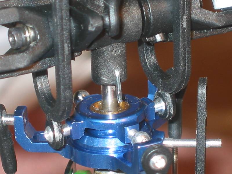

For what it's worth, I've been using paper clips on the plastic heads for several months, also, I have the 7.5 amp fuse on the main motor. Between the two, one backing up the other, I think it would be extremely difficult to fry a 4n1. Also, with the paper clip trick, I've never busted a main rotor or blade grips either, the paper clip snaps and saves it all. You may have seen my earlier post with picture of a pair of busted carbon fiber blade, paper clip snapped and nothing else damaged.
Dave / Choppersrule

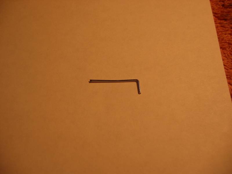

Pictures worth a bunch of words. Get paper clip, the small one. Straighten out, make it about an 1 1/2 long, easier to handle, trim later.
Use needle nose plies and make a 90 degree bend, of about 1/4 inch. Looks like an "L". Snip the long end at about a 45 degee angle, riight at the end of it. This makes it easier to put it throught the rotor and shaft. Push through assembly, hold on side with bend. Take pliers and bend down other side. Cut to length, about 1/4 inch on each side. There will be a tad bit more play. IE: hold the main gear and move the rotor, it will move more than with a shear pin, however, I've been doing this for months and has never caused a problem, it saves parts.

ORIGINAL: robmoney
choppersrule
So do you just cut a straight piece and use it like the shear pin or do you cut it longer and wrap it a bit around the hub?
choppersrule

Bigger paper clip, I don't think it would defeat the purpose at all. The paper clips are made of much softer metal than the Stock pins. I think this is why it works so well. Just like a chain, only as strong as it's weakest link. IMO, that's were I want it weak.
Dave / Choppersrule
