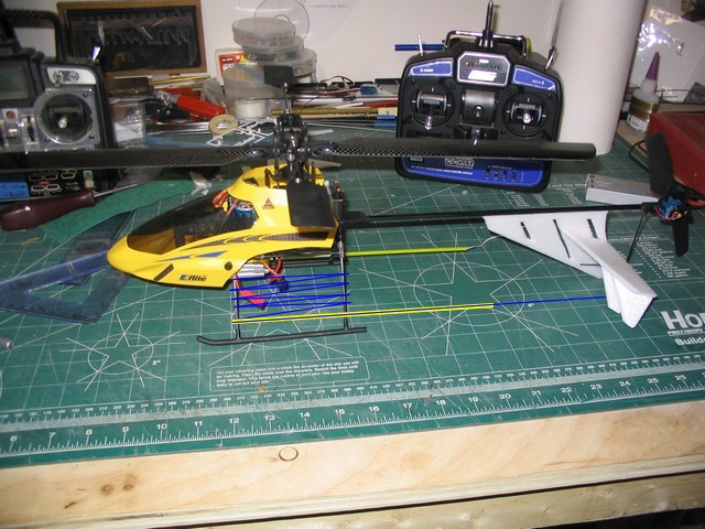

Hey wnuk, how do you have the antenna routed? I put mine right out of the 4-1 to the skids and then back and forth until I have about 12-14 inches left and then run it trough a plastic tube strapped by pieces of rubber bands to the skids. I had MAJOR glitches before I did this and after none. As you said it was like it went to negative pitch.
I didn't have any pics of my ant route but I drew it in blue as it would be on the opposite side. Blue is the antenna, yellow is the plastic push rod I used. I had a ton of glitches before I did this, now it will suddenly drop on very rare occasions.

Nope, never routed my antenna. Just left it the way it came stock. I had no glitches with it till this point (CNC tail holder). It's worth a shot though. Think tomorrow I'll test it out with seperate motors on the CNC holder (thanks again choppers!) and see what happens.

a couple things that could make them run at different speeds... the lead wire is too long to the second motor. The two lead wires are of different lengths or resistances, a little but will probably be fine, but alot is not good (see note at the end). One motor is more broken in, one motor is more worn than the other motor or close to failing.
If it is an RFI type deal, make sure that the caps are connected to the negative pole of the motor and then grounded to the outside of the case and there is continuity between all the grounding points without the negative wire lead.
Just a couple of other things, I didn't need any insulation between the CF rod and the alum tail holder, you may want to check your tail motor wire for shorts along it, like closer to where the cnc mounts because it could short to the cnc and it wouldn't short to the plastic.
If you have a way to take some pics of your setup that might help trouble shoot it a bit.
note: I tried just for an experiement to run the dual tail with only the positive wire connected because the cases are grounded together and connected through the rf cap. This was enough difference in resistance to make the motors run at a pretty significant speed difference.

Update on the Dual Tail: I think I have isolated my problem down to a bad tail motor. I mounted both my motors but just wired the top one up. Hovered for 6 minutes without a glitch. Then I disconnected the top motor and wired the bottom motor only. After about 4 minutes, the glitches came rolling in. Just to be sure, I disconnected the bottom motor and went back to the top and had no glitches. I will likely pickup 2 motors tomorrow at the LHS and test again.

Glad to hear you have the dual tail glitch problem isolated. These tiny tail motor can cause you havov sometimes, I always have a few spares. Remember, you can get them at BPhobbies for like $6.37. I usually order 4 of them and a bunch of other spare parts to offset the shipping charges. Usually, 3 to 4 working days to get your order.
Dave / Choppersrule
