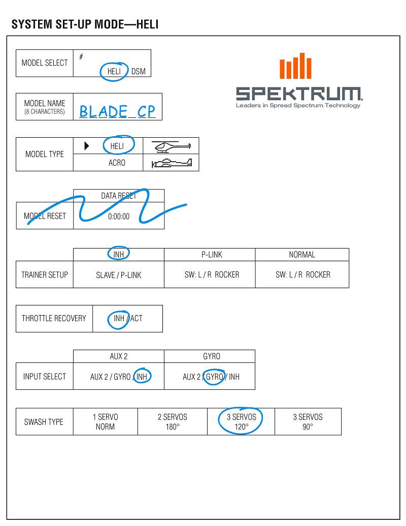

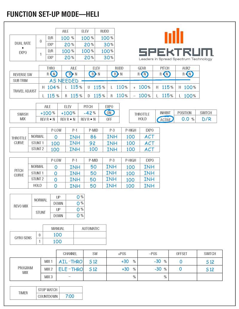

here's some great info I found online regarding the DX7 and Blade CP from John Adams
original link: http://www.horizonhobby.com/Articles...ArticleID=1688

jer: RICK here ; I am VERY interested in the DX7 prog. Is there a secret key to READ what you offered ? I can get to the page itself BUT when I click to open the text w NOTHING opens up !

lookyj,
Thank You,
I've been waiting for him to post that info for about two months. It was originally referred to in RC HELI magazine. I even called Horizon about it! lol Their response was, "Well he's a busy man".
Did you just find it?
Edit: Upon further looking, I see that it was just posted on 6/19/07. I think he really did everyone a disservice by even posting those setting. In the magazine article you will find that he has a lot of modifications that would change those settings compared to another heli. He has changed the blade grips to leading edge input. He is using the 3n1 in combination with the G90 gyro. He has shortened the tail boom.
IMHO, settings thrown out like this, out of context, are good for (possibly) a point of comparison only. The best way I've found is to use a guide such as Finless' video for the TRex:
http://www.helifreak.com/viewtopic.p...8466bcd6040067
so that one understands how the settings are actually affecting the helicopter.
Again, just MHO.

Go down to the video link. It's "OK", but could be more thorough, IMHO.
orlbuzz
Sorry to double post here, but I was wondering if you have Adobe Acrobatic Reader installed? On that page, there is a link where you can download it. Also, have you seen Jermo's video on the DX7?

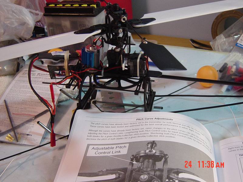

NEWS : I am STILL not able to figure out how to do the PITCH corrections. I look at the Heli and cannot follow all the VERY CLEAR INSTRUCTIONS y'all have provided. I must be SENILE ALREADY, and not knowing it.....sheesh So the PRO and the Blade just sit on the bench.......can't figure out how to fix them.....will eventually resort to the LHS for help.
I am also INSTALLING de FS-1 complete with the wireless control.
A HONEYBEE KING II - is on the way........$146 is NOTHING, for what I get........hopefully I have FOLLOWED my Bros. and some good will come from that.
I was SO READY to move out in FF and spin, return with nose in hover, etc etc Still got the CX-2 and that's my faithful toy - STILL ORIGINAL from the box !
When I come back I WILL DO THE DX-7 INSTALLATION IN THE BLADE......the set-up post is a KEEPER.
