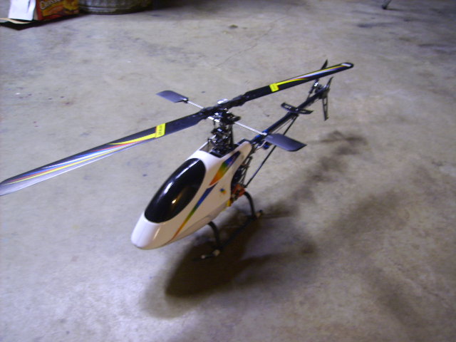

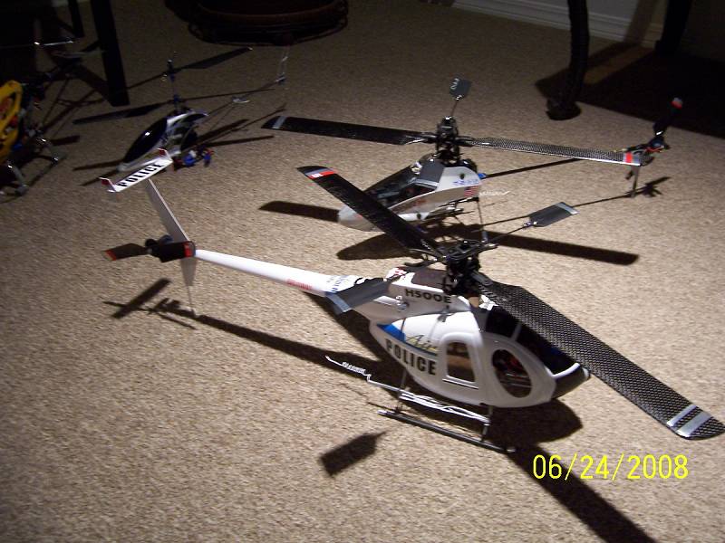

Hey guys.......EXI-450 (plastic version....$99 before ship) review:
I just finished building it last night and did a test hover in the basement today.
*motor...Danlion 3500KV
*ESC....Dynam 30a
*Gyro....Telebee with drift and temp compensation circuitry
*servos...E-Sky std 8g (x4)
*battery "zippy" 2200mAh 20C
*Radio system DX7 with AR6100E RX
All the above are new out of the box/package
First impression....I thought the tail rotor gearbox was a bit "cheap looking" and I really questioned the way it clamps to the boom without a position locking lug and I thought that MIGHT be an issue. I did change the allen screw out on the clamp to a higher quality screw, it locks securely and position change is not an issue unless you crash or land pretty hard. I also thought the plastic in general was a little lacking in quality but hasen't offered to be a problem as yet. The horizontal and vertical stabs....replace them with T-Rex stabs ASAP or at the first opportunity...physically too small for a 400 heli. The flybar paddle....I recommend changing them to Align 8G paddles as well as installing Align stock skids.
The build:
It took a couple hours to assemble. They give you a lot of extra hardware and there is NO instructions I could find in the box, the extra hardware is useable, but confusing during the build, but it's a basic 400 sized heli....not a problem. Installing the servos was a bit of a PITA...pretty tight in there (LOL). I placed the gyro dead center under the main rotor mast and I had to invert it and it faces rearward, but it's fine. Routing all the wires was pretty straight forward, the ESC and RX are mounted to the frame on the (outside the frame) side rear panels (gonna put a scale fuse on it later). I like the battery tray provided...well placed and thought out. You have a choice to put the battery on the upper slant tray or in the lower flat tray...I chose the lower tray.
Set-up: Took some time, but it normally does. I'm still pending some minor mechanical trim changes to the rudder and ailerons to get this bird zeroed out. The pitch settings in the head...you really gotta go through that. The initial was about 6 or 7 deg down at full stick down on collective. I did of course have to raise the swash quite a bit mechanically.
Test flight:
Other than the trims being a little off mechanically, no probs. VERY powerful, stable, and predictable. I had to tone down the throws on the servos and the D/R because it's VERY responsive to input. In the right hands...this bird is capable of 3d pretty handily right out of the box. The stock blades did NOT need balanced and are 325mm. The test flight went VERY well, and it's gonna take some time to trim 'er out.
Overall opinion: A great value with a good degree of quality. Don't skimp on any of the electronics/motor. I equiped this bird with pretty good stuff that is known to be reliable. Worth the $99 plus ship? You betcha.

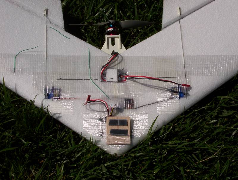

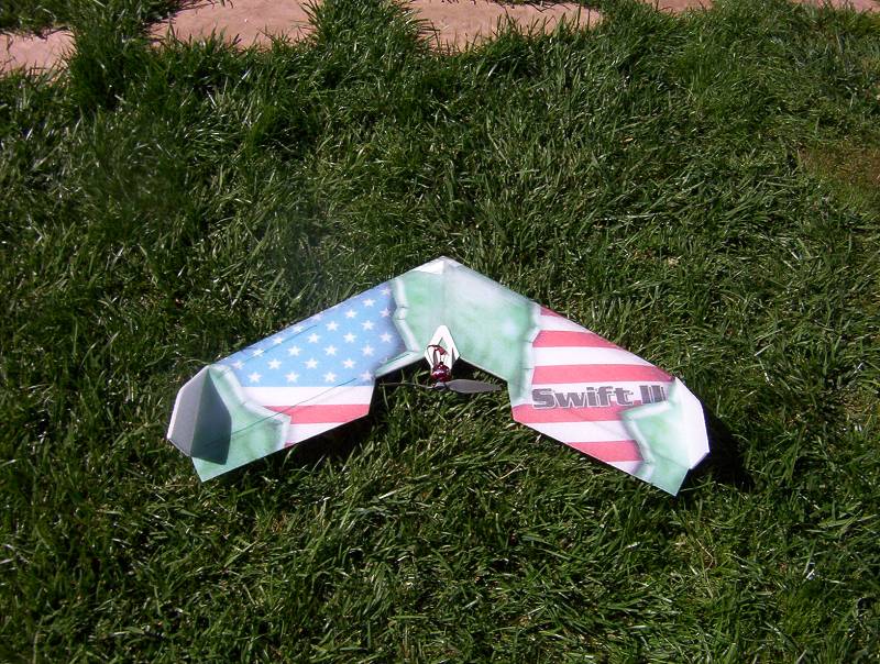

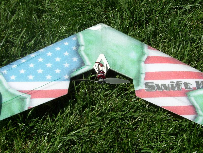

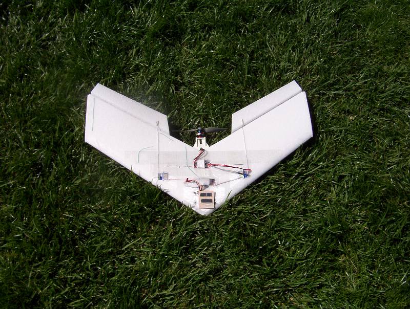

Here are nearly final pics of the swift wing. Once I get that finished the heli adjustments, then I will try to resurrect the bug. I have had the bug flying since early january and have over 600 flights on it, the number is attained by average # of flights/day over 8 months. Just thought I would share. I guess torn up Bug pic's should be taken. The damage is distressing
I am liking the JCS blades a lot. I feel more confident. The sym. blades lost the covering in grass[:-]. OK, off to finish the Wing.

Vic,
Hey, the EXI 450 looks pretty sweet. As you’ve said, “No plane or heli is RTFâ€
The horizontal stab does look a tad small, but unless you’re doing some super fast ff or heavy
3D, I don’t see it to be a problem. The vertical stab looks okay, I see it’s mounted to the tail box,
instead of on it’s own slider, like the HBK2s. Trex would be better, but I hold off till that one
breaks.
The 8g Align paddles will help, better stability and improves control on the cyclic side of the
house. For the price, it looks like you have a winner. And 100% Trex compatible, a big plus
there. With the motor, ESC, servos and DX7 system, that you’ve installed should good package
for ya.

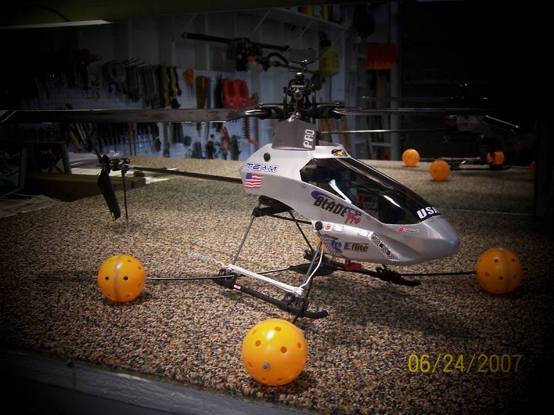

Jeff Michael,
Very creative, drilling holes in the ping pong balls. Maybe you can take over for me on the "TIP OF THE DAY" posts.
Haven't done that in awhile, guess the old brain is slowing down.

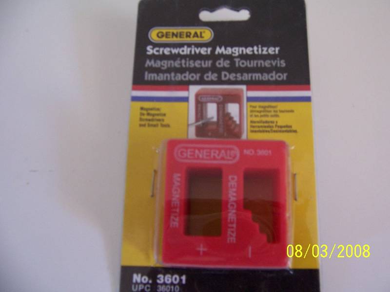

Lol...The tip of the day task was appointed to you. Remember ?! But take the night off and I'll throw one up 4 ya....
Home Depot $2.40... A "magnetizer". You put your screwdriver or whatever tool you want magnetized into the correct slot, run it through a few times and she's definately magnetized. It works much better than I thought it would. Those tiny little screws stay put like there super glued to the end of the driver...Lol.. I was even picking up drill bits with one of my small jewelers screwdrivers.
Works great for those hard to reach places !

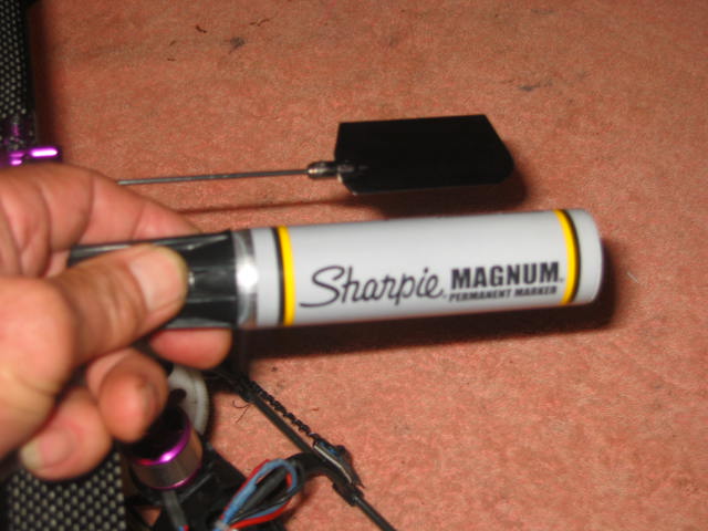

Jeff Michael,
Thanks for stepping in for me on the "Tip of the Day", however, I just thought of one too.
Bob's, if you don't like the color of your tail rotor blades (yellow or white) or your flybar paddles. Just get ya a Sharpie Magnum in black. Takes less than a minute.. See picture, forgot to take one of the "Before", only have the "After".
They were white.
Jeff, I use Earth Magnets to magnetize my tools, they are expensive. Hmmm, my son-in-law gave me some.
Another Freebie. [sm=wink_smile.gif][sm=wink_smile.gif]
