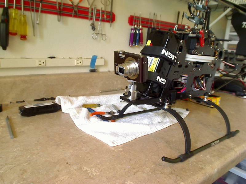

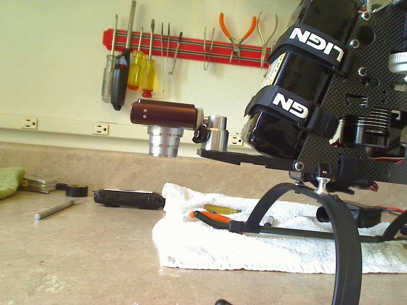

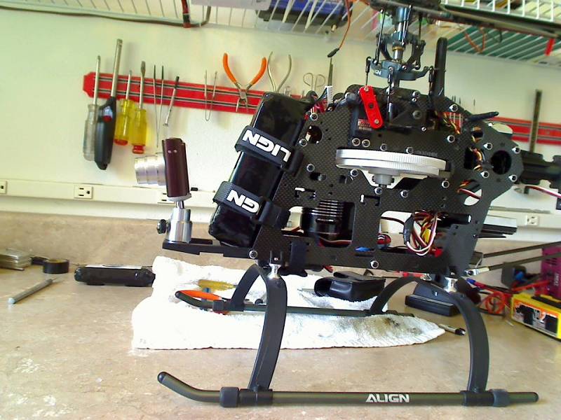

Hello Guys,
Well because I am board and cant really fly top stick right now Iplayed with my T REX 600 and a camera. You will see belowhow I mounted the camera but I think do to is extension the plastic batt try moves bit under torq. It also looks likesomething is just a bit out of balance, perhaps my blades as the camera gets pretty calm at higher rpms. While I am just playing I would prefer to see it under the heli so I can put on my canopy to make it easier to fly. Crap, a one armed, old, blind guy like me............well it was just tought to do at the Park this morning.
I loaded this video on VIMEO this morning and they have published the video but will not release it saying it is backed up in line. All day they have had a banner over the clip saying WHYdont you join Vimeo for $60.00 plus bucks to get first postings of the day, I say BITEME and with reluctance went to YT
YouTube and as always watch it in <span style="font-size: larger"><font size="5">HQ
</font><span style="font-size: x-small">http://www.youtube.com/watch?v=0bVOUYA828s</span>
JPEE</span>

JPEE ~
That was awesome ! I was waiting for you to get that 600 up with that cam.... I love your camera ! I was just looking at the Logo today, and was going to remount the camera way toward the front and under the canopy more. Hopefully this weekend I can try it out.
The saturation is nice and rich in your video. The Webbie lacks the color richness as others have said who have it also, but is clear if ya keep still....

JPEE...LMAO.....that was pretty cool. Must have a good set up...I didn't hardly notice jitters or anything.

JPEE,
Great video man, perfect![8D] I love how you mounted the camera on your 600.

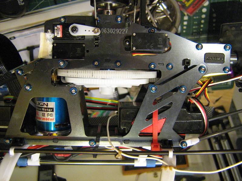

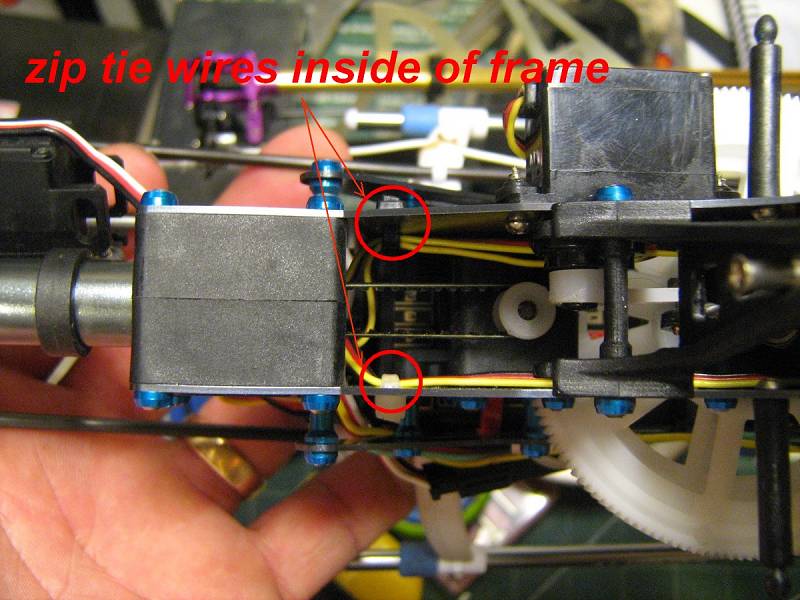

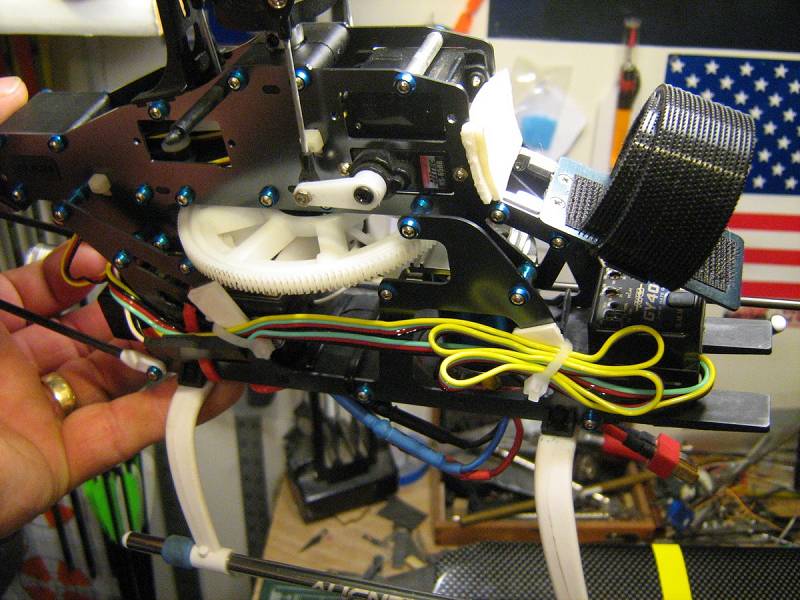

Kyle...Jay might have some routing suggestions/pics. I had to use a servo extension wire on one of the servos to reach the RX which I mount left rear external, and the gyro is on the gyro deck behind the anti rotation bracket....I have NOTHING inside the frame, the ESC is located externally on the right side rear panel. Havent had a camera since the wife roached mine.

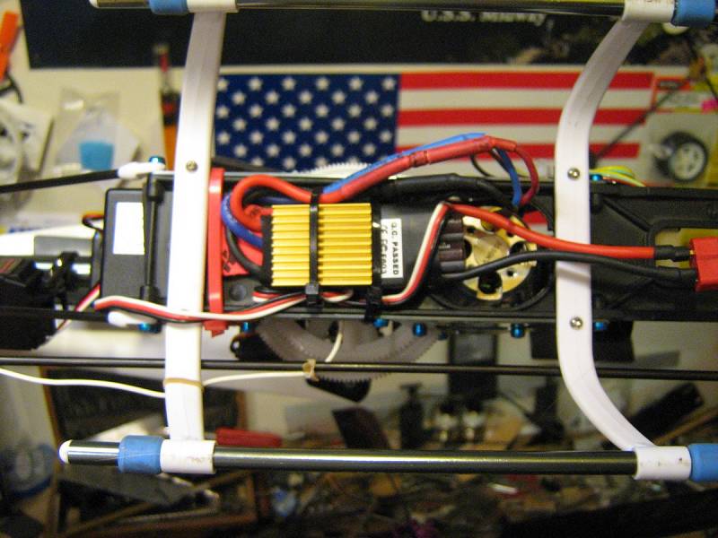

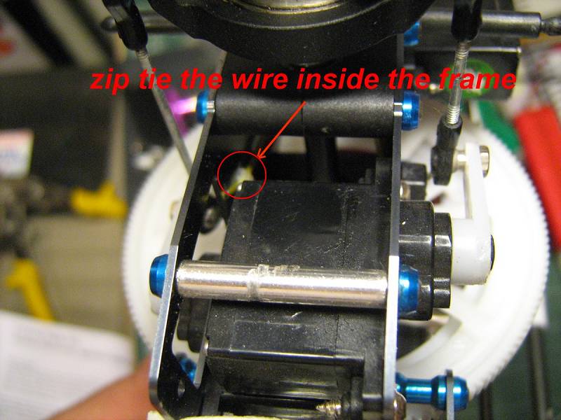

Kyle,
Here are some pics. These can give you a basic idea to go from. I hope it helps!
Blessings,
Jay

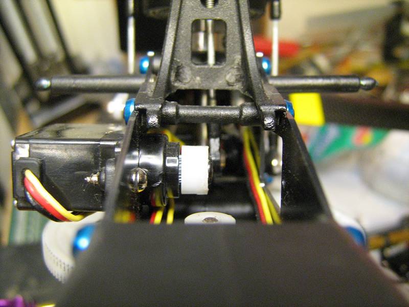

Kyle,
Here's a few more.
Blessings,
Jay

Thanks Jay that will help TONS!!!

Kyle,
I'm glad I could help although there's room for improvement on my wiring job.

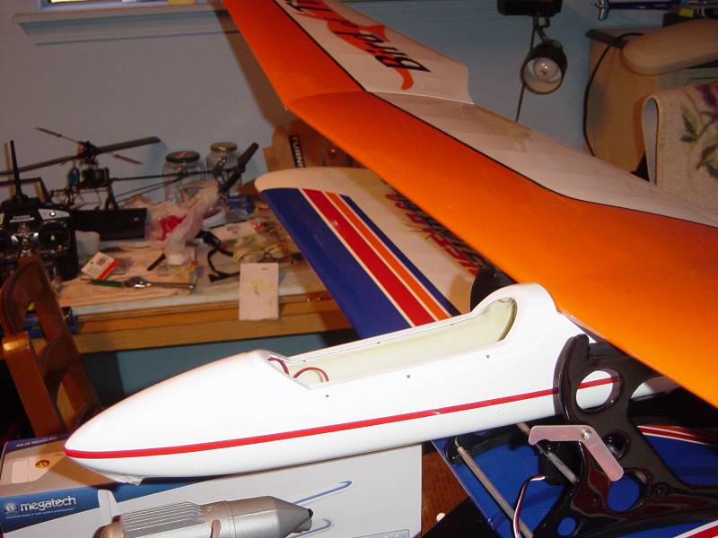

EVOLUTION OF ONE IDEA :
Had never heard of a SONY WEBBIE until J and J started mentioning it. So; I went exploring and now have
the information. 3inches wide, 4.5oz weight, 7" length, it just fits almost exactly in the CANOPY SPACE plus a small %
I looked at the BIG 3meter glider and noticed that I have set up the canopy with 1button-head screws on either side.
The observation then led to thinking it will not be hard at all to create a PLATFORM to fit the WEBBIE upon.
I need the 4.5oz weight right there, anyway. And FLOATING AROUND at 500feet [+ or -] what better platform for filming
than the BOT with total control and totally NO VIBRATION !!!! ?????
now I am throwing out the IDEA, for thrashing by my dear BOB's ..... whaddaya'all THINK ? will it work ?????
I think this project is germinating in W N U K ' s mind also.
Am Iright ?
let's see just what follows : I am curious

Rick ~
That's sounds like it would be fun with a cam ! I still need to play around more with mine some more, but the wind has been fierce today. The trees are pretty much horizontal in the yard right now and there's nothing I own that could take it. Maybe tomorrow...
I think the Webbie would be better suited for a plane than a heli, but not sure still... I moved mine away from the electrical components with some more foam and it helped the interference some more. Next, I'll try having it way up front and under the battery.
