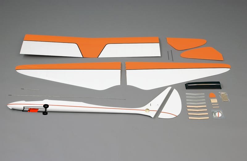

Rick,
I've been seriously pondering this idea with the Bird of Time as the platform. The glider is perfect for smooth vibration free video. If the camera is mounted in the fuse where the pilot sits it would face forward but have to shoot through the smoked/tinted canopy of the glider, not good. Also the shot would be straight out not angle slightly down for the terrain. It wouldn't be possible to make a hole in the bottom front of the glider for the video to shoot through because of where the servo and receiver are. My other idea is making a flying box with wheels that would attach to the bottom of the front, hold the camera, and use for landing. I made a quick sketch to give you the idea of what I was thing. I would make it much more smooth than just square side for less drag.
Another idea would be vacuum forming a new canopy, clear, that would also be taller so the camera would sit up higher and be protected from the oils from the host plane.

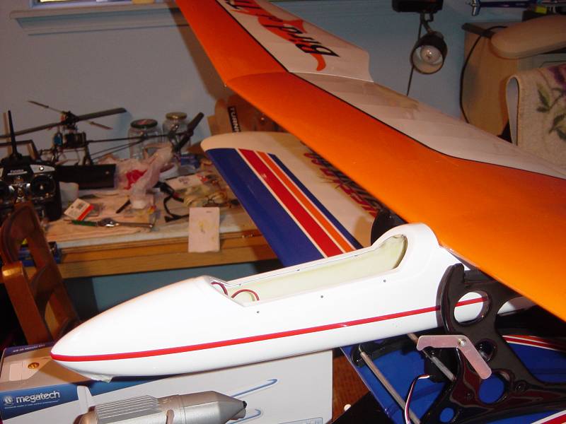

My approach is very much less involved. Having seen the WEBBIE, and the rotational lens : a very simple horizontal platform, attached to the fuse where the canopy position is; a thin bed of foam (no vibes!) and the camcorder attached ON TOP, out and up in the breeze. LENS rotated (maybe 45deg. down, no canopy , just plain
out in the air; should give me one un-impeded view of the world below, from t/off all the way to landing.
OIL from the exhaust is no factor at all : the Glider sits EXACTLY 7inches above the head of the engine whose exhaust is further pointed down and away from the nose of the glider where the WEBBIE rides. Air movement all by itself keeps the camera clean and safe flowing back and away down under. Also consider the neoprene exhaust extension which carries the oil further away. The only oil residue that appears is always on the right horizontal stab, mostly below.
Just now took some ESTIMATED angles ; the LENS sits about 6 inches above the ARC of the spinning propeller ( cut down by 1 inch with the 3 blades prop)
this in turn allows a clearview to the horizon with about 15degrees angled down from the horizontal line stretched from the camera to the infinite point.
I am thinking here, of the possible blur caused by shooting film through the prop. which in this case I believe will not happen at all.
Weight ( and weight and balance) should also not factor in ; MAYBE interfering with the smooth airflow around the nose could have some bad effect, but I think that 3 meters worth of wing, with a chord almost a foot wide, upturned double dihedral wingtips, and eliptical wing tips should be correcting for the almost negligible streamlining interference.
In any case, the whole package remains UnExplored still. Tests should begin soon as Isolve ONE last but serious problematic connection that involves the RELEASE of the glider itself.
there will be reports, which I hope will INTEREST y'all........( Maybe all this should be posted in a different thread, but y'all are almost FAMILY by now)
bye' RICK

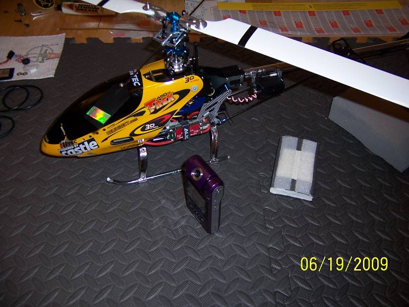

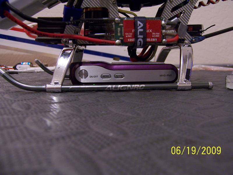

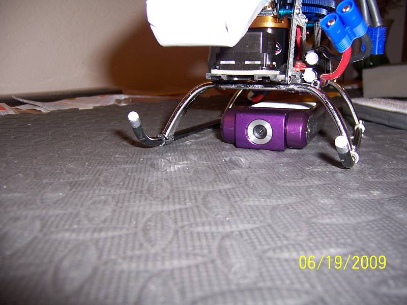

Rick ~
Its really not even that big (3" by 7")...
Closer to 2" by 4"... Fits perfect on the bill of my baseball cap.
Tonight I also weighed it for the first time, as I thought like they listed it was 120 grams, but actually its only 114 grams with the battery, and the required memory card which I chose the 2 GB one. The only other thing you need from the package is one of those memory stick Duo Pro or something similiar and they ranged in sizes of capacity. 2 GB is plenty for what I'am using it for, and was only $29.99 at Wal-Mart.For fun, I took a few pics of the Webbie in case it may help ya see the size next to a few things your familiar with that you have like the DX7 and the Trex 450...
I don't think I could use it on the 450, because of the components close by and interference... But I've been trying to do some research on the different materials used for shielding like steel, copper, aluminum and carbon fiber. Different materials work better for the frequency trying to be shielded.
Anyway, here's a couple pics before I go off and play in the hobby room.
Make sure to watch plenty of Webbie vids to be satisfied...
~ Jeff
