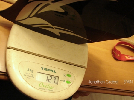

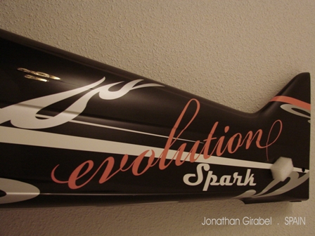

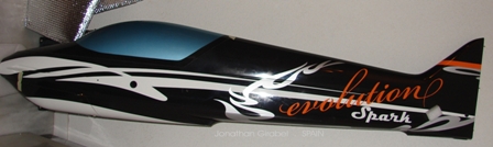

Old 01-25-2011 | 12:54 PM
  #65
lyka's Avatar
Joined: Apr 2005
Posts: 75
From: MALAGA, SPAIN
Default RE: New Krill Spark Evo I- Build Thread.....
Hey guys..
Today has arrived ...
First steps in the assembly.
GREY background values are for catalog and / or estimated in this thread.
Rest of actual values obtained in this kit for me
more coming soon

Old 01-26-2011 | 08:29 AM
  #66
Joined: Nov 2006
Posts: 144
From: hedensted, DENMARK
Hi
nice plane
its only4771g
you have 2* stabilizer tube
Old 01-26-2011 | 08:33 AM
  #67
lyka's Avatar
Joined: Apr 2005
Posts: 75
From: MALAGA, SPAIN
ORIGINAL: Torben Parsberg
Hi
nice plane
its only4771g
Ohhh...!!!...most best...-17grs. !!!!..thank you !!!!
