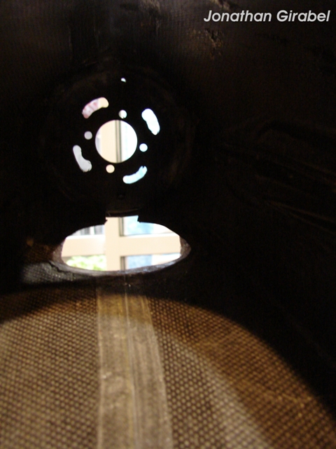

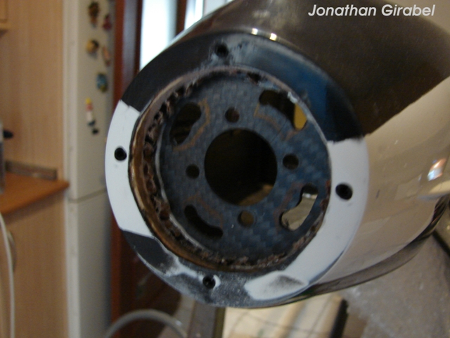

ORIGINAL: jon bruml
Andres
Thank you for the speedy response. Although I have not seen a Spark before the quality of this plane seems quite impressive
To be clear you are mounting directly to the nose of the plane with 4mm bolts? Are you placing the 2mm carbon plate between the motor and the spinner ring inside the plane?
Hi Jon....
Exactly.
When I start working at this point I could indicate how many millimeters is the plate .... the moment the idea is that we have discussed.
You can get more info in
http://www.rcuniverse.com/forum/m_94..._3/key_/tm.htm
greetings

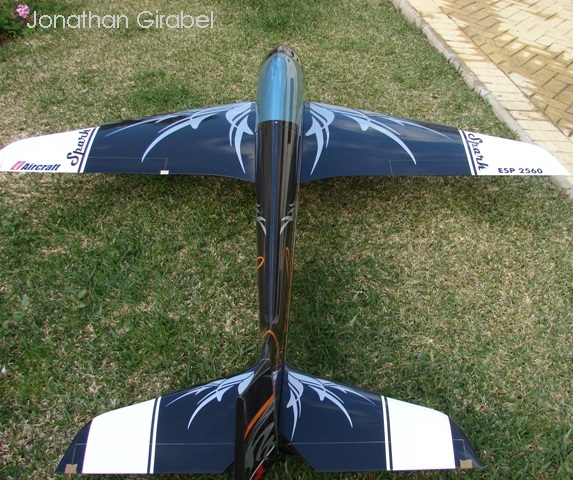

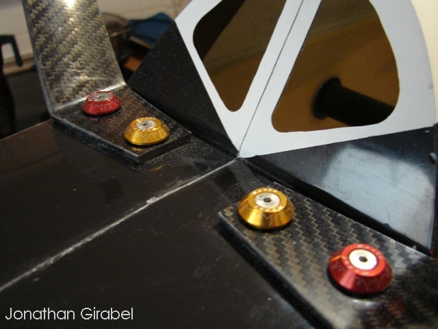

Pics and details...

Lyka
i noticed that my stabs do not really fit flush against the fuse side. The top of the stab seems flush but there is an 1/8 gap on the bottom on both halves.
How does your stab fit?
Jon
Old 01-31-2011 | 05:01 PM
  #80
Jason Arnold's Avatar
Joined: Aug 2005
Posts: 1,341
From: Sydney, AUSTRALIA
Default RE: New Krill Spark Evo I- Build Thread.....
Hi Jon,
To get a nice flush fit on my Spark I had to sand both the wings and stabs. Doesn't need much work however 1/8" sounds like a lot.
Cheers,
Jason.

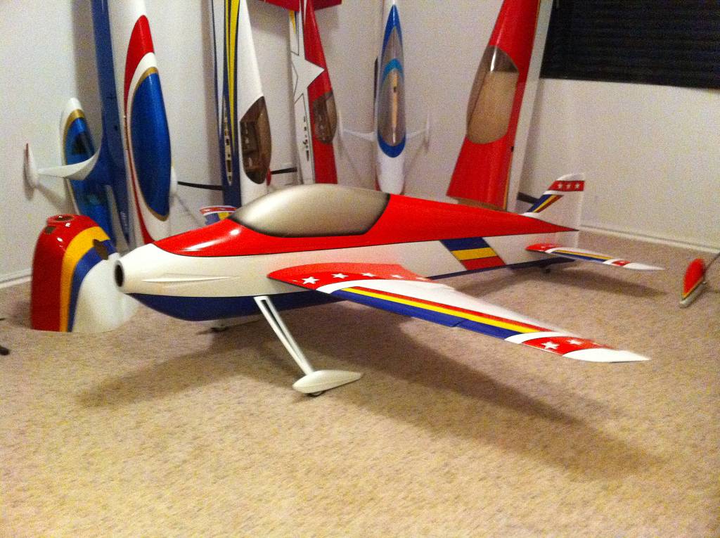

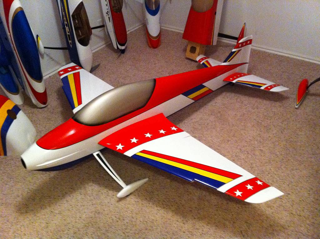

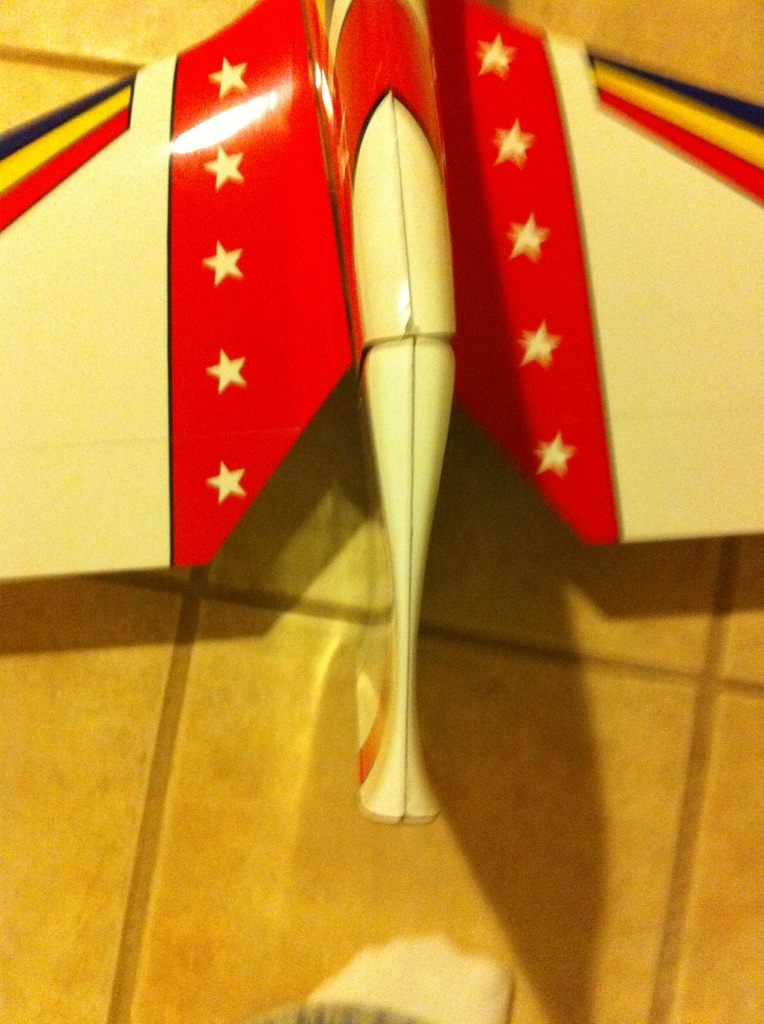

I was finally able to get the pictures I took off my phone of my Spark Evo.
Andrew

That's nice Andrew. Where are they?
Old 01-31-2011 | 08:25 PM
  #83
Posts: 699
Received 5 Likes on 5 Posts
From: monroe, MI
Sorry had to upload the pictures.
Andrew

Andrew
Hi I notice you have a Wind S 50 on the rack, how does it compare to the Osiris?
Cheers Dave

What is the reason for having a belly pan on an electric only plane? I know there is a glo version coming but why the bellypan on this version?
Woodie
Team Acme LG
Team Blenderm
Old 02-01-2011 | 11:54 AM
  #87
Posts: 699
From: monroe, MI
Woodie,
Soon your going to see the glow model that's uses the same fuse but has a difference chin cowl on it. This allows krill to have a single mold for the airplane and not have to cut a bunch of different molds.
Andrew

Hi Jon....Not in our case, below or above there is no difference.
Just remember to have cut the stab tube two millimeters
On the wings, no difference gap.

Hi Andrew !!!... fantastic scheme!! ... looks great ....
Query: CG point ... where?????....behind carbon wing tube ????..10 mm ?????..around ?????.....if do you have reference for to start ?
cheers

Hi Kevin.... in the first time, when I install the two stabs, I see it gap difference but in the top y botom the same...2mm cut off tube stab and perfect... yes, I think that you have improper fit...bad luck...my god !!!
cheers

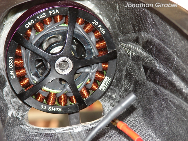

Look advance...pics.

Lyka
Nice set up. Thanks for the picts
I have decided to go with the Pletty 30-10 due to the weight of the q 80

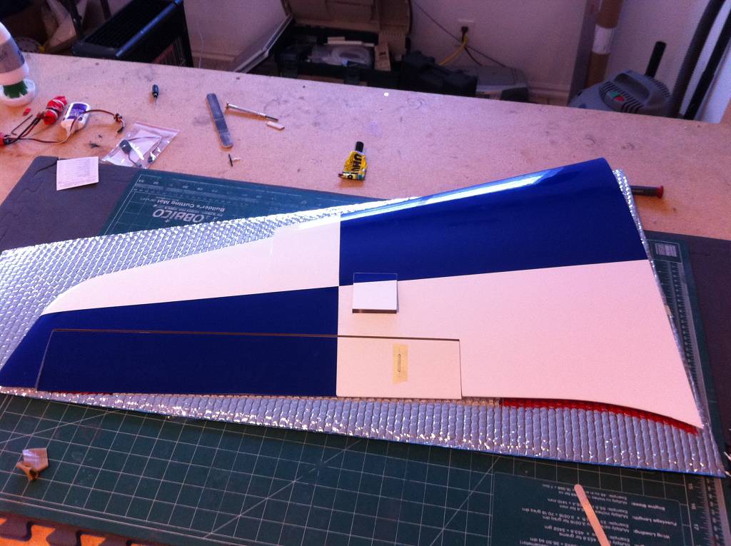

ORIGINAL: joenella
Hi Andres
Any pictures of the aileron servo installation?
HI Joe..... in two days I´ll work over the wings....I was seeing the servo place and I think it will be easy to install, much easier than the previous model of SPARK ....
Today I worked on the rudder horn ... careful with the chosen site, because the internal block is not very big ... the size of the servo arm should be 80 mm long....
cheers !!!

I have the servos installed in my Spark Evo, and Andreas is correct. Much easier to install the servo as you have the access panel there to install the servo. Once the servo is installed you then cut the cover to allow the servo arm to come outside. I ran a Du-bro HD arm that measures 1" to get all the throw thats needed. For servo extensions you will want to run a 9" Extension to get the servo lead out of the wing.
Andrew
