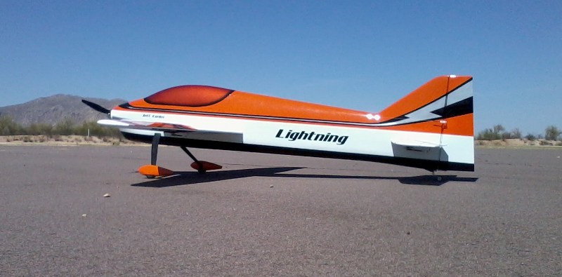

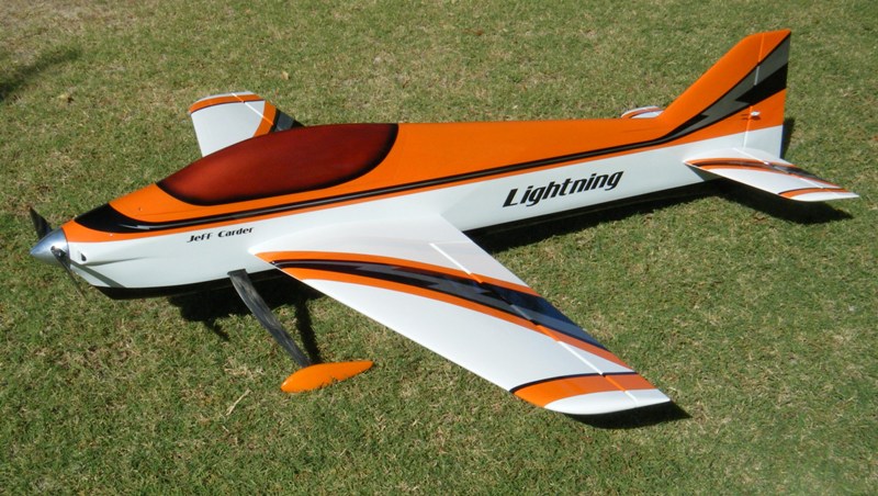

It has been almost a year since I had a midair with my Lightning. Today, it finally got to slip the surly bonds once again. It still flies great!
The midair repair consisted of new wings, repairing minor structural fuselage damage, repairing three major gouges in the fuselage and canopy, repairing some superficial dents and dings in the fuselage, and repairing gouges in the stabilizer leading edge. The fuselage was sanded down and received an all new paint job.
All landing today were 100% better than its last one in South Carolina!

Looks great Jeff.
Arizona is the only place that I have seen bowling balls as yard art!
Old 09-16-2012 | 07:43 PM
  #409
Posts: 136
From: Great Bend, KS
Default RE: Lightning Build
Way to go Jeff! It looks great.
Joe Dunnaway
Old 09-17-2012 | 04:02 AM
  #410
My Feedback: (45)
Joined: Oct 2003
Posts: 2,861
From: Great Mills, MD
Looks great Jeff. Let me guess, you were able to take out another 100 grams somewhere too....lol Your building skills are awesome. Hope to see you guys soon,
Arch

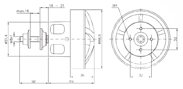

Thank you for your lightning. Iamon my way to start the fuselage.I am interested if someone has realisted the lightning with a q80 motor. The Space between F1 and F2 seemt to me a little bit to small.? Have you thought of adding a cannalizer to the fuselage?
Arnold

Arnold,
I'm in the process of building the fuse myself. I had to move F2 back in order to fit my larger Turnigy G-160 motor. Due to the slope between F1 and F3, I had to create a new F2 with a 1/4 inch larger radius.
Jeffs plans, combined with this thread, are great!
John

I don't have the Q-80 measurements,but for the C50, the tail ring attaches to F3
I do not plan on a cannalizer for my airplane. If you try it, please let me know how it works.

a canalizer like that.....
the new q80....
Arnold
