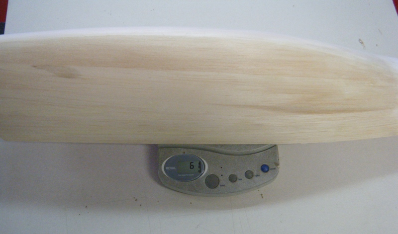

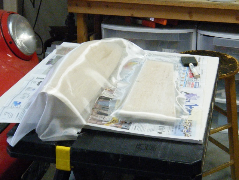

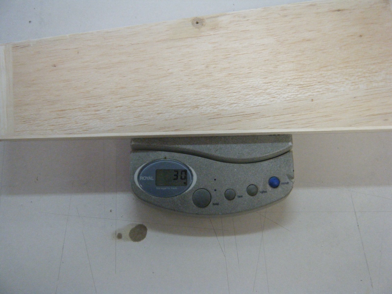

Default RE: Lightning Build
Some pictures of the motor rear support, fiberglassing, and weights of the fuse, canopy, and rudder prior to glass.
