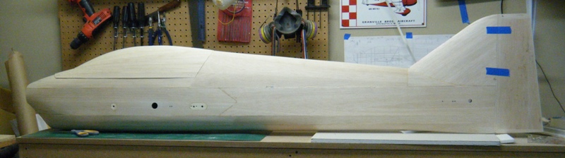

The rudder is built up using 3/32†balsa ribs, 3/16†balsa leading edge, 1/8†balsa trailing edge, sheeted with 1/16†balsa. I use a jig that is incorporated in the structure for alignment. The leading and trailing edges are cut in 1†strips. I mark the centerline on the leading and trailing edges. The ribs are glued to the leading and trailing edges, lining up the centerline of each rib with the centerlines I had drawn. Then the entire assembly lays flat on the building board, the excess LE and TE are sanded flush, and the sheeting is glued on. Once dry, I tack glue balsa blocks on the LE and TE to make the jig for the other side.
Up next, everyone's favorite part of the first Lightning, the balsa canopy.

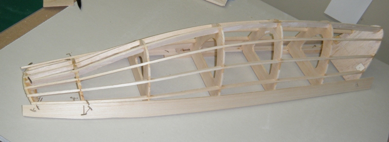

Old 03-26-2011 | 04:39 AM
  #108
Viper Driver's Avatar
Joined: Feb 2003
Posts: 397
Received 5 Likes on 5 Posts
From: Archer City, TX
Default RE: Lightning Build

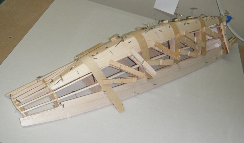

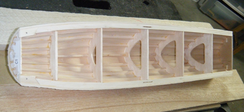

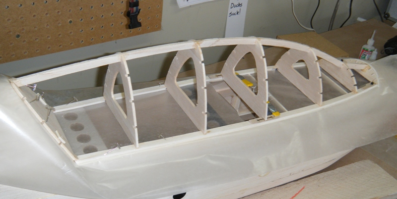

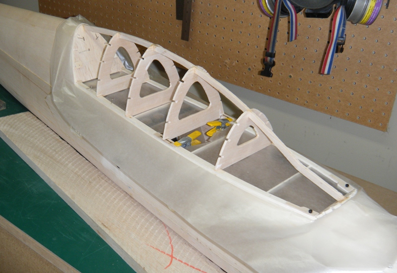

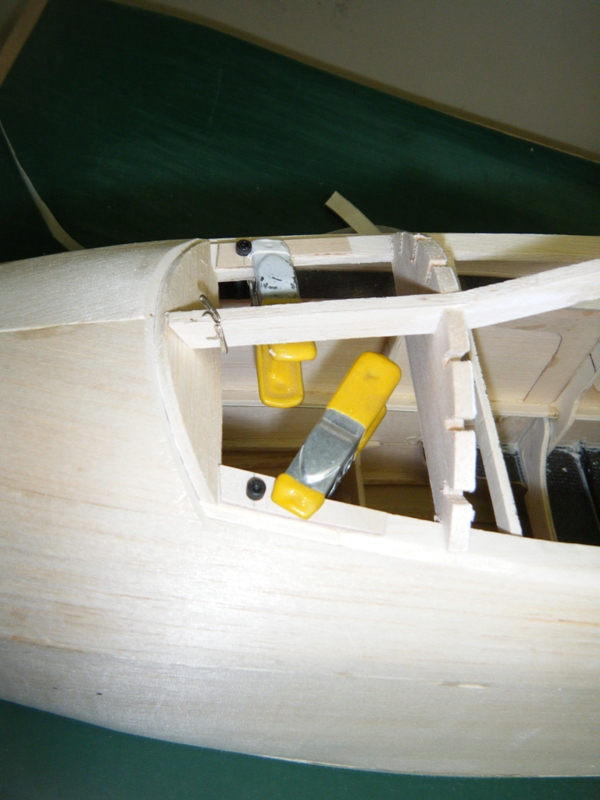

The canopy construction starts off 1/8" balsa rails, 1/8" balsa formers, 1/8x1/4 balsa stringers, and a 3/16" balsa spine. I build the canopy frame directly on the fuselage. All of the attachment hardware is installed at the point. I use two 4-40 screws at the front, two carbon blades in the middle, and carbon pins at the rear. The front of the rails is 1/8" light ply, grafted on, to make hard points. 1/32" regular ply is used to reinforce the slots for the blades. The rear pins are glued into the canopy and slide into plastic sockets in the fuselage. Not very high tech, but quite rugged.
Once the frame is glued together, it is removed from the fuselage and is ready for sheeting. This is where the fun begins!

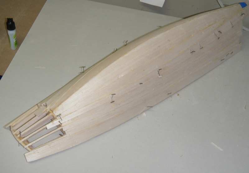

Old 03-29-2011 | 04:40 AM
  #113
Joined: Feb 2003
Posts: 397
You're right Mark, stick with the organic composite!

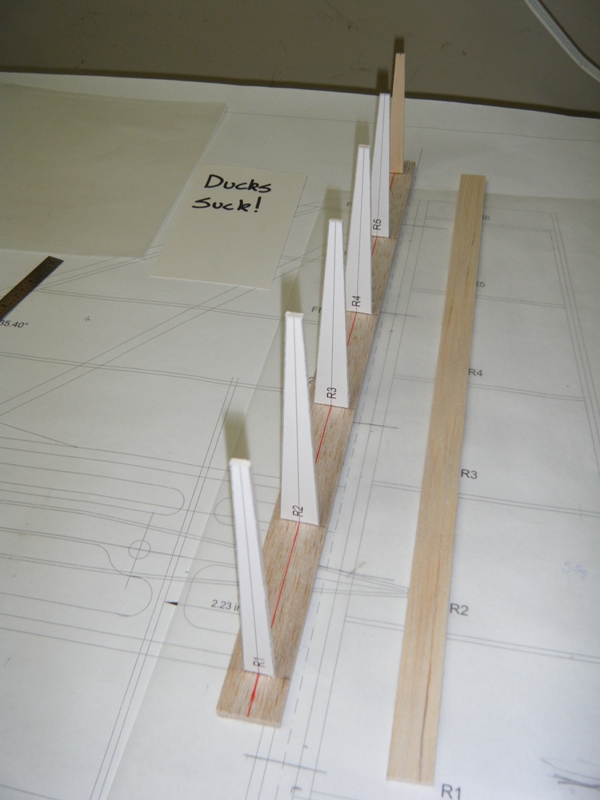

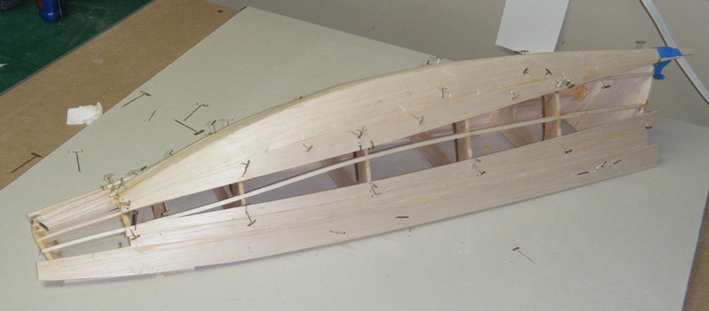

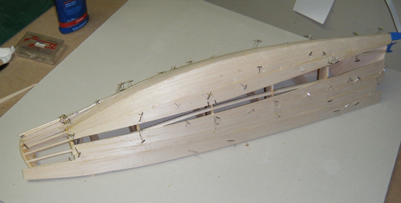

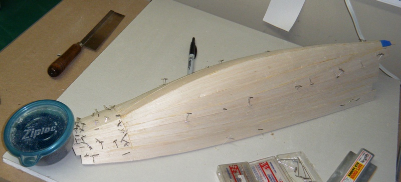

The canopy frame was removed from the fuselage and mounted to the building board. The frame is planked with 1/8" balsa.
Now, a little bit of my wood canopy history. One Lightning #1, I had to remove it took two attempts to get the planking close to correct, and even then, I had to graft sections of sheeting in to get the shape right. It was not the best experience to say the least. I was bound and determined to have this one turn out right on the first try.
I started with strips on both sides of the bottom edge, which were pretty straight forward. Once those were dry, I did two strips along the top seam. The complex curve required use of the pre-molding technique used on the fuselage. Once those were glued down, I did one strip on each side at a time. I used regular wood glue for this, so this was done over about four days. The finished product came out pretty nice. The entire surface still needs to be sanded to final shape, but even without it looks about right. It came in at 65 grams, about a half ounce less than #1.

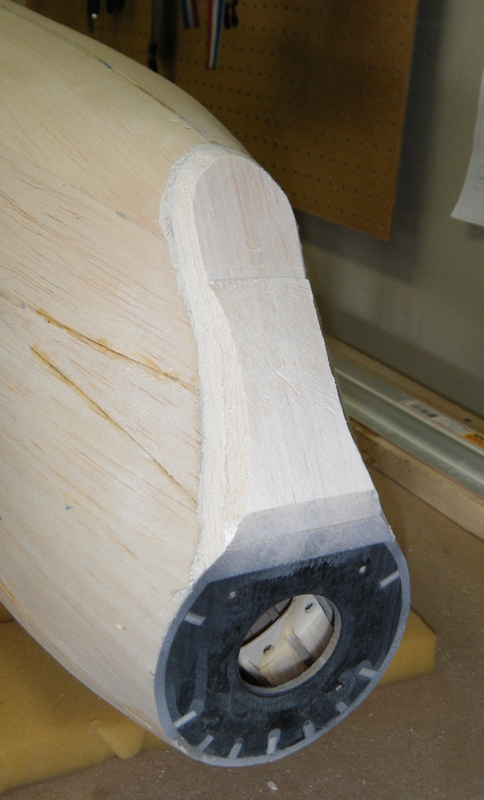

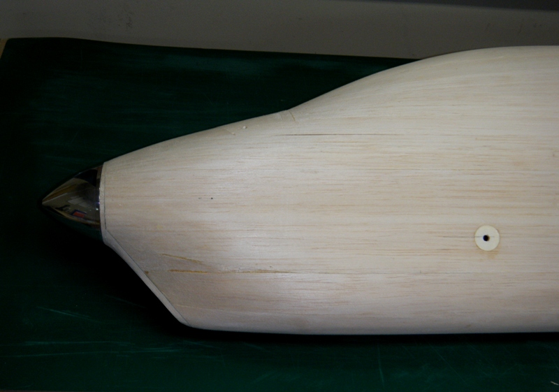

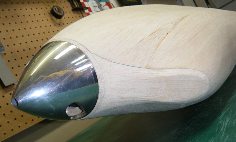

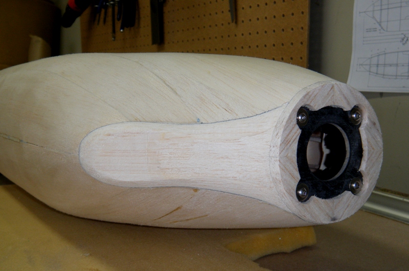

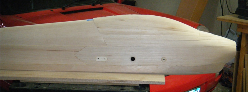

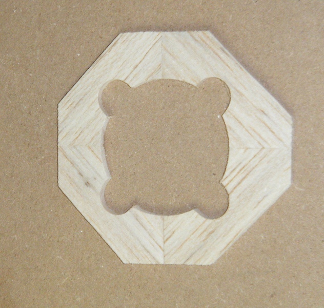

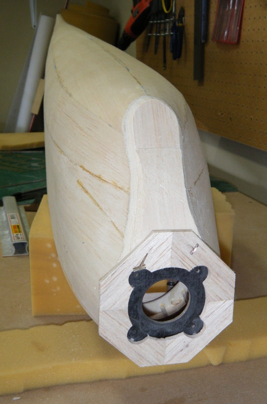

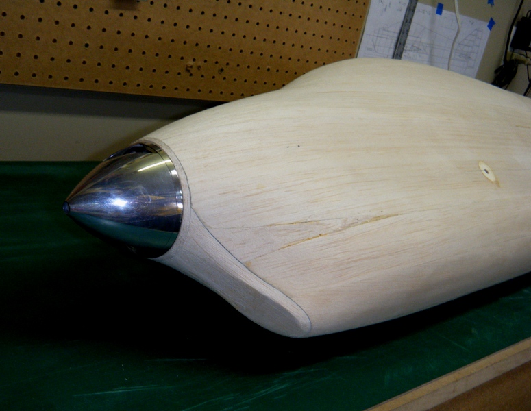

The nose is capped off with balsa and then sanded to shape. This is where a little artistic skill is required. Visualizing how the spinner flows into the fuselage and chin, and then how the balsa blocks will be sanded to create that flow took some thinking. The nose ring is made from 3/16" in quarter sections, which is to limit the amount of cross-grain to sand. All that is left to complete the nose is to cut the cooling hole.
