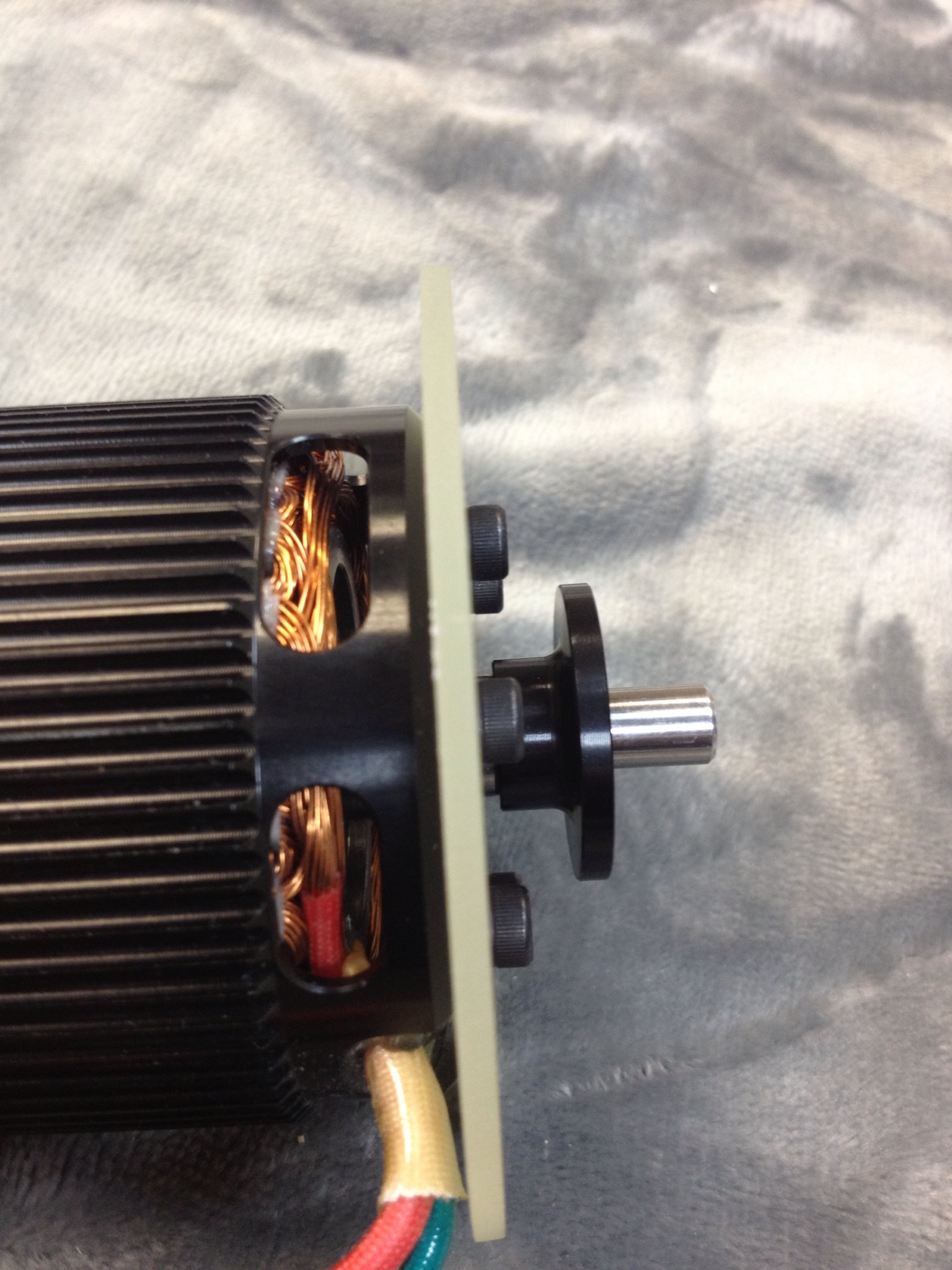

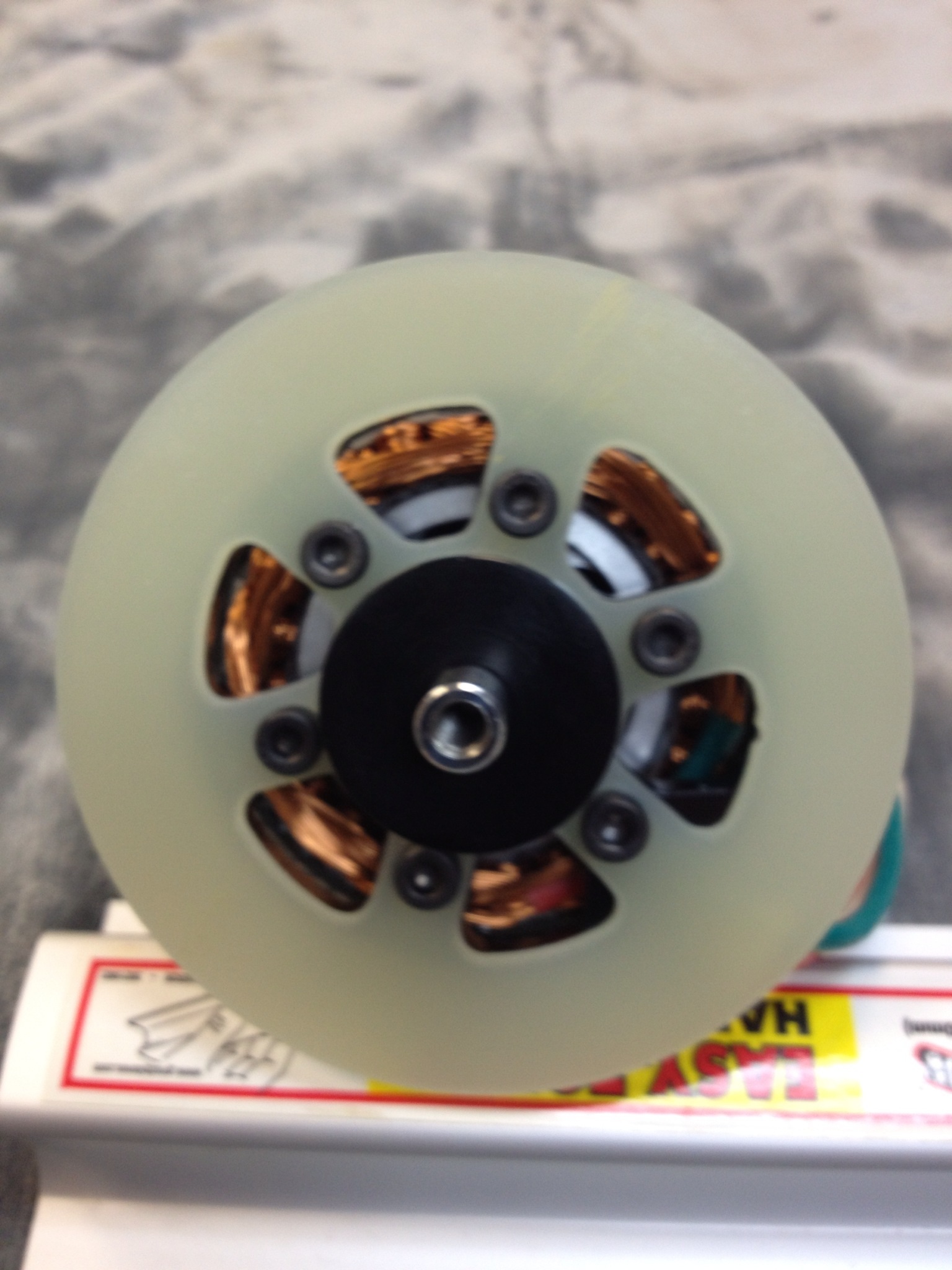

Hey guys, for any of you interested, I have had some really nice mounts manufactured out of G10 that will work perfectly in any of the BJ Craft planes and probably several other models. This mount fits the Plettenberg Advance 30-10 All you need to do is sand the outer diameter to fit and glue it in. If interested I have them available at 35.00 bucks a piece
