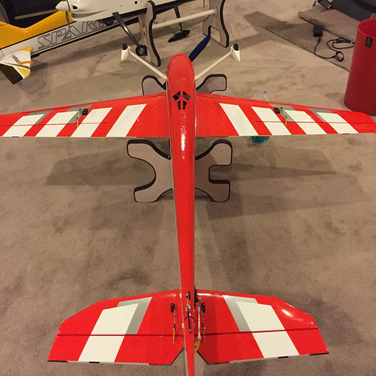

I added a couple of stripes to the bottom for visibility. Will maiden tomorrow. CG is about 275, per the pics on the BJ Craft website. Dave Snow is the builder of this one. Excellent Job!!

Sure, I use a Hacker Q80-13, Falcon 21.5 x 13 prop, Jeti Mezon Lite 90 12S Brushless ESC. On my Nuance I changes from a 21 x 14 Falcon prop to a 21.5 x 13 and it improved throttle became very smooth and is efficient.
