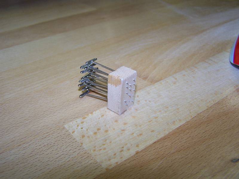

Troy suggested making a little "woodpecker" device to puncture the cloth on the inside of the fuselage along the crease. The photo shows 1/8" balsa and 3/32 balsa rubber banded along fuselage for shape.
1. Sanded area inside the fuselage with 180 sandpaper.
2. Cleaned area with wax and grease remover.
3. Using the "woodpecker", punched holes all along the seam.
4. Mixed 30 minute Z-Poxy glue and lightly warmed with heat gun AND inside of fuselage.
5. Cut 6" x 2" piece of carbon fiber woven cloth for crease on word Beryll and 1' x 12" 2 oz nylon for turtle deck crease.
6. Using epoxy brush and wooden dowel painted both pieces of cloth on piece of cardboard, removed excess resin.
7. Placed both pieces in fuselage, brushed back and forth lightly heated interior of fuselage.
8. Let cure overnight, removed rubber bands.

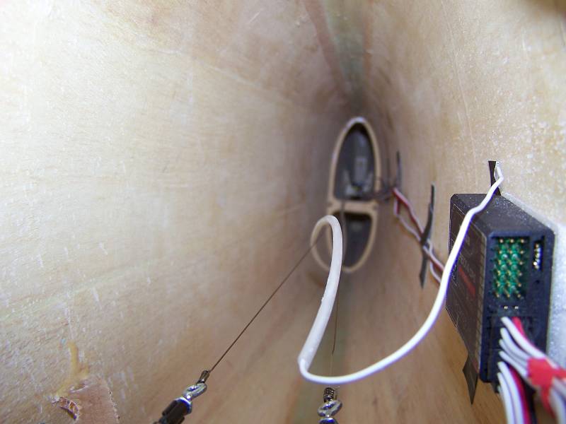

Hi
I notice you have the in between version, new wing but old fuselage. Design in new fuselage changed in order to counter some of the minor problems you have encountered. New canopy construction and the addition of a nomex former to prevent the flex you were encountering at the canopy. I must say that I also prefer my first version with the formers in the back of the fuselage.
Stuart

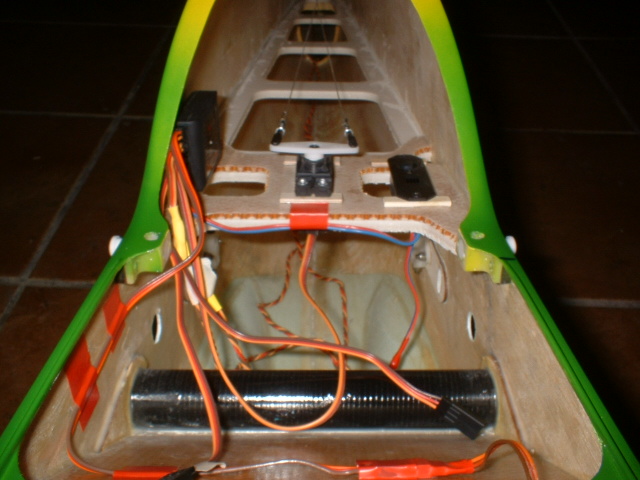

Hi

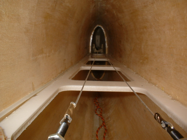

Attached find the photos showing the former installed behind the rudder servo. As to the control horns ZN Line sells nice aluminum control horns and I used Mk tail wheel with Terta wheels. (also MK ball linkages) Look at my initial post a few months ago that shows the photos. Some people also use the Hyde control horns and they just fit the mounting plates already pre-installed. As to a store try Central Hobies. I have always only received good service from them and delivery from the USA to South Africa in three days.
Burt

Hi Stuart
Also forgot to mention if you look at the photos I posted, the former for the rudder servos is also much higher up in the fuse than the original version. Almost in line with the canopy bottom compared to the previous version.
Regards

#116
Hard to believe that small former blocks the twisting. I guess they had to raise the rudder servo tray so you could reach the wingnuts to attach the wing. Mine has the wingnuts up front. Now if they would only move the rudder cable holes foward to make them a straight shot to the servo. The supplied openings are too far back on both my pinnacle and Beryll.
I added a piece of 3/16 balsa as a crutch in the rear of the fuse from the rudder post to the back of the internal skeliton formers which are in my version. It was 13 3/4 inches long and seemeed to help. I noticed that as I would push down on one stab the rear of the fuse seemed to spread. Also the installed former at the base of the vertical stab was split behind the lightening hole. It seems like ity was cut when they cut the hinge slot. I glued a piece of balsa over the cut as well. I guess I will either add a former or try Rusty's trick to stifffen the fuse at the canopy rear.

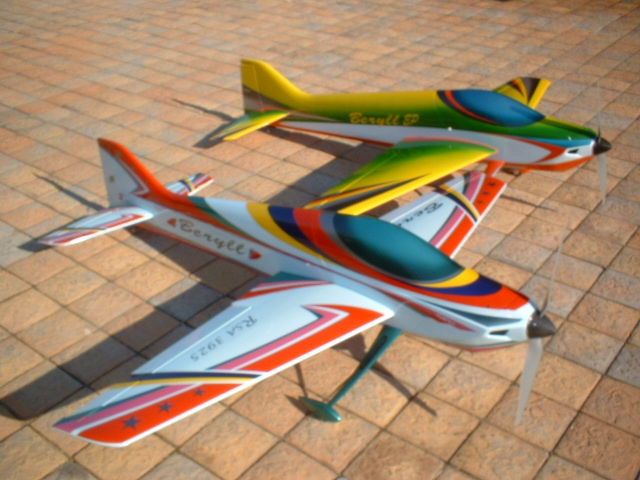

Hi

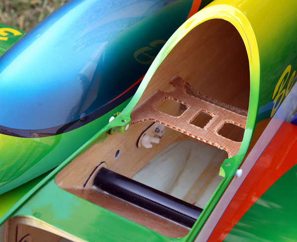

Just finished my new Beryll that arrived last week. Note that Oxai has now installed two updates to stiffen canopy section. Former mid way down the fuselage and 5 mm foam support that runs down fuselage. No flex at all any more. Hope to fly later in the week and will post comparison between two models.
Regard
Burt

Hi
Know it is an electric site but attached also find photo of new product from Oxai, the Beryll gas powered version.
Burt

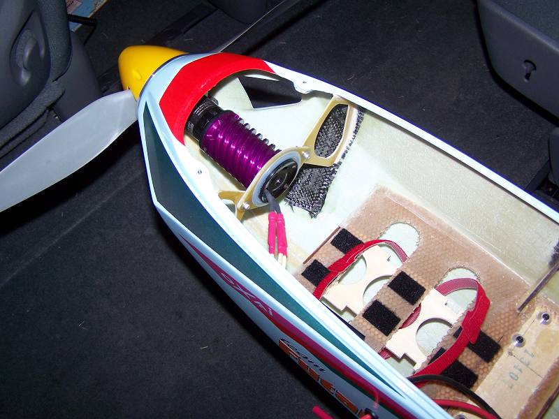

Do you have pics of you motor cooling air ducts on the Beryll. I just have the two front holes but I don't think enough air is hitting the motor to cool it. I am having soem cooling problems with my motor and am looking for solutions. When I landed yesterday my motor was 70 degrees and my batteries we 60 degrees, speed controller was ok.
Any suggestions.

That is degrees C, I assume?
My first flights( this weekend) I hit 140ish degrees F on the motor (Hacker C50 13XL). I diverted half the air coming in towards the motor and it dropped temps about a good twenty degrees. Battery temps were 106F after a 7 minute flight (Flightpower 5350's) and the measurement off my controller heat sink (Masterspin 99) was around 110 plus. In my case, I have to ask, is the temperature of the controller acceptable or do I need to improve its cooling to? Ambient temps were around 75 to 80 degrees F.
I just did some trial and error cutting of cardboard and then used it as templates for the depron I used. Ain't pretty but it did the job. It just makes removing the motor a little more difficult.

also, when it comes to pushrods, i bought the carbon rods and 2mm titanium rod ends from Central Hobbies along with all the MK ball bearing clevises etc etc.
But the titanium ends are so long that there is no room for any carbon rod!
Please email me with some advice at:
[email protected]
i really need some help with the mounting of the motor.
Everyone seems to have a different way of doing it and from what i can tell, there is noone else near me with a similar plane; so i am by myself on this one.
My kit came with the 3 large plates to support the rear of the motor; i understand how that works.
For the front of the motor, it came with 2 sets of plastic (composite) rings. One of them is quite slim and is perfectly circular in shape. It is about 5mm wide. And for some reason came split in 2 pieces. The second part for the front is a star shaped piece quite a bit larger than the first one and again it is split in 2.
I am gathering that the smaller of the two mounts is a spacer ring. The second one bolts to the front of the motor and has 4 holes in the outer corners but these holes are large and don't look like they are meant to bolt to the nose ring in the plane. I think there are meant to be some rubber grommets that go in the holes and space it out from the front...
any help or ideas?
[email protected]
