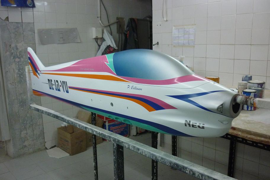

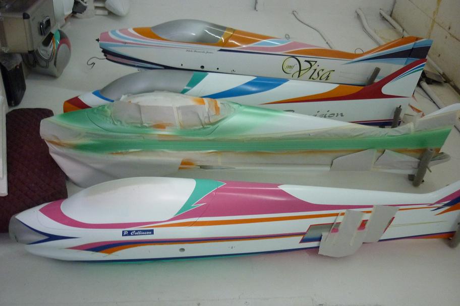

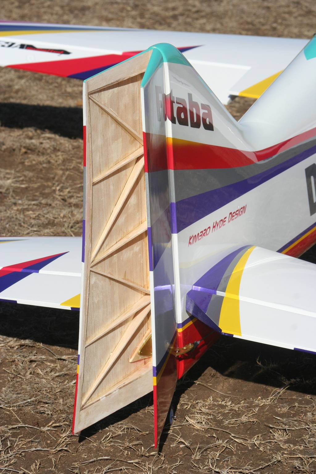

Lol you guys are correct about Pete always a highlight for me at the nats. Here are some pics of his planes they are almost identical in every way. I think we hit our stride this week with 5 planes. 2 De Ja Vu´s, 1 Passport, 1 Envision, and a Smaragd.
C
C

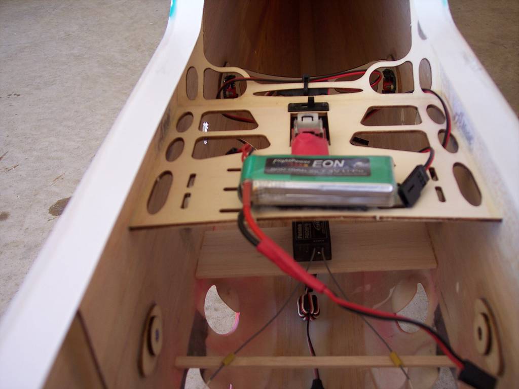

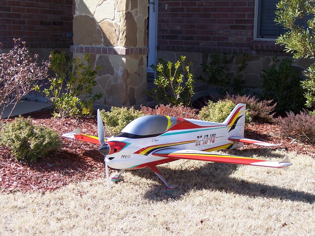

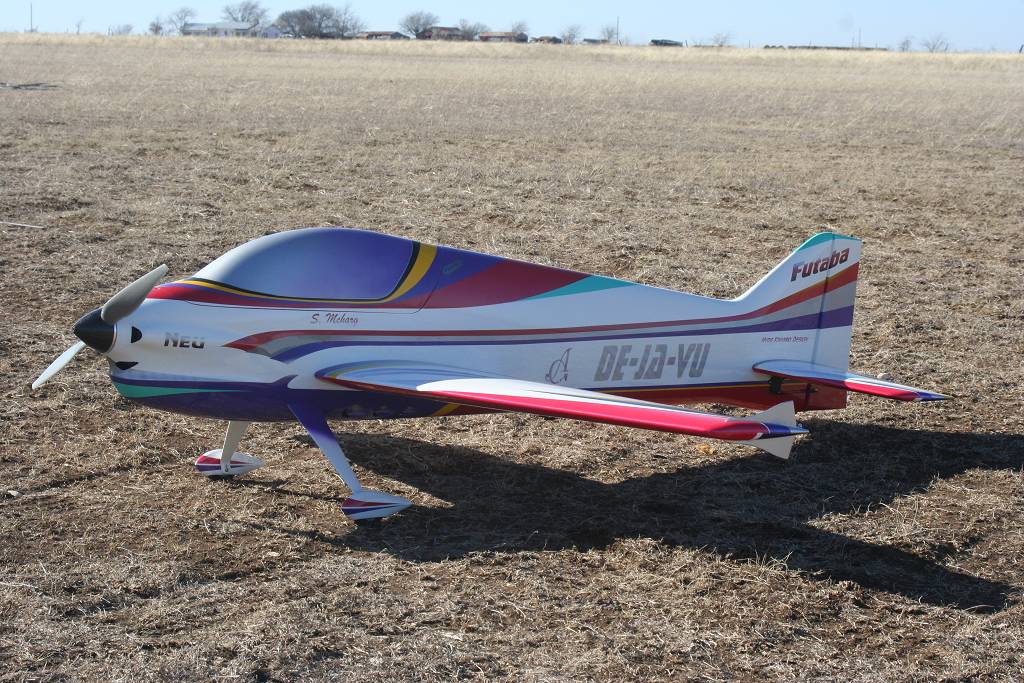

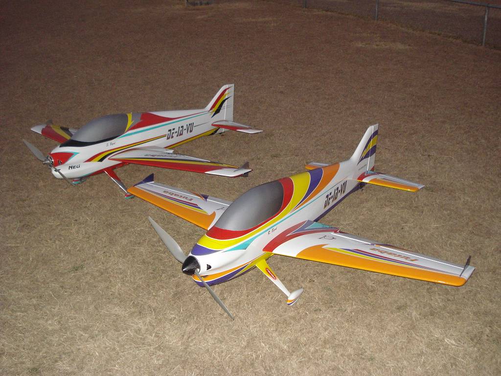

Finally done with my De ja vu here are a few pics. I am gonna try and get a couple of flights on it today. Let me know if anyone has any questions about the build.
Stephen Byrd
Stephen Byrd

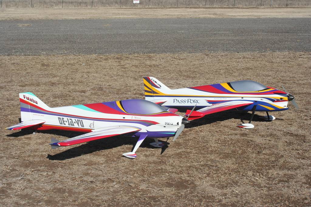

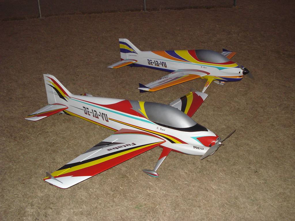

Stephen and I were able to get out and test fly late today. Both of us flew twice. Both are flying very well. I only need a few adjustments to mine. Mainly on throw setup, but I'm going to wait a bit before I change too much. I haven't flown a pattern plane in several years, so it was a little different. In saying that I'm also smart enough to know the plane is flying very well. I can't wait to get some more time on it and really get back in the groove.
Both planes are setup identical other then Stephen's has a Neu motor and mine has a Hacker Q80 in it.
Rick
Rick
#156
Stephen,
What happened to your spinner man?
I also got to fly mine today for the first time. It is set up the exact same as Todd's except he likes hotter ailerons and less elevator and I like slower ailerons and more elevator. We put in 3 flights in a good 20 mph wind so a calm day will tell a lot more. The plane tracks extremely well. I need to get use to flipping more switches more often for the split rudder. I'm looking forward to this season with both my planes.
Scott
Scott

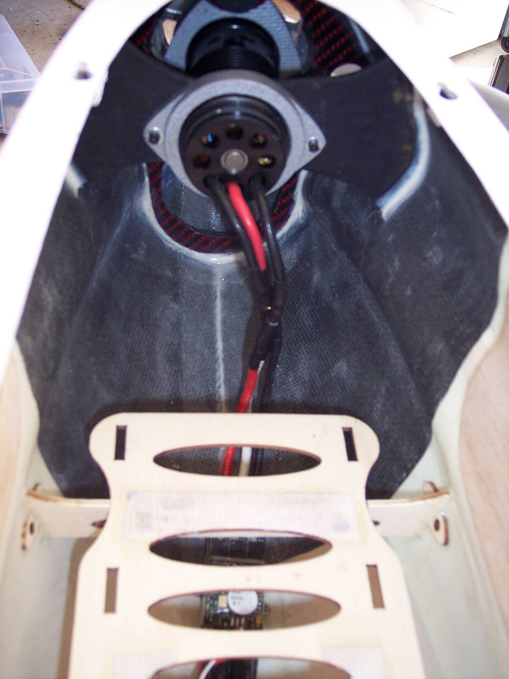

Hey All

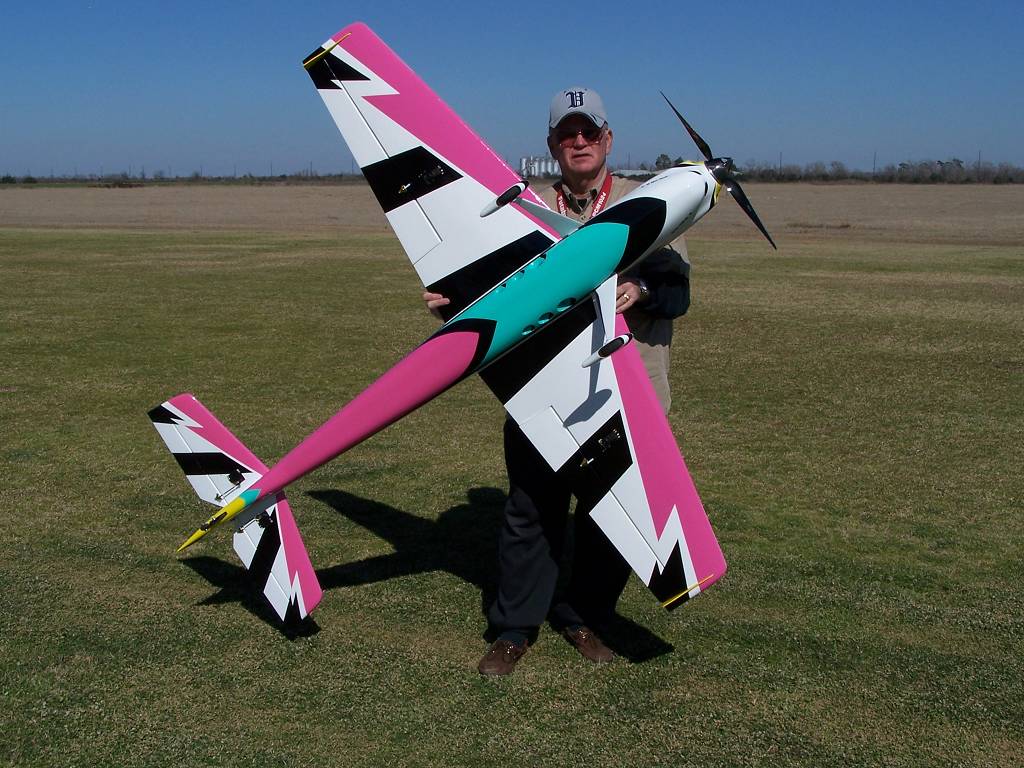

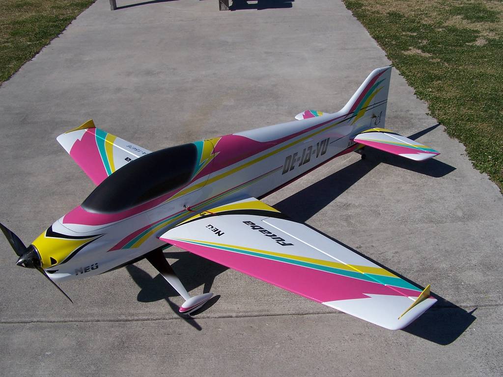

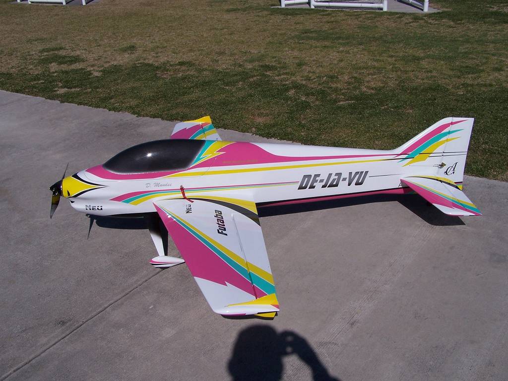

Finished my De-Ja-Vu around 1:30 Saturday afternoon and took off to test fly!
First some Data, aircraft final weight with F3a Unlimited flight pack ready to fly was 10 Lbs. 12.5 Oz. three ounces better than the Visa I had. Several reasons for this as I decided to go to Monokote bottom of wings and all hardware was carbon fiber, aluminum, or titanium and the product from CA was lighter than the Visa. I used the old flow thru hyde mount with carbon fiber end grain balsa for the firewall and tail mount. Motor is a Neu FAI and speed control is Castle Ice HV 80. Regulator is Smart Fly Sport series with switch. Servos are 9151 on Rudder & Ailerons and 9650's on elevator. Receiver is Futaba 2.4 8 channel with a TP Pro-Lite 730 Lipo for power. Prop is a Falcon carbon fiber 20.5x14.5 that weighs 62 grams with a Flow thru carbon fiber nose cone on a fan blade TruTurn backplate.
The De-Ja-Vu fuse is huge and I also ordered the Balsa inlayed Canopy to prevent paint cracking and made the unit much more durable for very little weight gain! I pulled every trick in the book to get the weight down including using Kevlar thread for the Pull-Pull on the one piece rudder. This saved a lot of weight over the 2 servo 2 piece rudder and really reduces pilot load on flipping switches!
I made two flights Saturday and two flights Sunday and feel much more comfortable with the De-Ja-Vu than I did after 50 flights with the Visa! It's hard to believe the flight difference between two aircraft that only have a different fuse with different wing and stab locations. The wings and stabs are the same as the Visa. I have a ways to go before I get all the triming zeroed in but I am getting close fast! My C/G is is between 71/4 and 71/2 inches back of the wing leading edge at the wing root. I am still playing with this as I have not had a no wind day to really check the knife edge mix but currently I have no mix programed other than some down elevator for the no power down lines so I have got to be pretty close on the C/G. I also have a very small amount throttle rudder mix for full power verticals but less than half of what I had on the Visa.
The very first thing I learned in flight was that the aircraft is a lot more "draggie" and requires more throttle for all the horzonital maneuvers to get the speed where it needed to be. The good news is this aircraft is much easier to get a constant speed in the up & down lines than the Visa. I don't know if just me or the aircraft but it seems to do everthing at a slower speed. I always felt I was rushing thru the maneuvers with the Visa. In retro spec I think I needed to make the maneuvers larger with the Visa. After not flying for two months I am really rusty so I have a ways to go not only with the aircraft but with myself as well. I am enclosing some pic's and as you will see this is a very different look as far as the paint job but I needed help in seeing the aircraft in the air and to that end this scheme is very easy to see! Hope you like it as it's pretty "LOUD!"
Dick
Dick

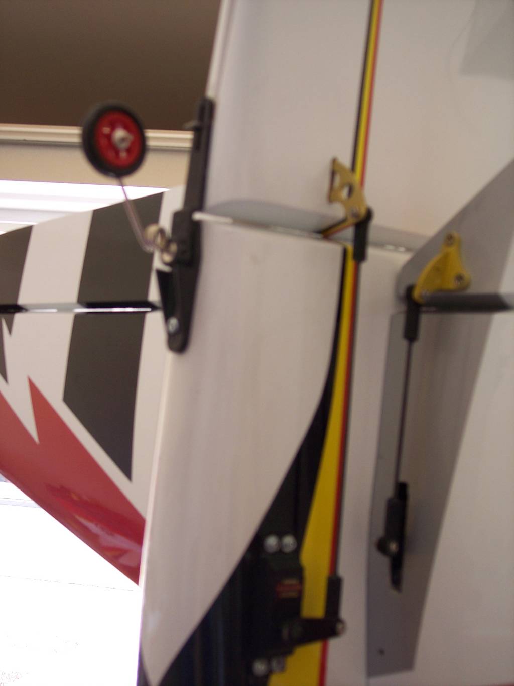

Hey guys I am glad everyone seems to be liking there De Ja Vu´s I know Pete is chomping at the bit to get his going and Ricks back up is about a week from being finished. I have read all the comments and the only thing that confuses me a little are some of the ones about the split rudder. I think Scott mentioned more switch flipping and Dick has commented on the weight savings. I think it is time to address both of these just a little.
1. More switch flipping. This I really do not understand but please correct me if I am wrong. To do a stall turn don´t most of us go to a high rate Rudder. Thats one switch to flip equal to if you have a split rudder. Also if I am not mistaken to do a snap roll don´t most of us flip to a snap condition. That too is equal with the split rudder. So as far as I can see its exactley the same.
2. The weight issue. I have weighed both the split rudder (Approx 65 grams for both, the Single Approx 75grams) so the split is actually 10 grams lighter because it is built up verses the foam. Now for the servos, the two 9650´s weigh approx 28 grams each for a total of 56 grams. The lightest rudder servo I know of is the 9151 at approx the same weight most other are 15 to 20 grams heavier.
So at this point we have equal servo weight and a lighter rudder. The only difference is the extensions. Also without needing a rudder servo mount in the fuse you can easily remove another 10 grams of servo tray weight. So all in all its equal.
Now the advantages. With a single rudder on a plane with SFG´s you will need to run a very high amount of expo and a very low amount of travel for normal flight. Probably somewhere around 65% expo and 30% travel. At those setting your servo, as good as they are today will have horrible resolution. With the split rudder, the one that moves will have about 45% expo and be around 75% on the AFR. This is where the servos were disigned to work at there optimum according to people I have spoken to like Steve Helms.
That in itself is the only reason we use the split rudder. Its not a gimic, its to optimize our $2000 radios and $100+ servos.
Hope this clears things up a little.
Chip
Chip

ORIGINAL: pattratt
Hey All
Dick

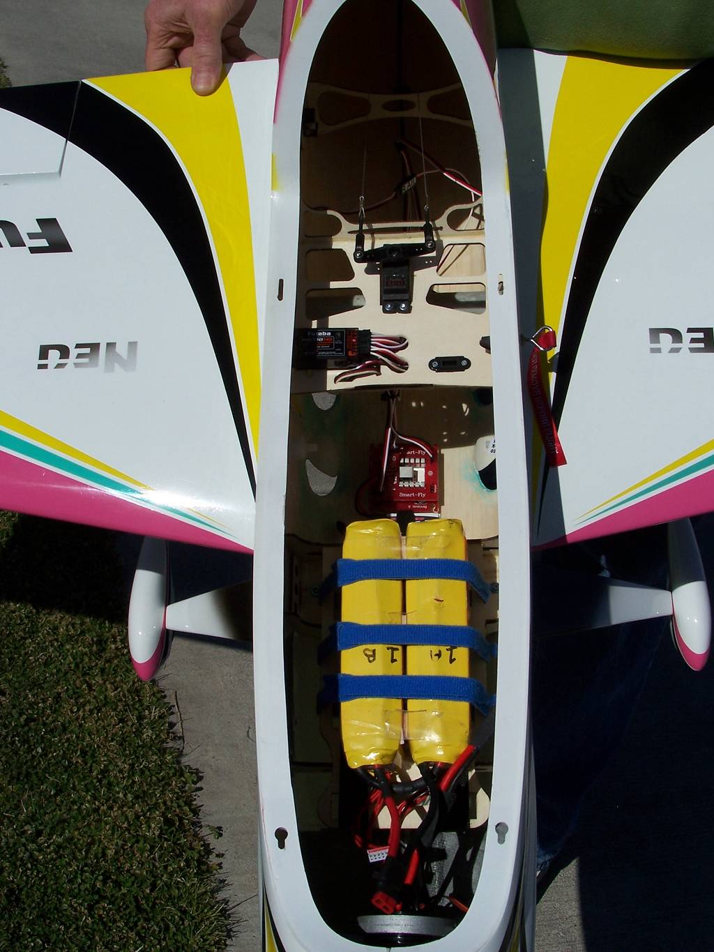

Looks great! A question: is that the arming pin/ribbon on the left side of the fuse? What product is that? How's it working out?
Thanks.
#168
Hey Mike
Yes, it is the switch option that can be ordered with the SmartFly Sport regulator and it is exactly what the doctor ordered. When the pin is pulled it actuall disconnects the switch from the regulator turning it on and providing power to the receiver making it impossible to have a switch failure in flight. The other nice thing is that you can tell from across the room weather the switch is on or off. I have used every system ever made and I like it the best and is not exspensive. Chip is the one that put me on to the SmartFly system. They have a website so just do a quick google search for info.
Dick
Dick
