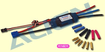

That's a very interesting video Kenny, I noticed however that you do not have a ferrite ring on the cable that plugs into the RX, all my ESC's have a ferrite ring (donut style magnet) installed onto the cable that plugs into the RX, it's wrapped around it several times, that could be what you need.
Notice the Align ESC pictured below, see the RX cable wrapped around the magnet? You can buy them at almost any local hobby shop, just remove the RX plug from the end of the cable (NOTE the pin order, an X-acto knife works great for releasing the pins), then make several wraps around the magnet positioning the magnet 1/2 way on the cable, re-install the pins into the plug.
That could make the difference!
Shadow
Shadow

Good idea with the Ferrite ring, I will have to pick some of those up. My new ESC will be here tomorrow, so I will give it a shot and see if that fixes the problem. Wish me luck

Tried the static guard and the ferrite ring. Neither fixed the problem. Although I could tell a substantial difference with the ferrite ring, there was a lot less servo chatter, so I will be using them on all my models from now on. Waiting on my new motor and 2.4g module to get here.
