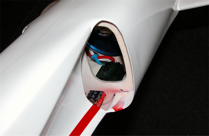

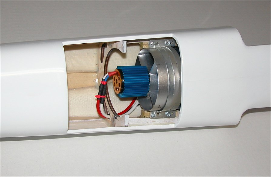

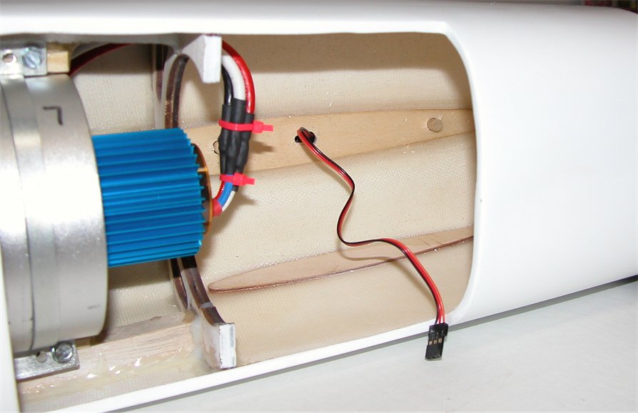

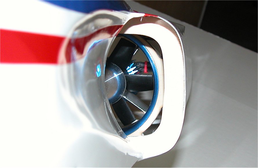

To power my Starfire, I'm using a Lander 90mm DF with a Wemotec Midi Pro rotor, a Castle Creations [link=http://www3.towerhobbies.com/cgi-bin/wti0001p?&I=LXVJN2&P=ML]ICE 100[/link] ESC, an older HET Typhoon 600-42 motor, and two 4s 30C 4000mAh [link=http://www.nitroplanes.com/83p-4000mah-4s1p-148-30c.html]Blue LiPo[/link] packs in series for 8s. The power system will provide about 2400 watts.
Notice how nicely the Lander DF fits into the Starfire opening and the ICE 100 ESC is directly in the air flow for cooling. I added some hardwood blocks to mount the clamshell that holds the Lander metal DF.
The intake ducts will be cleaned up further into the build.

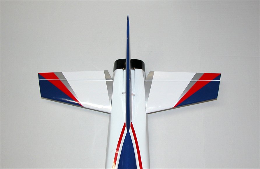

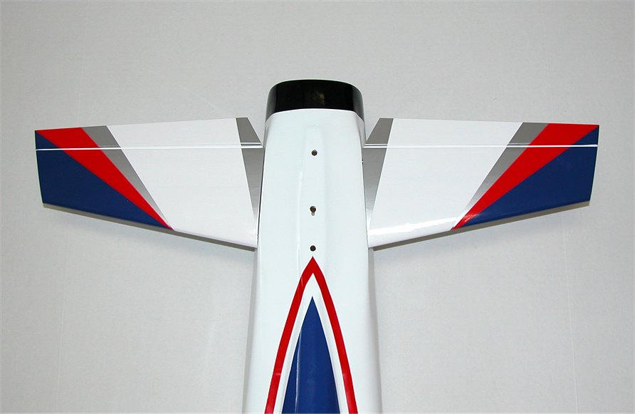

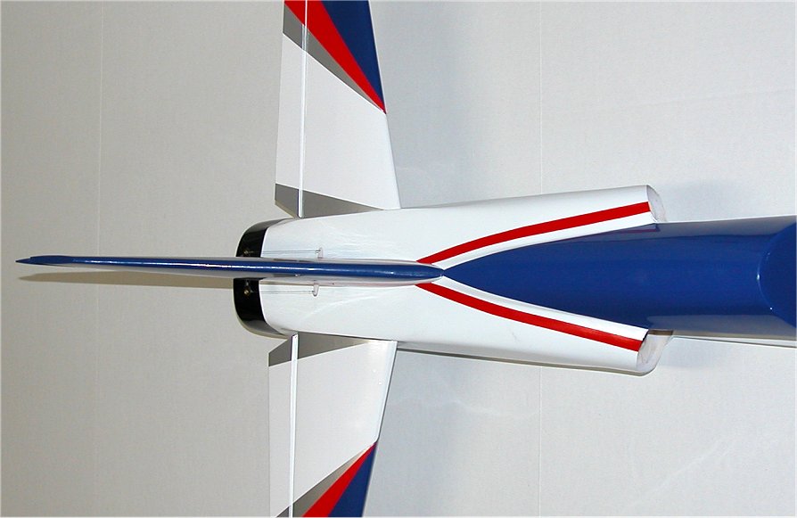

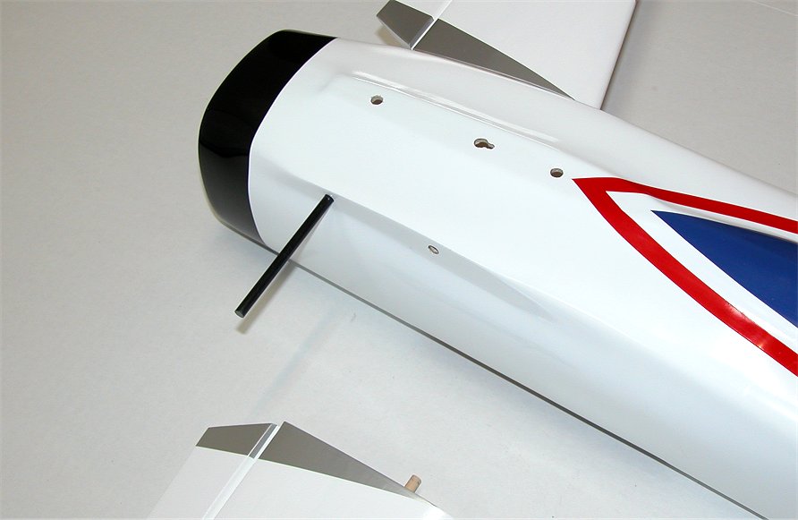

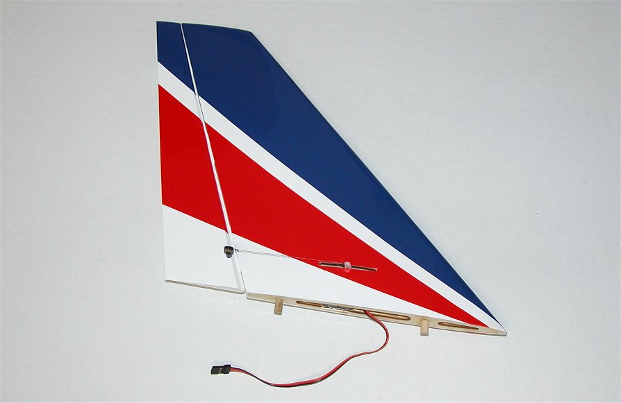

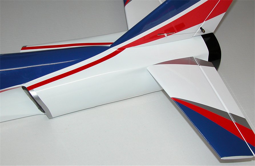

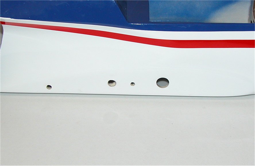

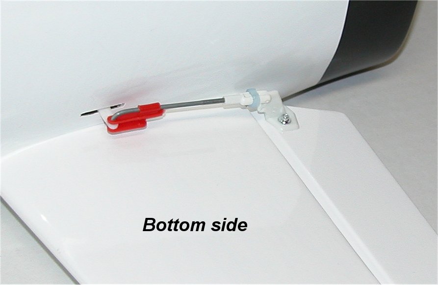

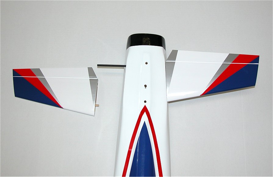

The horizontal stabilizer is mounted on the stock carbon rod and wooden alignment tabs. I deviated from the stock setup that uses long control rods from the elevators to the servos in the main cabin area. I decided to mount the E-flite S75 sub-micro servos to the wood support spars inside the fuselage and cut slots for the arms to protrude through the fiberglass wall.
In this manner, the linkage can be installed below the stabilizer with short control rods to the elevator. I used my own control rod, clevis, and keepers.

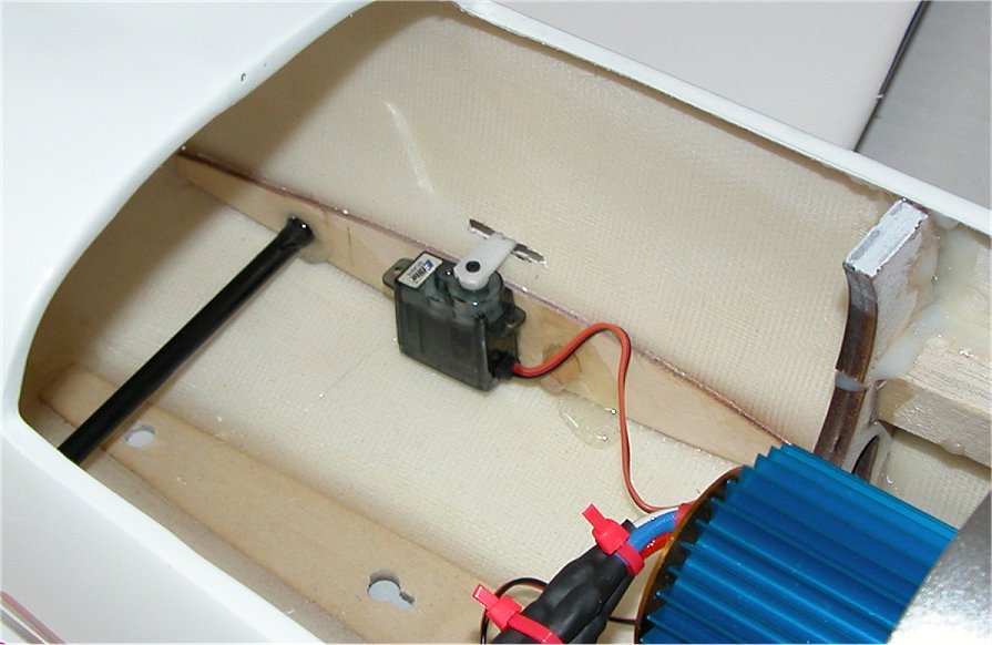

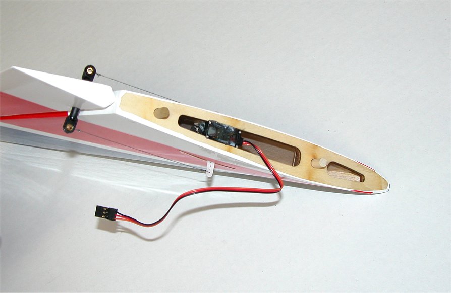

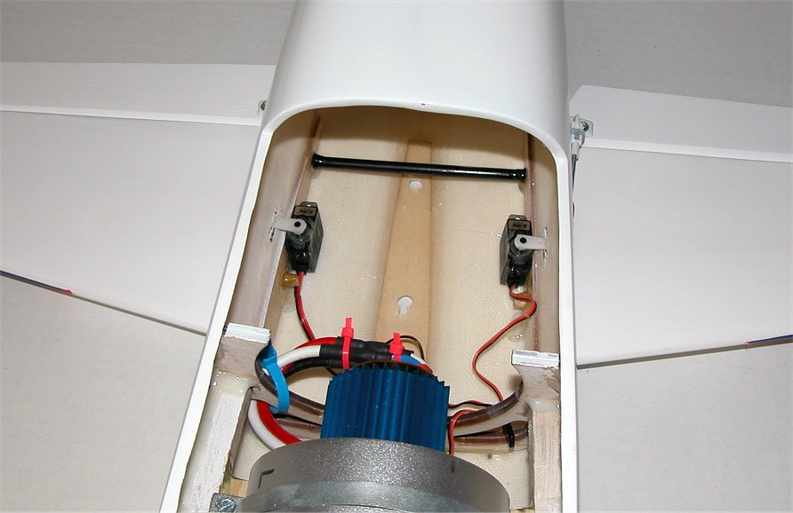

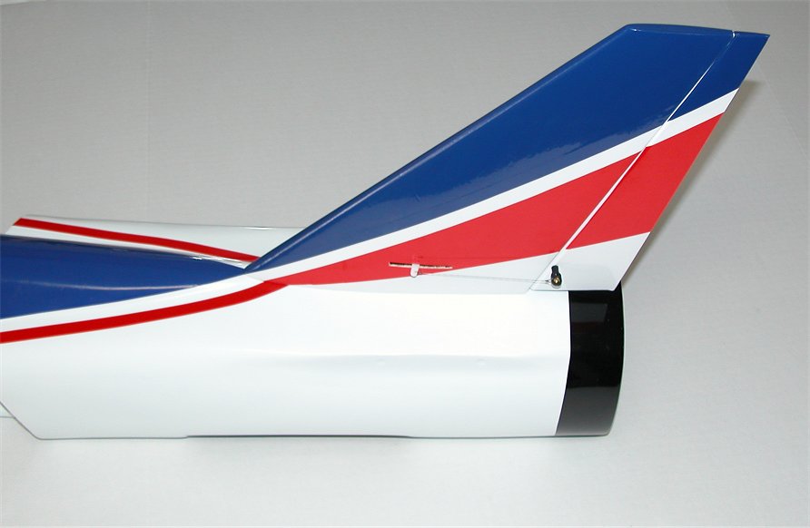

For a clean looking vertical stabilizer, I mounted the S75 servo right inside the stab. This required a slight cutting of the bottom stab opening and a small balsa wedge to hold the servo in place.
The pull-pull elevator linkage is connected with short runs of Firewire fishing line to the Du-bro 2-56 Swivel Ball Links and a Sullivan 2-56 Steel Stud that runs through the rudder.

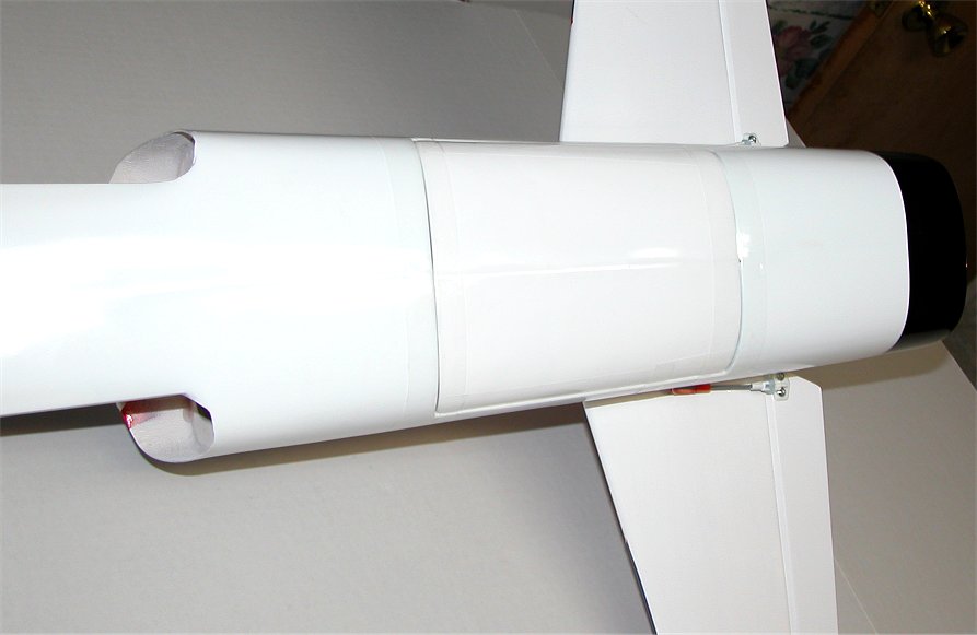

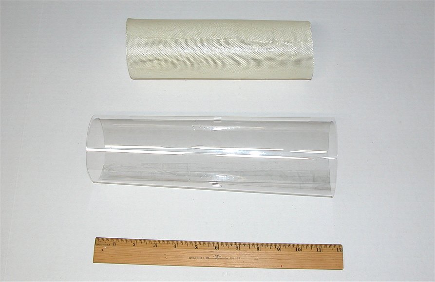

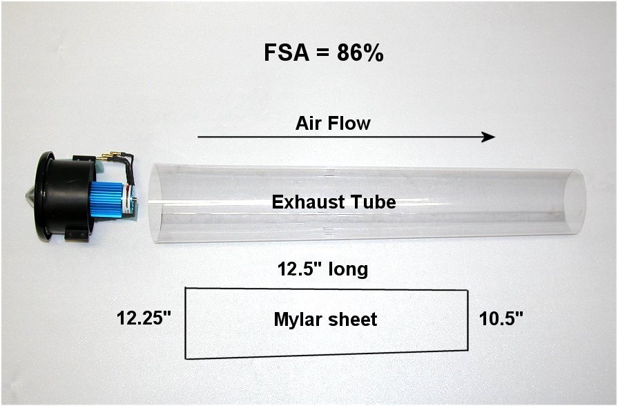

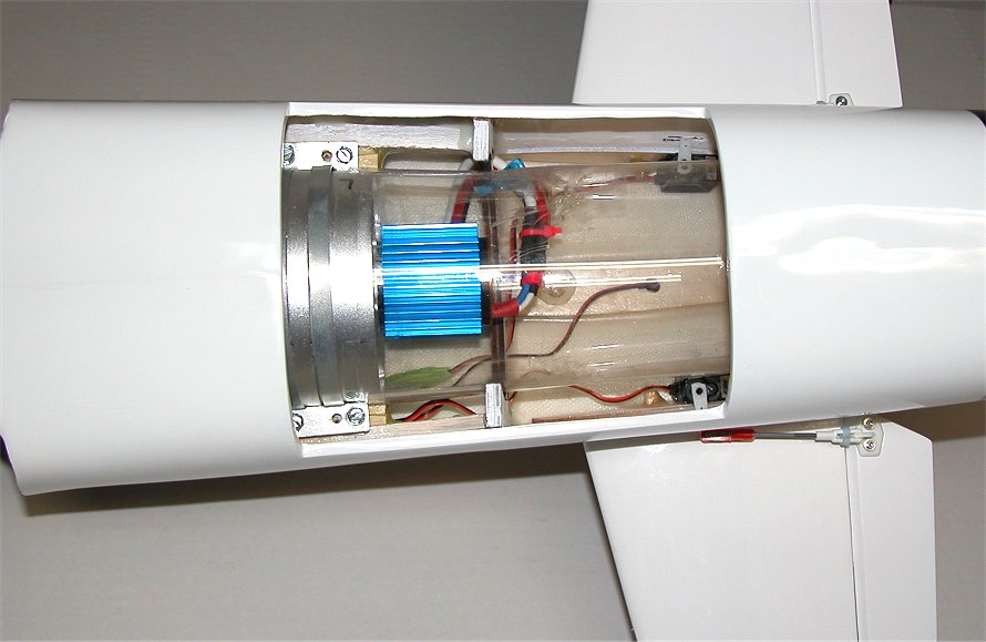

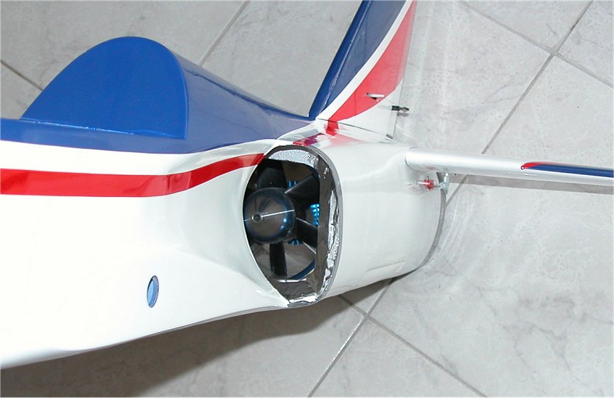

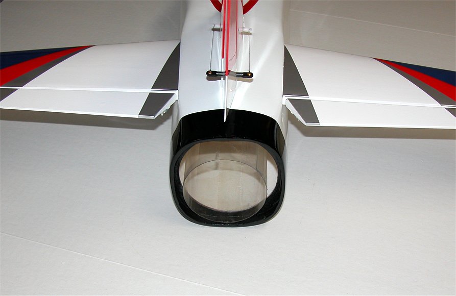

I replaced the stock fiberglass roll with my own Mylar for the thrust tube as it was a little short for where I mounted my Lander DF. I may use the fiberglass roll to smooth out the air intake area when I clean up the intake ducting.
My normal FSA was used from other projects as it is a good compromise between thrust and speed. The tube length of 12-1/2" was used to allow it to exit the tail. After taping the thrust tube to the DF, I sealed the opening for the motor wires with some Plumber's GOOP.
I added some black paint to the rear former to enhance the look.
The bottom hatch was held in place with some clear 3M Scotchcal strips.
I have used the S75 servos in other E-flite fiberglass EDF applications that fly around 100mph. It's a fair compromise between cost, weight, and torque.
When mounting the servos in the tail, weight is a key issue. The control surface doesn't need much throw so you can take advantage of mechanical gain on the linkage.

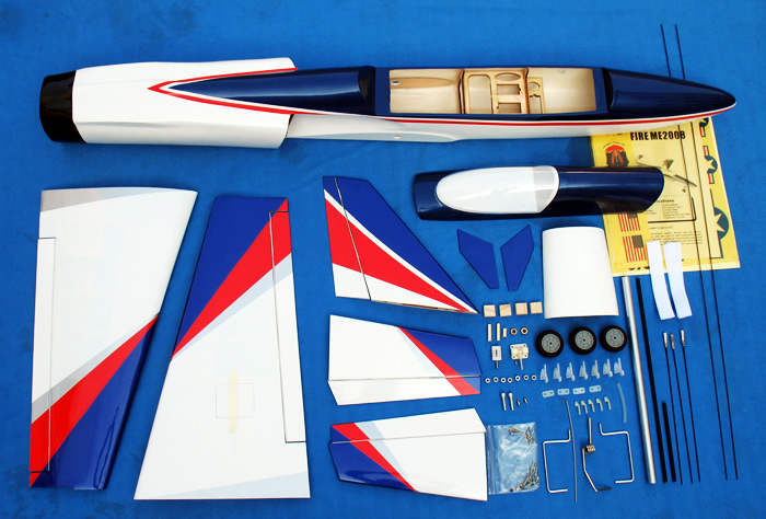

Hey Greg, couple questions. Did you have to pretty much re-epoxy every piece of ply and balsa in the fuselage? Mine was put together with some tacky type adhesive from the factory. I can actually pull each piece out. I think this is a good thing so I can line everything up nice and make room for the lipos with no cutting. Looks like the fuselage is mis-shapen in areas too. For example, the sides of the canopy are not flush with the fuselage. Looks like everything can be fixed by pulling it all out, removing the old adhesive and using good stuff and then clamping it all, but wanted to get your take on this. Also. the bottom hatch does not fit. Bottom side of fuse in rear is kind of smooshed, but I think I can fix it.
Is this what I should expect from NP? This is my 1st order from them or does this sound like I should pursue a replacement fuse?? From the pictures, your appears to be in pretty good shape.
Also, mine came with mylar and not a fiberglass thrust tube.

Hi Doug,
My model was actually purchased from General Hobby through Richard Yan on the RCU Marketplace for about $125 plus shipping. It may be that the Nitro Planes version is made from a different factory after the initial batch sold out. I have seen this issue before with my larger Cessna Citation. I would call or e-mail Nitro Planes about your issues because they seem very good at making things right. As for a $100 fiberglass model, you should anticipate some issues but I have only seen them in the support hardware. Overall, my two Starfires were very good quality. I decided I didn't need the second one for spares so I sold it to a friend.
Let us know how you make out...

I emailed them and posted in their support forum so we'll see how it goes. I'm not going to return the fuse since I'm not confident the next will be any better. I read another thread where someone else had the same issue, but just sent the whole thing back. I sent and posted pics for them and have asked that they just send another fuse. If they don't, I will deal with it. I have all but one former out of the fuse so I can modify. I think that will be necessary to fit the lipos nicely up front. One problem is removing the tacky adhesive they used. Its really a mess.
Removing the guts also allows me easy access to the inside of the fuse to glass, eopxy, and sand any sloppy glass work. Lemonade from lemons!! Let's just hope they send a replacement.

Kudos to Nitroplanes who put a replacement fuse in the mail today. Should be here on Friday. I just hope it has better glue in it this time and that the cuts were made better. The cutouts were poor including the intakes.
Doug,
Sounds good. Let us know how the new fuse looks. In general, I check each former on these planes but my Starfires have been assembled well. I will typically add epoxy to key areas on these planes like the DF mounts and battery bay area.

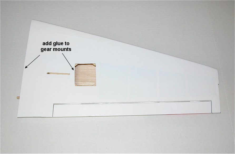

It has been reported that many of these Starfires need extra glue on the gear mounts in the wing so be sure to cut away some of the covering to glue them properly. I haven't started my wings yet because I'm working on some crude intake ducting to improve the air flow. I didn't like the way the air would hit the formers on its way to the DF.

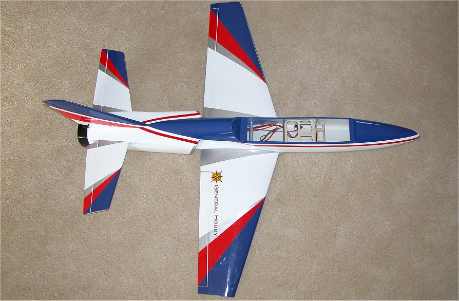

Heads up that I received fuse #2. Its in worse shape than the 1st. I will just deal with what I have. Just want those to be aware if they are ordering this particular airframe from NP. I still feel that its a pretty good deal for $121....unless I'm off my rocker!
Doug,
That's too bad that the batch of Starfires from Nitro Planes appears to be different than the ones from General Hobby. On the positive side, Nitro sent you another one of what they had which is consistent with their good service.
I checked the RCU Marketplace and Richard Yan still sells the [link=http://www.rcuniverse.com/market/item.cfm?itemId=729786]Starfires here[/link] for about $130.
Check your fuselage with my photos to see how things compare. I would say it is an excellent value to buy a 90mm fiberglass model for only $100, even if the formers are loose. My external finish was very nice so I just have fun with the rest of it.

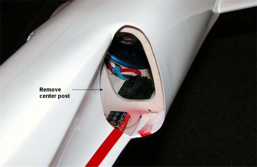

I removed the center post of the intake former since I beefed up the surrounding area with angle stock and epoxy. I didn't spend much time smoothing it out but the air is now guided to the center opening instead of hitting the flat former. A little silver paint to cover the wood and some 3M strip tape seemed to match the stock covering well.

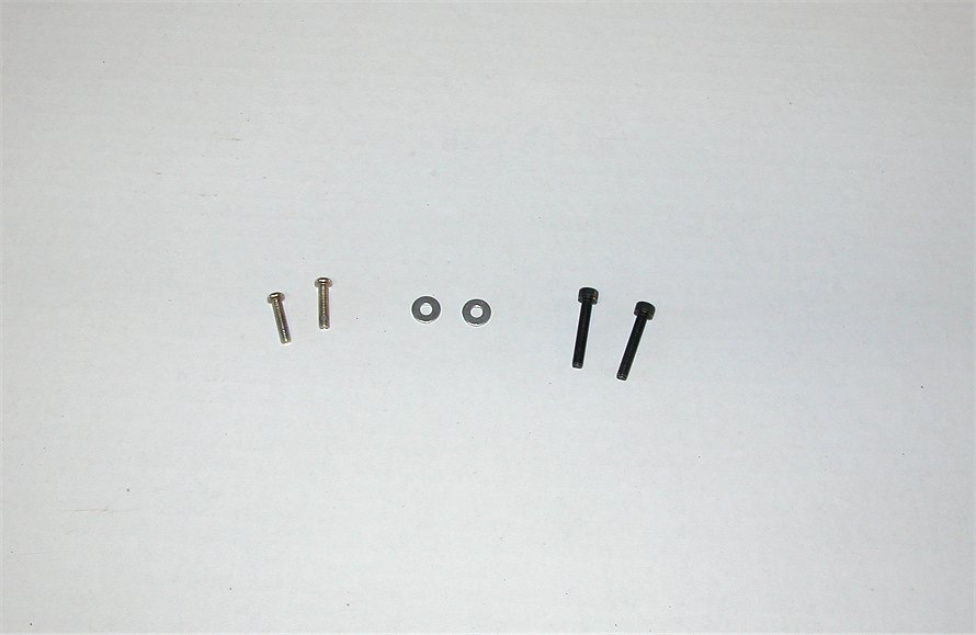

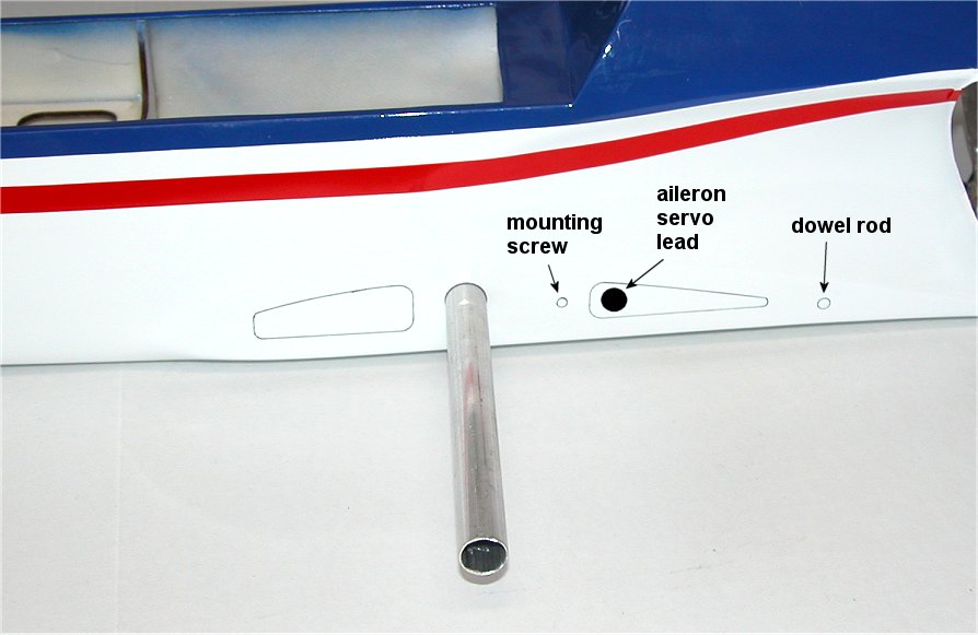

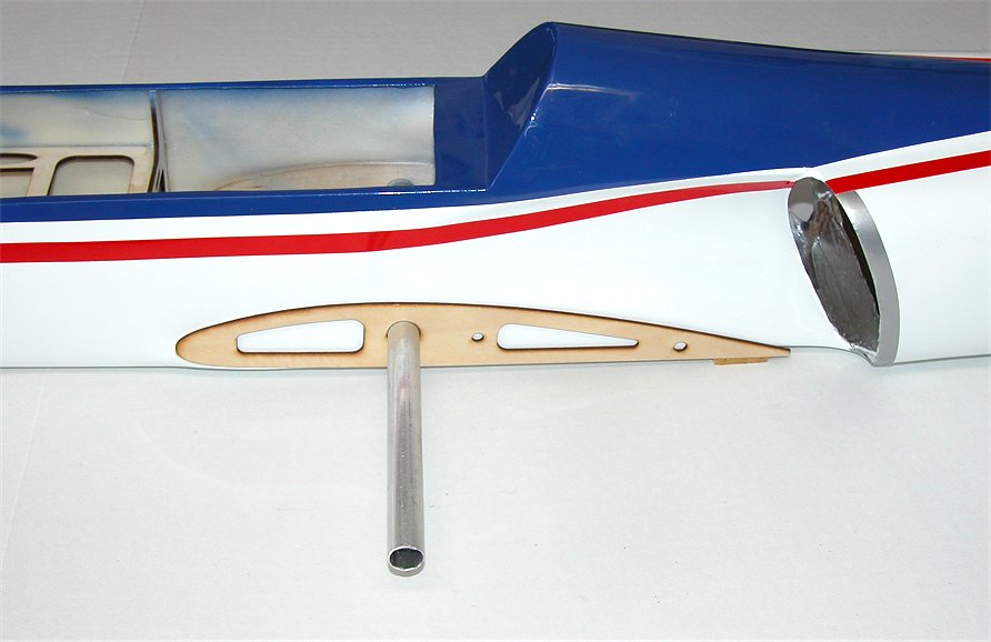

A spare wing spar is supplied to mark the position of the holes for the alignment dowel and holding screw. For some reason, only the main wing tube hole comes pre-drilled. One extra hole needs to be drilled large enough for the aileron servo lead. By using a water-based marker, you can easily wipe off the outlines when finished. Once I had the wing halves fitted to the fuselage, I started working on the gear mains.
I replaced the stock screws that secure the wing to the fuselage with some equivalent metric hex head screws so it is easier to tighten with a small Allen wrench. The wing comes with the wooden alignment dowel and T-nut anchor pre-installed.
When you cut away the covering for the aileron servo plate, it also allows access to the other side of the gear mounting blocks. I added epoxy to both sides of the mount.

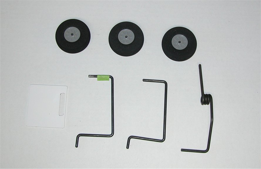

I discovered that some very well made struts I bought a few years ago at an R/C auction will work perfectly on the Starfire. The stock wheels spin nicely on the axles and the stock gear wires fit snugly into the strut. The struts are SS-1 OY (Offset Yoke) from Impact Engineering in Arlington Texas. They are meant for 5lb to 8lb planes.
The funny thing is that the guy who sold me the struts is also building a Starfire so I better install them quickly!
