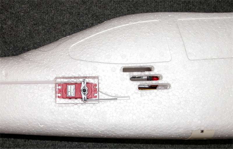

A look around the fuselage shows pre-installed servos with added linkage for nose steering. A big front hatch secured by a screw on each side but is easily removed by pulling up the rubber latch. The power system uses a preinstalled geared Speed 680 motor. The 8-cell 1900mAh NiCd pack and big 64" wingspan allow this trainer to be used in some wind.

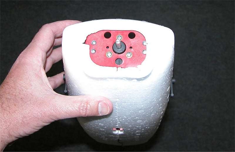

Once the hatch is removed, the pre-installed receiver, motor mount, and cable assembly show a high level of integration in the design of the Magister. One end of the speed controller cable is connected to the motor and the other end (not shown) connects to the battery so you can recharge the Magister by simply removing the hatch.

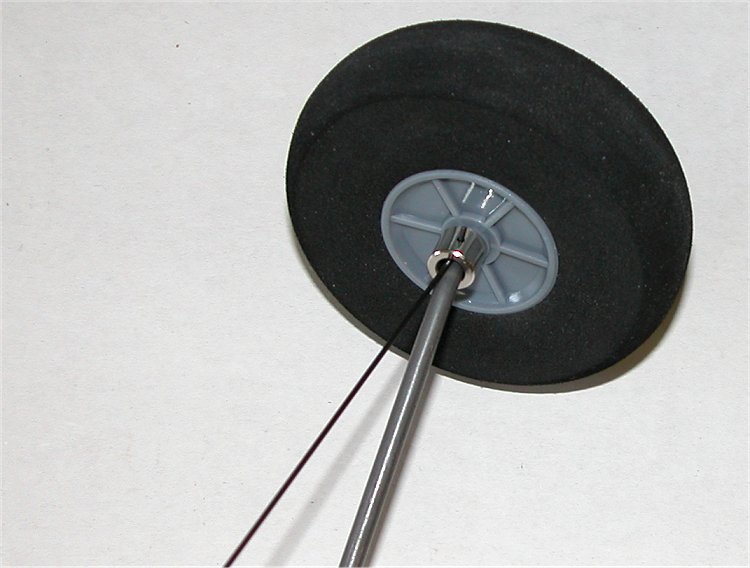

Speaking of the tricycle gear, the first step in assembly is to mount the wheels on the gear mains and steerable nose leg. A stabilizer wire is connected between the gear mains for extra shock absorption on those not so smooth landings. I used Locktite on all the wheel collar hex screws.

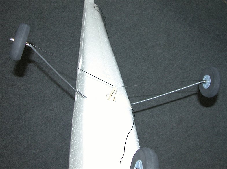

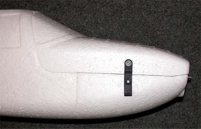

The gear mains are inserted into a pre-drilled hardwood block in the pre-mounted undercarriage retainer strap and the cover is held in place with four screws. Note that the thick rubber band significantly reduces bounce on landings.
The noseleg assembly is held in place with several collars and the pre-installed linkage hooked up for steering.

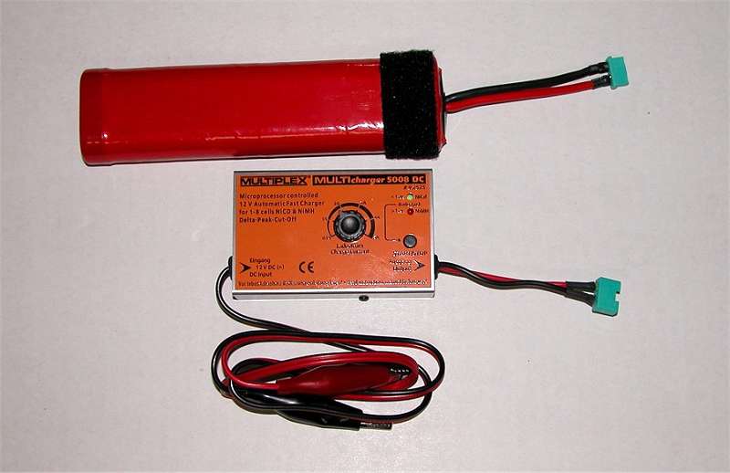

I decided it was time to charge tthe NiCd pack. The charger hooks up to a 12v supply and automatically senses either NiCd or NiMH cells which is displayed via LEDs. I set the current for a 1C charge (about 2amps) and the charger beeps when it has peaked the pack.

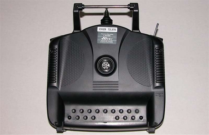

The Magister RTF package comes with a complete Hitec Laser 4 radio system which provides solid control, free of interference or distance limitations. The 8 AA-sized batteries for the transmitter are not included. I found the servo reversing switches in the battery bay along with a mixing switch for V-tail or elevon control. The Laser 4 transmitter also comes with a trainer jack and momemtary toggle switch on the top for using a buddy box. This is a nice feature for a trainer since the experienced pilot can teach a newcomer to fly.
When I tested the Magister control surfaces, all the servo swiches were in the proper setting without the need for any changes.

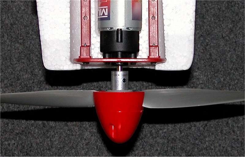

The Magister comes with a prop, adapter, and spinner. The prop hole and spinner backplate must be drilled bigger to allow the adapter to fit through. Once drilled, I mounted the adapter using Locktite on both hex screws.

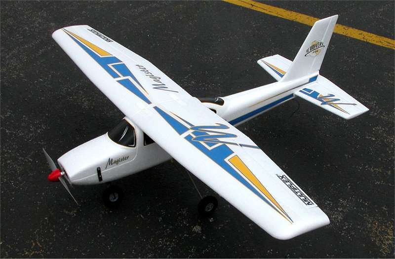

My Multiplex Magister was RTF at 80.5oz (5lbs).
[ul][*] Magister w/o battery = 64oz[*] 8-cell 1900mAh NiCd = 16.5oz
[/ul]

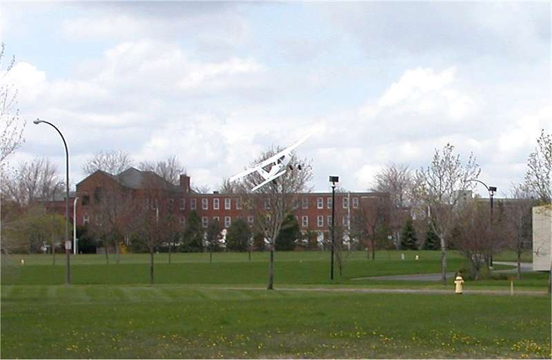

The Magister took off like a dream come true right on the maiden voyage!
Since the front nose gear was a bit low and the plane a bit nose heavy, it took considerable elevator to lift up. I will be raising the nose gear to make the wing incidence parallel with the ground.

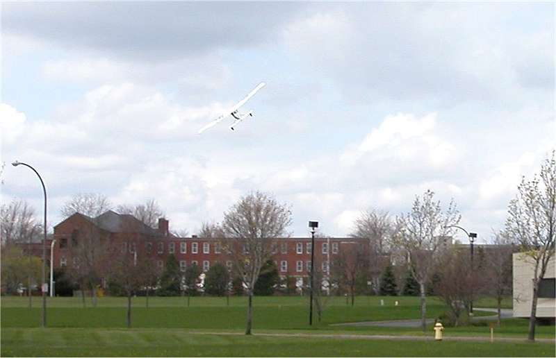

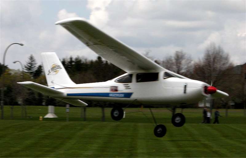

Talk about an in-your-face pass! The 5lb Magister flies with elegance and superb control.

Greg this sounds like a great plane. Is there a trainer port on the transmitter? I am probably not calling it by the correct name, but want to know if an experienced pilot can plug in to help on the first flights.
Thanks in advance.
Old 05-09-2005 | 07:35 PM
Greg Covey's Avatar
Joined: May 2003
Posts: 5,710
From: Rochester, NY
Default RE: Multiplex Magister RTF
Yes, there is a trainer port on the Hitec Laser 4 transmitter. Check out the radio photos up above. I mention the trainer jack and switch which is a great feature to have like you suggested.

Here are the videos of the Multiplex Magister for both pavement and grass takeoffs. It was very windy on the day we took the grass takeoff video. The winds gusted from 5-15mph.
[link=http://www.gregcovey.com/rcu3/Magister1.wmv]Magister - Grass Takeoffs[/link] (9.1meg)
[link=http://www.gregcovey.com/rcu3/Magister2.wmv]Magister - Pavement Takeoffs[/link] (4.4meg)
