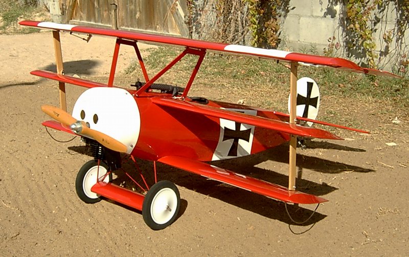

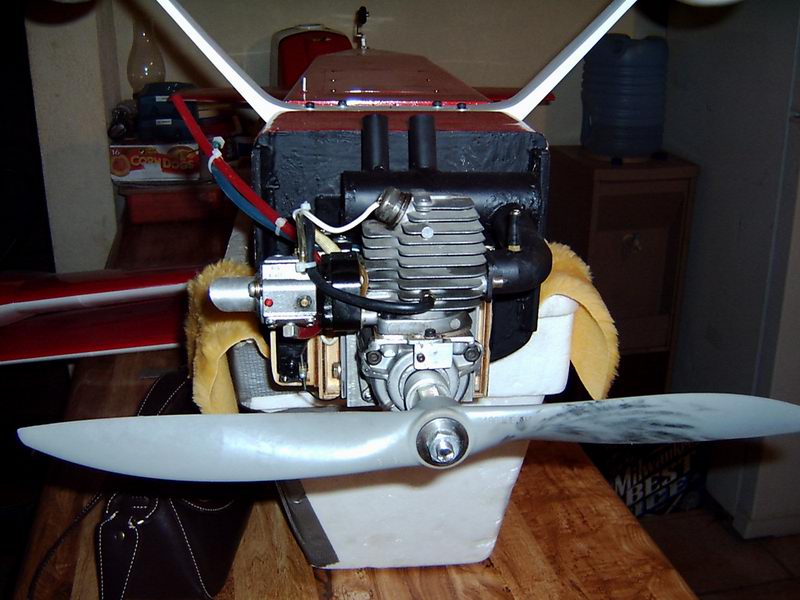

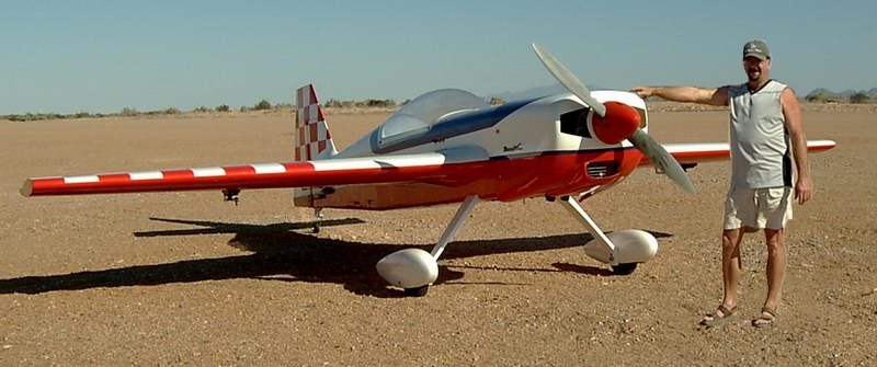

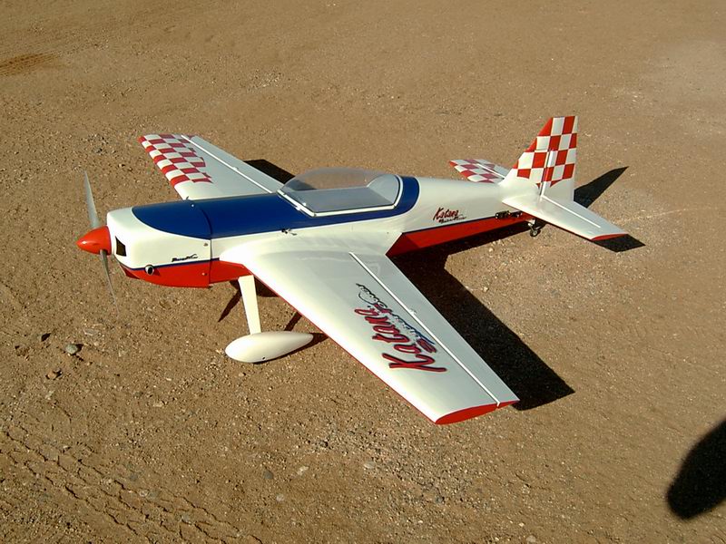

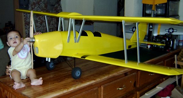

Old 10-17-2006 | 02:31 AM
  #918
av8tor1977's Avatar
Joined: May 2003
Posts: 7,245
Received 6 Likes on 5 Posts
From: Tucson, AZ
Default RE: gas fuel with glo plug no ignition
Here's a few.... 1/4 scale Fokker Triplane with Kioritz 23.6cc, Katana 1.40 with Kioritz 23.6cc, 80" wingspan Tiger Moth with Ryobi 31, and a Giant Big Stik with a Poulan 42cc. All on "Gas/Glow", and all work great!
AV8TOR

Old 10-18-2006 | 02:20 AM
  #919
Joined: Jun 2006
Posts: 102
From: Tuckerman, AR
Now that is cool[8D]. How does the kantana Fly? I was thinking about putting a Echo 25cc on the Show Time. I believe I can mount it with no problems. I am still working on the giles 202. I just get to busy with other projects.
Old 10-18-2006 | 02:49 AM
  #920
av8tor1977's Avatar
Joined: May 2003
Posts: 7,245
From: Tucson, AZ
The Katana flies super and I love it. That Echo/Kioritz 23.6cc engine is all hopped up and turns an APC 16 x 8 prop at over 9000 rpms. I don't do 3D, but the vertical with it is basically unlimited. The Echo engines are a real good choice for the smaller planes, because they are light and powerful. I don't even use a backplate with them. I just put studs in the holes in the back of the engine, and the studs go through the firewall with washers and nuts on back. It's a little tough to get at the nuts on some planes, but usually possible. I did use aluminum angles to mount the Echo on the Katana however, to get it far enough forward without having a long prop adapter. I thought the aluminum angle mounts looked heavy once I had them done, but when I weighed them they were a few ounces lighter than the regular motor mounts that came with the plane!
AV8TOR
Old 10-18-2006 | 03:04 AM
  #921
av8tor1977's Avatar
Joined: May 2003
Posts: 7,245
From: Tucson, AZ
Here's a fun pic of that Katana....
AV8TOR
