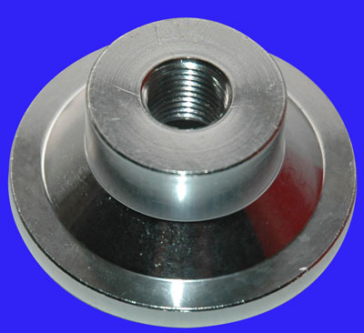

Getting back to gas to glow. I've looked, (only briefly I will admit) to find any reference to compression ratio when going from gas to glow. My understanding is that increasing compression ratio without altering port timing can yield good results.
From, http://www.oneillbrothersracing.com/...ption/dome.htm
We have their product, a "dome", a bolt on insert head that's available with the following ratios.
This is a removable dome for the CY 27cc and 29cc head kit motors.
11:1 Dome- 87 octane or higher
12:1 Dome- 89 octane or higher
13:1 Dome - 92 octane or higher
14:1 Dome - 95 octane or higher
15:1 Dome - 105 octane or higher
16:1 Dome - 112 octane or higher
17:1 Dome - 116 octane or higher
18:1 Dome - 120 octane / alcohol
19:1 Dome - Alcohol
It appears that any gas to glow conversion would benefit from increased compression ratio. And octane rating affects optimum compression ratio. Wonder if this might shed light on some of the experiences related on this thread.
Comments?

That's encouraging. Looks like the CR for glow is about the same for gas. I note though, with a little research that an ethanol gas (E85 for your car) raises the octane rating. That doesn't mean more power, just the reduced chance of detonation. E85 with premium gas is said to have an octane rating of 105.
So when we go to a gas glow mix, especially in the proportions recommend, we are REALLY boosting the octane rating. But how much? This, to me implies that we should be going to a higher compression ratio when converting to a heavy gas/glow mix. However, this is compensated for by the presence of the glow plug and methanol, I presume.
The catalytic effect of the glow on the methanol does it;s job and ignites the methanol, then the gas at the same timing as pure glow fuel. Somehow it works as we've seen here many times.
The reason for this line of enquiry is that I'm at the stage of making the heads for the Tanaka. Tanaka advised that the stock engine had a 7.5/1 compression ratio and that's about in line with most. And, research shows that that matches about what glow engines use.
THEN I stumbled on the O'Neill Brothers website and was surprised at the CRs they list. Much higher. They also seem to have some real kick butt engines in their line which seem to operate at those CRs just fine. And look, Zenoah upgrades.
Has anyone ventured to do a gasser conversion using one of their engines? I'm especially intrigued with their bolt on heads and "stuffed" cranks. And look, a bolt on reed kit with carbon reeds. And they offer ported, polished and timed engines done by hand. Too much. Gonna call them tomorrow.

Those are good questions. I'm inclined to think that if one could play with compression ratio and port timing independently, one might be surprised at the gains with a gas/glow mix. With my modified Tanaka, I can do that easily by shaving the base of the CASE by two or three gaskets and then add or delete them to tweak port timing and then compensate for and or tweak the compression ratio with shims under the bolt on head.
I had to butcher the Tanaka to do this, not something most can do but the O'Neill engines are done, right out of the box.
So far, at 7K on an 18 X 6 Zinger, the Tanaka, in its stock form is under the Zenoah. I hope to get it to at least 8K but it sure does sound sweet as it is. What a roar. These old ears have been enduring 19 to 22K for too long, I think. [:@]

I have to admit I have never actually measured the compression ratio on any of my engines. All I do is cut out the squish band, if any, and then lower the cylinder to get a nominal piston to head clearance of .015 to .020".
Two things though... A small bore engine can tolerate a bit more compression before getting into detonation. Also, there are two ways to measure compression ratio with two strokes. One is full stroke, as is done with four stroke engines. The other is "effective compression ratio" which is measure from exhaust port closing; not full stroke. The two methods will give you very different numbers obviously. I am rather sure the numbers you quoted from O'Neils are full stroke compression ratios.
Also, E-85 will not work for our use, as it is made with ethanol, not methanol. Methanol is necessary for the catalytic reaction with the glow plug.

I'm still in RC glow mode, I guess. [:@] Yes, the Oneill heads take a sparkplug for spark ignition. This thread is not about that at all. Sorry guys. New here.
What threw me was the referrence to alcohol in the last two heads. But that would still be on ignition, of course.
In any case, it looks like gas or alcohol, both respond to about the same CR.
