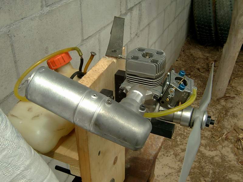

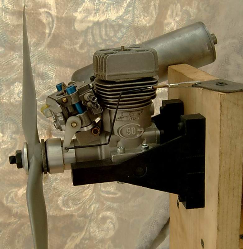

Here's a new option in our Gas/Glow endeavors; a Super Tiger .90. It is being offered converted for gasoline use by Keith at BME engines. However, I decided to run mine on Gas/Glow.
It runs great!! However, it comes supplied with a ZAMA carb that I had troubles with regarding the Gas/Glow fuel. The engine ran excellently at first, but after a day or two exposed to the Gas/Glow fuel, I started having problems. I tore down the carb and found the fuel pump diaphragm severely distorted. I tried another diaphragm with the same results. These were clear plastic diaphragms. Keith says he has run ZAMA carbs on glow fuel without problems in the past, but perhaps there has been a change in the diaphragm material.
Anyway, it took a touch of grinding here and there but I put a Walbro carb on it, (the Walbro is physically larger than the ZAMA), and now after several days and many runs, no more problems and it runs really great! Nice slow idle, easy starting and handling. It turns an APC 13 x 6 at over 11,600 rpms.
I've not had any problems with the Gas/Glow mix on any of the different types of diaphragms that come with the Walbros, but watch out for those ZAMA carbs when using this system.
I'm really pleased with the BME Super Tiger .90 though, and recommend it!
Here's some pics...
As an interesting side note, even though this engine is only 15cc, it comes with an 11mm venturi. No problems with transition, etc. nor any other signs of being "over-carbureted". It handles like a *****cat.
AV8TOR

Default RE: gas fuel with glo plug no ignition
Besides the carb, what changes were made?
Old 04-05-2007 | 05:28 PM
  #1204
av8tor1977's Avatar
Joined: May 2003
Posts: 7,245
Received 6 Likes on 5 Posts
From: Tucson, AZ
I didn't take it apart to check, but I believe he puts roller bearings on the con rod wrist pin and crank pin, makes the adapter for the carb, etc.
Sure handles nicely. It's got me thinking about a 2300 or 3250 Super Tiger on Gas/Glow.
Keith might see this and jump in here...
AV8TOR

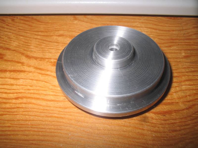

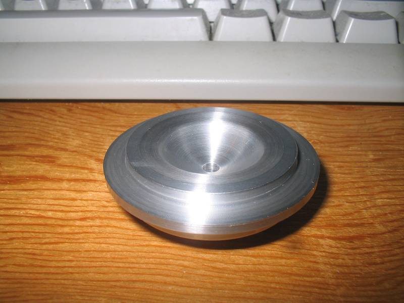

After some consternation over how much combustion chamber volume I should put into the glow head I was making and making a pest of myself by being lazy, I went back to the beginning and started reading. Three hours later, (its 2 AM here) and only at page 15, I started to skip ahead. At page 39, I found much appreciated info from Ringwinger and others. Thanks guys, it was all there.
Then I come here to post my thanks and MORE good info. Thanks Will and AV8tor.
Pictured is the result. Using EFFECTIVE CR, I've done it up a shade overcompressed at 13:1. I was concerned over losing the benefits of squish band but it appears that it's not that important. So, I'm overcompressed to start but I won't start there. I've made up multiple shims of aluminum in various thicknesses and will use them to affect a much undercompressed condition. Based on all the good info on this thread as to what to expect, I'll be running the engine on various fuel mixes, glow lit, not lit and varying the compression ratio to see what we can learn. I'll pass on anything I come across of interest. I suspect though, that I'll just be confirming much of the great research that's already been done.
Many thanks to all,,, hey it's been over three years.
But Global Warming has become a fickle mistress. Two days ago, we had zero snow on the ground with temps in the mid 60s. Yesterday, we got dumped on to the tune of 18 inches and temps are 10 below with wind chill down to 20 below. Not gonna run this engine again for a while it seems.
