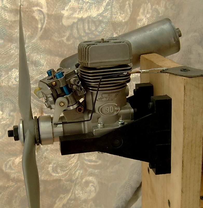

Old 05-23-2007 | 11:54 PM
  #1393
av8tor1977's Avatar
Joined: May 2003
Posts: 7,245
Received 6 Likes on 5 Posts
From: Tucson, AZ
Default RE: gas fuel with glo plug no ignition
KI8FR
Here is a picture of my Super Tiger .90 on Gas/Glow. It runs great! But it has been modified with roller bearings on the rod so that it can run on the low oil content. That's the trick with the smaller engines; without mods they can't run low oil mixes.
AV8TOR

AV8TOR---
what size carb is that on the .90, and did you use a needle bearing directly on the crankpin or a bearing with an internal race? That looks like a good engine for my next project.

  #1396
av8tor1977's Avatar
Joined: May 2003
Posts: 7,245
From: Tucson, AZ
Mine is one of the BME modified Super Tiger .90 engines, so I don't know what all he does inside. (I didn't take it apart.) I know you can't run a needle bearing directly on the crankpin though, as it isn't hard enough.
It's an 11mm Walbro carb on it. It came with a Zama, but I had trouble with two different diaphragms in the Zama swelling up in the Gas/Glow fuel. I've never encountered this with the various types of Walbro diaphragms. So I switched to a Walbro carb and no more problems.
The Walbros are physically slightly larger however, and I had to do a little grinding here and there to get it to fit. Runs great on Gas/Glow. 11,700 rpms on a 13 x 6. I put it on my Twist 60 and it's a rocket!!
AV8TOR
