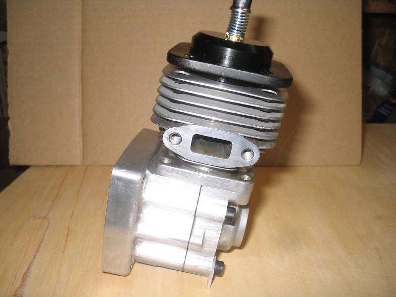

Here's a thought. The head I'm making is round and has a seperate clamp affair to secure it to the cylinder. This will allow installing the glow plug off center. This allows you to orient the plug at different locations. As in closer to the incoming charge as opposed to closer to the exhaust side. Any value in trying this?
Pictured is the head in its dieselized form.

Putting the plug closer to the incoming intake charge might cause problems with the plug getting cooled off and "doused", especially at idle when the plug is having a harder time keeping hot, or at "idle up", (transition), when sometimes a blast of rich fuel is shot through the transfers if the idle is a touch rich.
I don't see how two (or more) plugs could be used to vary timing. The hotter plug is always going to set off the mixture first....
I think the most productive experiments (with glow plugs) would just be to test various heat range plugs, and see which one a given engine, load, fuel, & atmospheric condition combination likes.... It's going to be different every time one of those variables changes.
AV8TOR
AV8TOR

AV8TOR,
Good point. But I wonder if location AND manipulation of heat range might not yield useful data. Say you're right that the incoming charge tends to cool off the plug at the intake position. So, you use the hotest plug you can find.
Or, alternately, positioned at the exhaust side, use the coldest plug you can get.
Mix and match differing positions and plug heat ranges. What might that reveal,, if anything?
In any case, a couple of hours work and nothing ventured till you try etc. Neat.
