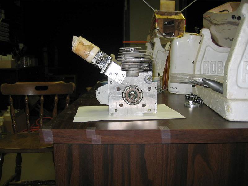

I have a 069 Stihl saw engine that has been flown in a 35# airplane with magneto ignition. My understanding is that it is a 69cc engine. Less muffler and coil it is over five pounds (over postal scale limit). Should I weight it at work tomorrow?

I thought the performance was superb considering the weight of the airplane. We cut too much material from of the coil mounting bracket and eventually destroyed two coils (high speed resonance of the coil and mounting bracket). Will weigh it and take a picture.

Don’t know. Cast in number on the cylinder is 1119. The local Stihl dealer who was then an avid flyer handed it to me one day and said fly it. I made the carb bracket and mounting plate.
Here are a few pictures.

The engine is 5.8# with coil, without spark plug and without prop. If the size is known please let me know.
