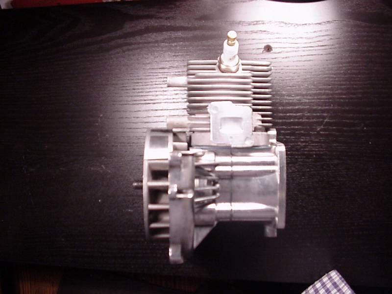

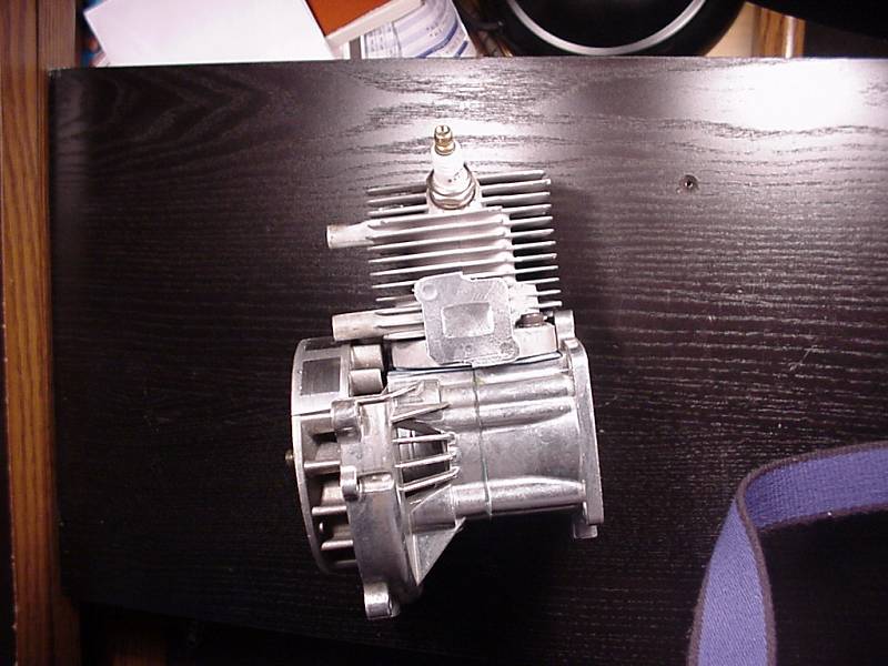

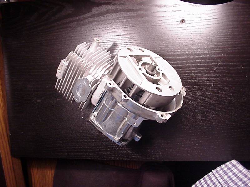

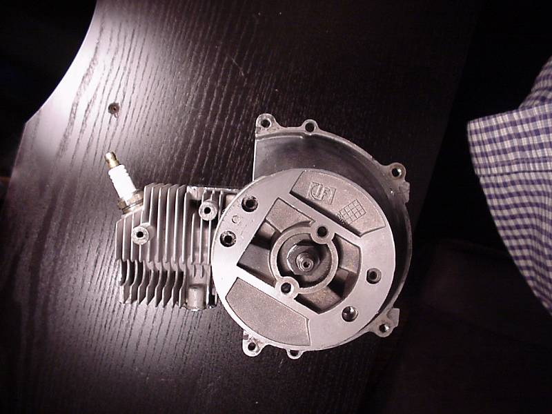

Hi captinjohn.

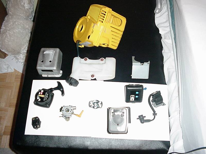

Idownloaded the Picasa2 and try to import some pics to this post. I still haven't had enough practice, as you can see I duplicated some of the pics. The model # is9017-MD0110 S/N 411B0900668 made in Taiwan. The fins on the back of the cylinder have been trimmed from the factory. Not like the first ones I saw here like on RCU.

Default RE: WHAT A DEAL
Looks like you got the process down for sure!! You can right click on about any photo online and place it in Picasa. Then you can crop or resize the photo and lots of other neat things. You can click email at bottom and send the photo to a friend...via email. Its neat to send some things to your own email address to view more later and then just delete. Very nice program. Take Care, Capt,n P.S. You might want to EDIT your last post and add the name and model number of your engine!

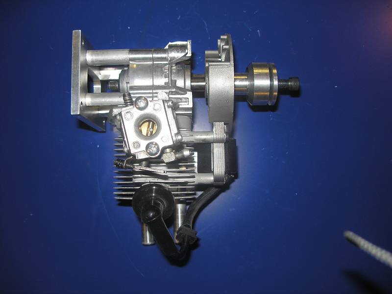

From: Mansfield, TX
Gyrohead
The engine came fully cowled with The tank,carb,muffler, pull starter and ready to install the blower section to the power head.The lable on the engine has no brand name, But it has M25 25cc and a serial #. That is about all the info. I have on it. All thr castings are clean and brite, it turns over smothly and has good compression and spark.
Looking over the engine, it appers that it would take a simple one piece prop hub to bolt to the flywheel like a Zenoah 38. If I do convert it, I will use the magneto ign. to see how it runs out.

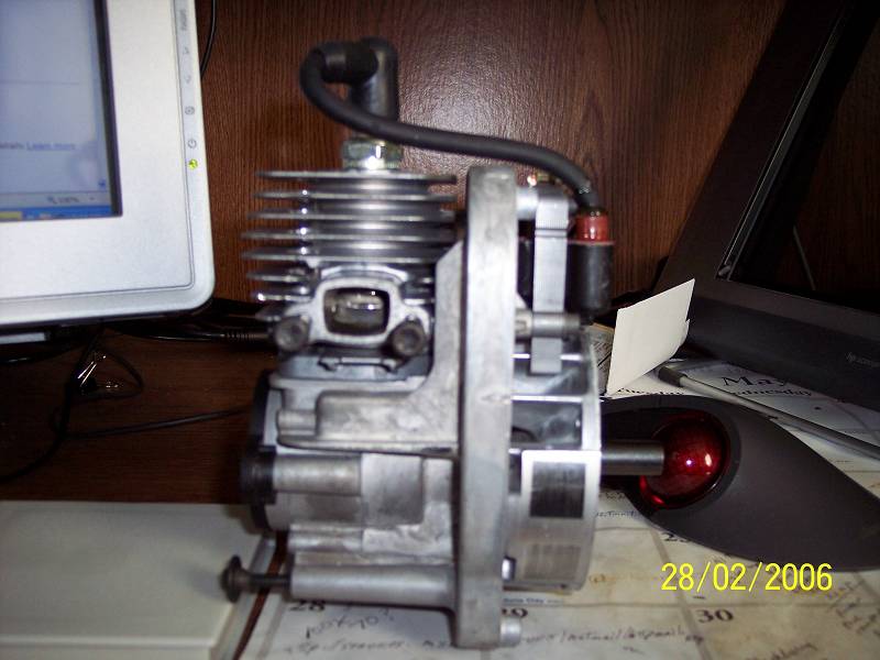

Oldtimers engine is the same one like I bought on Ebay, see the Post "What did I Buy?" on the engine conversion Forum. It looks like the MB290 except the fins are different. It has been determined to be made in Taiwan for McCulluch. It looks exactly like a G23 L17 Industrial (trimmer or blower) engine to me.I got mine finished and it turns a 16X8 prop 8000 rpm, without any fancy mods, just straightforward conversion with an 11mm bore carb. I'm glad oldtimer posted the pictures of his engine before he converted it, I was too impatient.

Talking about mufflers....who made this one in photo? Thanks Capt,n

I have searched the web looking for some one that sold the alum. extrusion that looks like that so I could order some of it to try to make some mufflers. No luck yet but if I do find some I will let you know. Where did you find the picture of the parts?
