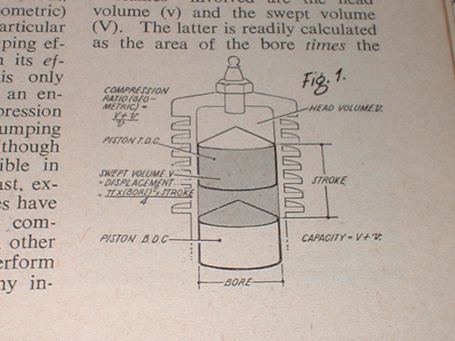

"Compression ratio" has nothing with valves/ports when they are closed, it is wrong to calculate compresion ratio.
See at the picture from "Model Aero Engine Encyclopaedia" 1969..
Jens Eirik

Old 11-28-2004 | 03:43 PM
Joined: Nov 2004
Posts: 84
From: None, NETHERLANDS
Default RE: Calculating compression ratio
Jens,
Thanks for taking the effort to convince me
I'll stick to Bore*Stroke.
Best regards,
Frank

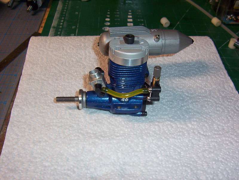

knarf, here is an alternative to your question about the .46 sized conversions, an OS LA .46 with a Davis Conversion Head. I'll copy and paste what I had to say about it when I first got it.
I converted the LA .46 with a Davis Diesel head today and the results are great,
Davis, Oily Mix/ Plane fuel
MasterAirscrew 12x6 three blade 8,800 rock steady, does not wander, still working on the idle 2,500 so far. I'm flying it tomorrow. Throttle up is clean and crisp. I could squeeze about 9,000 rpm out of it but it wanted to hunt between about 8,900 and about 9,050, I reduced the compression slightly and it settled into 8,800 as mentioned above. This was on Davis Oily mix or Plane fuel as he calls it.

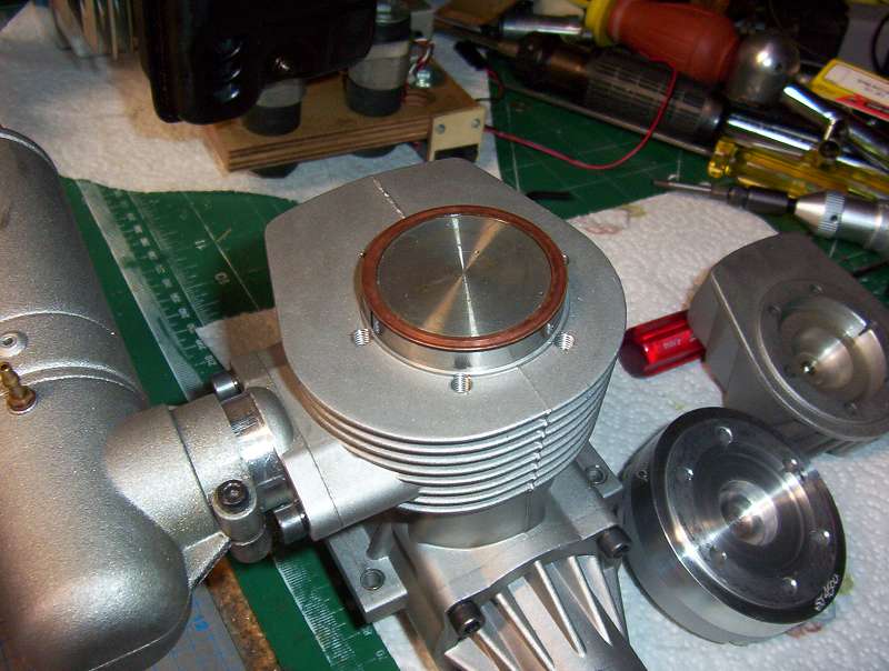

Here is look at the difference between the Davis Diesel head on the left and the stock head on the right for a SuperTigre 4500, the piston comes even with the top of the cylinder with out the gasket. As you can see in picture #2, counting from left to right, the squish band clearance is about 4 times as great in the Davis head as in the stock head. I suspect this was done to give the contra-piston a greater effective range by softening its effect near the bottom of its travel, I don't think its effect on the compression pressure is linear.
I think you're correct on that. In my calculations, the compression increases in bigger steps as the contra is screwed in. For example, if the contra is screwed in 0.1mm from it's "TDP", compression increases with 1,9%. But if the contra is screwed out 0.1mm from "BDC", compression decreases with 6,96% If I theoretically increase the squish band from 0.5mm to 1.00mm, these numbers change to 1,53% and 3,74% successfully.
So it looks as if increasing the squish band decreases the amount the compression can be varied, but on the other side makes it possible to set the compression more precise.
Concerning the right way to calculate compression, I made sure that my contra has enough travel to set the compression between 1 : 14 and 1 : 20, regardless of what way it is measured. That way, if the head itself works, it should be possible to set the compression correctly.
