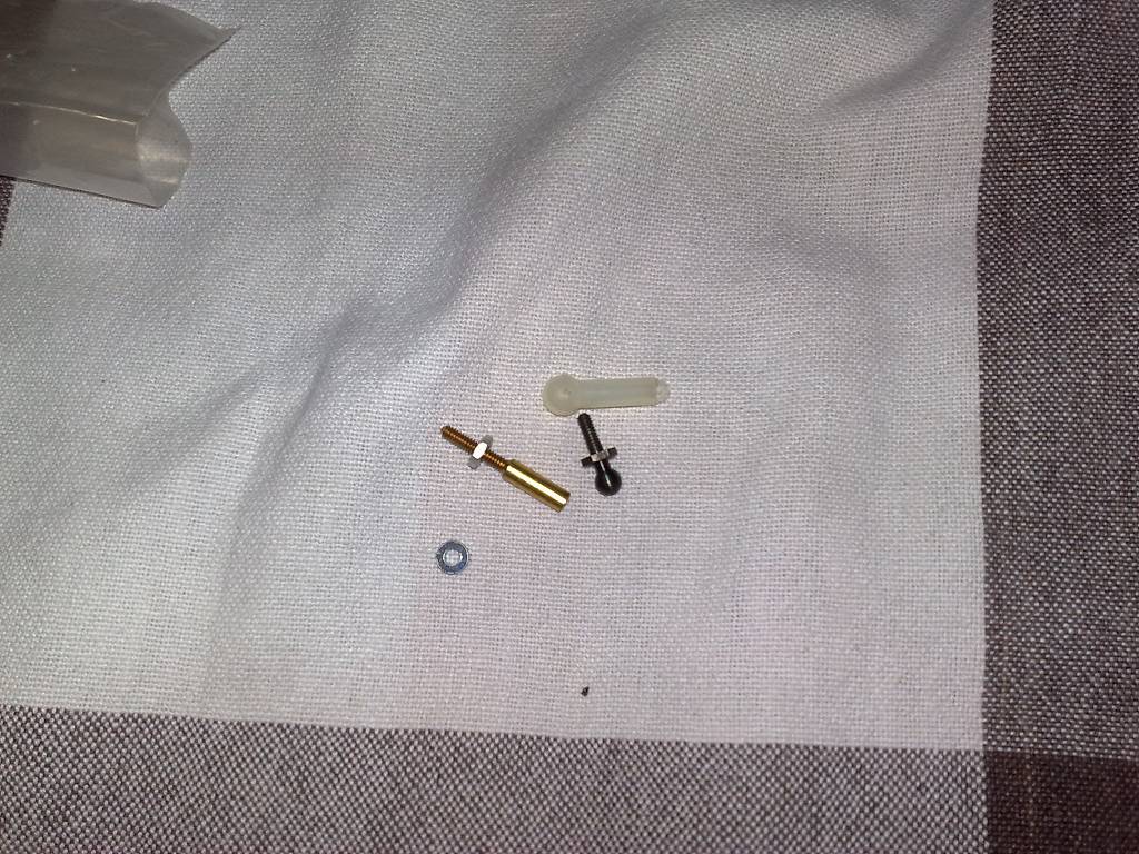

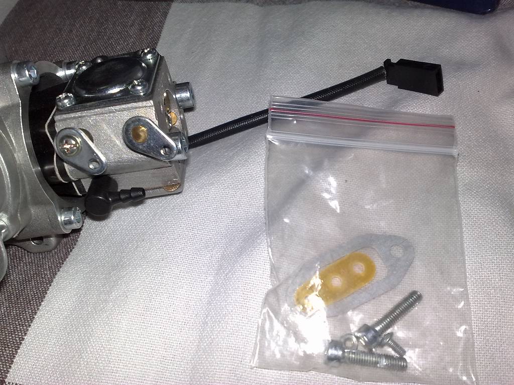

While setting up a DLE 20 on my Phoenix Extra, I have the following issues
I am setting up with a 2-56 pushrod on the throttle. Decided not to go with a nyrod setup simply because its not available right now. Initially I wanted to have ball links both sides to avoid metal to metal contact but the 2-56 Dubro pushrod is one side threaded.
1) I got this Dubro 2-56 ball link locally (see pic). Its snap on type, not bolt thru. I am concerned that if used on the throttle, it could disconnect due to vibration. But guys on the field told me it will be ok. Should I trust it? I dont want the engine cutting off while I am in a hover
2) The engine came with the metal throttle horn installed and a seperate fibre horn in the box. Should I use the metal or fibre horn (or should I mount the fibre horn on the metal horn and use that)? A longer horn will give a slower throttle response but will also require less effort on the servo

The "fibre" horn is supplied to lengthen the throttle horn on the carb and if used your metal to metal problem does not exist!
I use the fibre horn to allow a choke servo to be used. There is very little pressure on a throttle to servo linkage so I do not
see where you would have a problem.

Actually my bigger issue is that the ball link connection (http://www3.towerhobbies.com/cgi-bin...&I=LXD897&P=ML) feels delicate and the EZ connector (http://www3.towerhobbies.com/cgi-bin...&I=LXAHE6&P=ML) method insecure. I am worried that both could come off due to engine vibration
The idea of using the fibre horn to avoid the metal to metal contact is a good one, thanks for that idea, I feel a lot more comfortable with using a metal push rod all through now

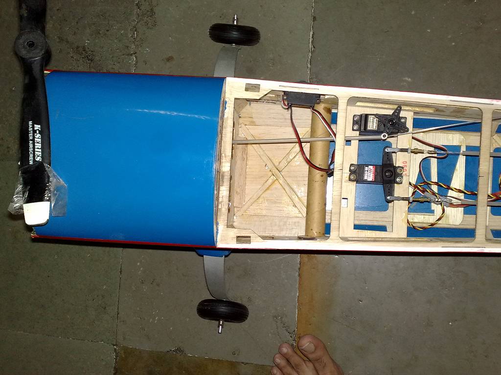

Your making things harder than they need to be.
With tons of room in that fuse, you can easily relocate your throttle servo and shorten up the length of control rod needed;
See all that empty free space just in front of the wing tube?
Create a new mount for your throttle servo, and you'd be reducing the rod length around abouts 4"!
Shorter rod also equals less flexing of it.

No a1pcfixer, I tried that last week. Firstly I need to move the tank all the way back to the wing tube to try and get the CG. Then as you suggested, I would move the throttle servo forward to be flush with the canopy bulkhead. In fact, I even cut the ply that I was going to use. But just under that switch is the hole for the wing bolt. In this airplane, the wing bolt is tightened from inside. So if I move the servo forward, I cant get to the wing bolt. Thats the reason why I had to post for help again

I see a couple of issues here.
First. the length of the throttle horn is important. To get decent "thumb to throttle" response, you are far better off to use 100% of the servo travel for the throttle. This is the reason for the extra arm length. Use the additional arm.
The snap on ball joints are not a good idea for the throttle linkage. There is a high likelihood of failure. Use either a bolt though ball joint or a clevis. If using a clevis, use it on a plastic arm but expect the hole to wear fairly quickly. (My recommendation is to use a bolt through ball joint).
If you can not obtain some rod that is threaded at each end, Can you get a soldered on rod end? Some pull-pull connectors can be used for this as they have a hollow in the end. z-bends and easy connectors tend to get a lot of wear fairly quickly on gasser linkages.
A long metal rod going from the engine to near the receiver can be an issue for radio interference. Have you asked any of your flying buddies if they have a spare nyrod you can borrow until it becomes available?

those were the concerns that led me to post this thread. All the local ball links are either 2mm or 3mm. This pushrod is 2-56. The threads dont match and therefore I cant get a bolt-thru ball link locally. Getting from Tower is just too expensive. Imagine, its $7 shipping on a $5 item and that too through USPS! My next order is not very soon, so I cant get the ball links from Tower and my buddies dont have a nyrod spare.

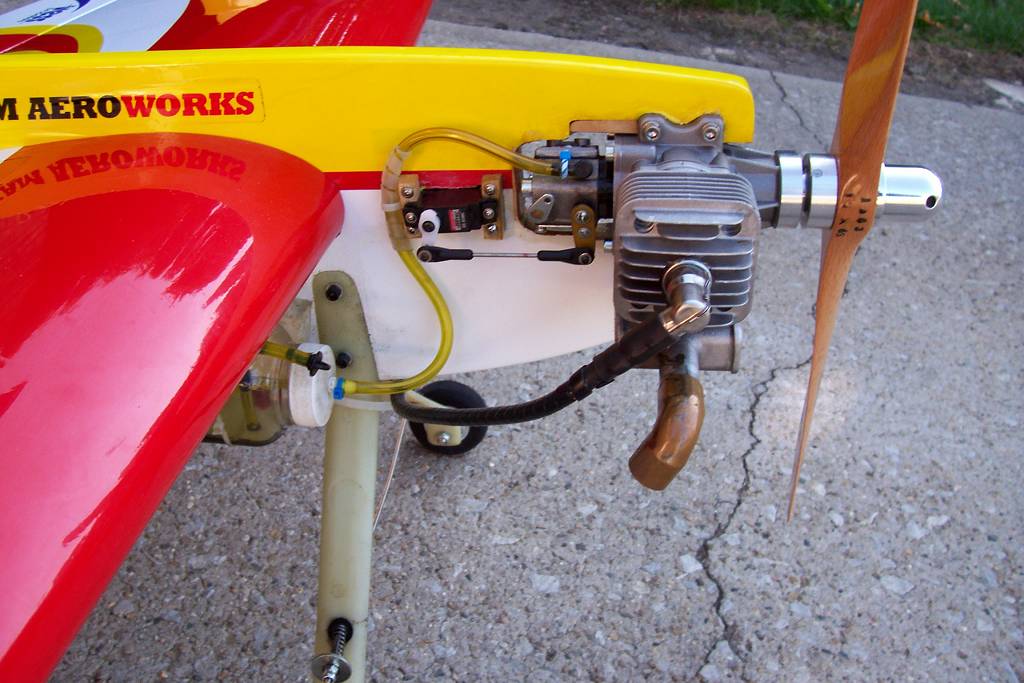

Granted, the photo I'm posting is of a profile with a very short run, but it shows the preferred style of linkage for a gasser.
Threaded rod + ball link ends + small flat washers, with NO metal-to-metal contact.

Those Sullivan nyrods will be fine, but do NOT use the included metal clevis on any throttle setup.
Use ball links as shown in my photo.
You'll also need to create a brace somewhere about mid-way, for the nyrod.
With a long run of nyrod, it may very well flex too much giving some undesirable results, unless braced.

Ameyam,
Imagine for a moment that the eng is installed.
Now measure how far it is from the throttle servo -to- the throttle arm, then subtract say 2"
which would be your ball link ends.
How long of a run is that in your situation?
My guess is around abouts say maybe 12-14"?
Joined: Sep 2008
Posts: 2,224
From: Mumbai, INDIA
A bit longer. I think with the 12" 4-40 I was 4" or so short. I cant check right now, need to go to work (its 7am here). The threaded coplers require t be soldered on the socket end, have never done that and wonder whether its advisable. Do I simply use electrical solder?
I am considering metal pushrod all through with ball link both sides. May be I could get a 2-56 threader jig. It would be useful elsewhere as well
