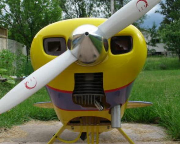

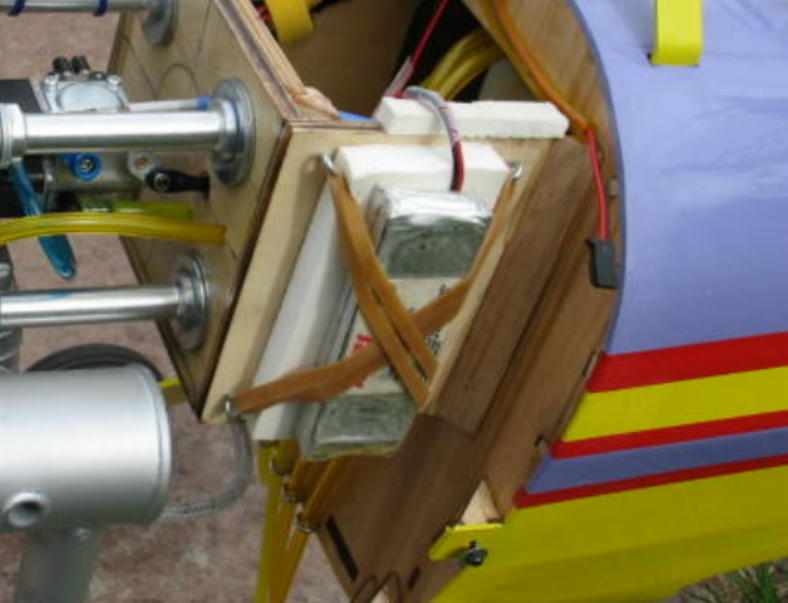

I started out flying electric park flyers 3 years ago and I have a lot of LiPo's just sitting in an ammo box, I now use LiPo's for every thing. One cell LiPo for ignition and 2-cell LiPo regulated down to 6 volts for the receiver.
If you are not comfortable de-soldering LiPo's, so you can use one cell, you can buy one cell LiPo's here.
http://www.maxamps.com/index.php
MaxAmps sells loose one cell LiPo's from 430 mah to 5000 mah.
I have a 4200 (two 2100 in parallel) on my DL 50 ignition (See photo) and a 4000 two cell regulated on my receiver, running the electronics on my Pitts and no worries of letting them sit for a week and then going flying. LiPo's keep their charge a lot better than NiCad's or NiMH. An now for the real bonus even though they are 4000 mah both are still lighter than the 1800 to 2500 mah 4 an 5 cell NiCad or NiMH that most people use.
I have been running my DL50 on a one cell LiP0 >> 4.2 V << (2 – 2100 in parallel) from the moment I first started the engine. I have over 60 flights and no problems. The engine has never flamed out on me. I have run the ignition battery down to 3.3 V with no discernable performance issues.
I did some research on ignition voltages after I fried my Fuji ignition module when my voltage regulator shorted that was regulating a 2 cell LiPo. I decided to try the one cell LiPo and eliminating the regulator after reading the following test done by CH ignitions. The DL50 use the same ignition modules as CH Ignitions.

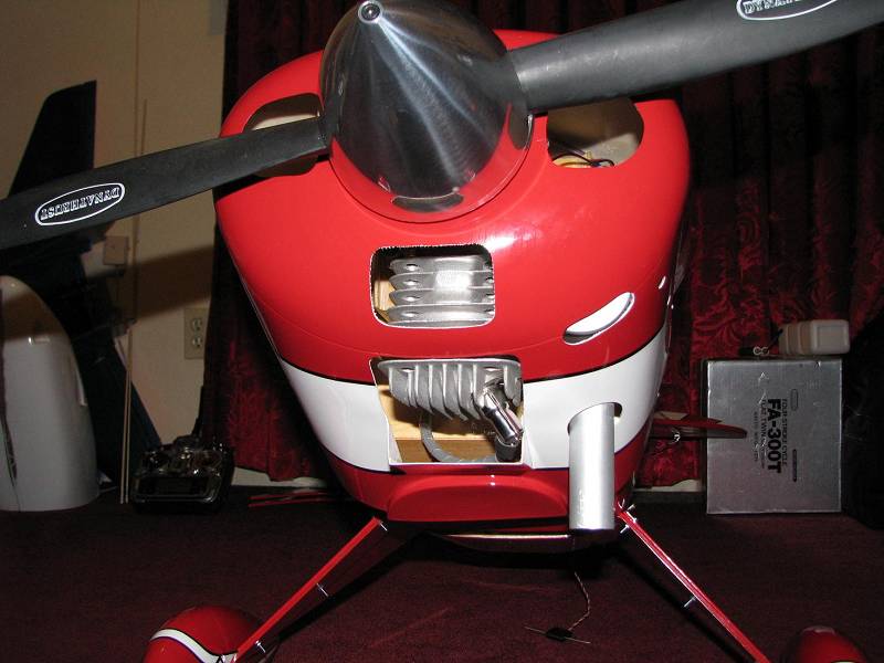

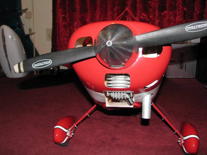

It looks as though your plug wire is rubbing on the bottom of you cowl, you will want to tie that up or remove some more of your cowl or it will rub a hole thru your plug wire. I had the same issue once. The air and vibration from the engine will make this happen very quickly, you add to that the sand paper feel of fiberglass.
Just my .02.

Thanks for the observation Craig,ill see what i can do but the plug wire is really not touching at all,it is a bit close to the cowl but not touching,it has about 1 to 2mms of clearance but i will pay close attention to that,the wire is just hanging since i haven't mounted the ignition just taped it into plase for all the cut outs to be done,i mounted the cowl just for the pictures and to see what els might need to be adjusted

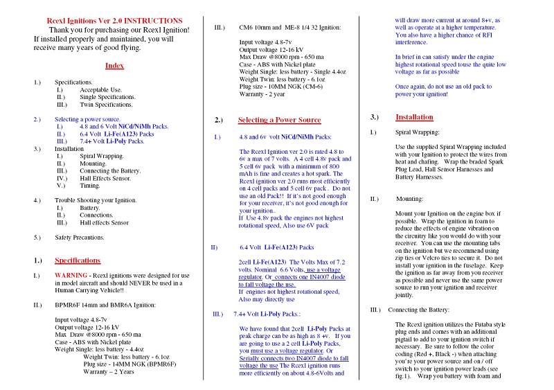

take a look at this post,i was going to use a 7.4 volt lithium ion pack with a regulator to step down the voltage to 5 volts for the ignition but Geppino changed my mind,read his post here http://www.rcuniverse.com/forum/fb.asp?m=7831378 previews page,i wouldn't run 6 volts even regulated might damage the ignition since it is suposebly the highest voltage the ignition can handle,if you dont want to run lithiums then i would sugest a 4.8 pack but even the 4.8 pack can reach a higher than 6 volts fresh out of the charger

Thanks for the info! I will just stay with the 4.8's that I have.. Simple and they work.. I will just have keep in mind that I'm using to different chemisties on the bird... :-)

Hibrass,
Here is part of the paragraph partaining to voltage from the DL50 manual.
IGNITION SYSTEM
The DL50 ignition system is designed for input voltage ranging from 4.8 to 6.0 volts, no more and no less. A battery pack of 1200mah or greater may be sufficient for a day of flying for most users. Check your battery voltage with a voltage meter before every flight and do not fly if the voltage is not between 5.2 and 6.0 volts; the voltage at the start of a flight may not remain for the duration of the flight. Disconnect the battery from the ignition system while charging the battery. The ignition module should be connected to the battery through a heavy duty switch, mounted where it can be reached easily when starting the engine.
NOTE: A 6 volt or larger battery pack must be regulated to between 5.2 and 6.0 volts or it will supply too high a voltage to the ignition module.
If you check here, from the Rcex site, it is telling you that you can use up to 7 volts. This is listed under input voltage in the specifications. It also lists the type of resistor to use to drop voltage.
http://www.rcaerobats.net/GAS_ENGINE...onInfo-v.2.pdf

A diode voltage-dropping arrangement is much better than resistors. Resistors are power-consuming devices, and reduce voltage based on current flow through them, which also varies based on temperature. A diode is a better solution, as reverse-biased, it consistently "reduces" by .7v across it's P/N junction, up to the full amperage rating of the diode, and regardless (essentially) of the input source voltage. It also will be nearly unaffected by temperatures (within it's rating), and although it isn't regulating the output voltage (neither is a resistor), if the source voltage is relatively stable, then the output after the diode is equally stable and consistent with it's .7v drop.
All in what you want to wire in there.
After using regulators, I will stay with diodes.
