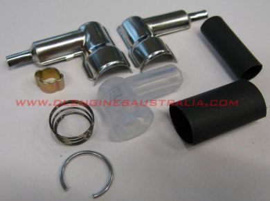

I am just fitting my new DL 50 to a 25% zlin 50, the plug cap does not "lock on" to the plug as described in the instructions.
when looking into the cap, all I can see is a white plastic/composite sleeve that fits over the end of the plug, there appears to be nothing to lock the cap to the plug,can someone please advise if something is missing from my cap.
thanks
John new Zealand

I have replied to your email you sent me from earlier in the day RE the above.
Sorry I didnt answer earlier in the day, but we had an absolute ripper of a day (Saturday) for flying here today, Cool temps, clear blue sky & dead calm winters day, so had been out all day trying my best to wear out a couple of DL50s
Give the plugcap a good push/shove/wiggle, when its on properly it will almost cover the entire plug.

THANKS
I WAS NOT PUSHING HARD ENOUGH
