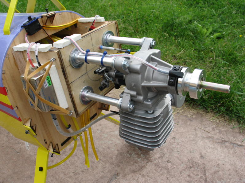

well guys i've desided to go with the DL-50,and as of now i've already mounted it to my GP pitts special,so far so good,ill have to do some wire routing to make for a clean look i bought the saito 300 twin engine thinking that i would like it in this plane,well i do like the saito alot would of made for a great scale like plane with the beautifull sound of the four stroke twin but i want lots of power on this beast so DL-50 it is,ill eventually get a Yak 54 so i can use the saito in the pitts and put the DL in the Yak for unlimited aerobatics,anyway only time will tell,
seems the saito is even longer than the DL-50 and the weird part is,the manual calls for the 300 twin but not a saito,an os gimini 300 twin,i figured they would be the same lenth,well nuff said,i'll post some pictures when the plane is ready for a maiden flight,one question,why do the gas engines have a return spring on the throttle?as i said before,this is my first gas engine hence the question,i just thought that with the spring i will need a stronger servo on throttle,or i thought it could be removed

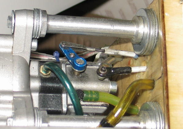

Do not remove the throttle spring, it keeps tension longitudinally on the throttle shaft, so you do not get excessive play. You can unhook it if your want. I left my alone, as the tension it puts on a standard servo arm, is not enough to make a difference to the servo.

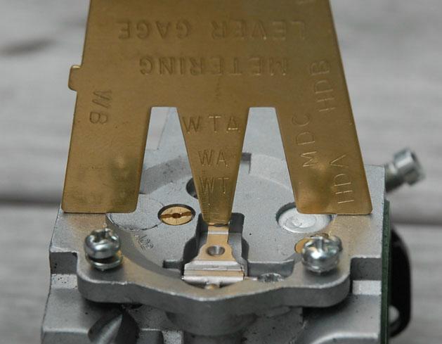

Hi Shawn45
I had the same problem on mine until I adjusted the needle leaver inside the carb.
The needle leaver needs to be lower than the carb base. Mine was at the same height as the base and running rich causing the mid range burble and a lot of mis-fires. I was making adjustments to the leaver a few thousands at a time and getting nowhere. Once I read the article below and set the leaver below the base by what looked to my eye about 2 mm give or take, it ran like a top, all the burble and misses are gone. It idles and accelerate a lot better as well.
I also did a spark plug test by running full throttle for a minute and shutting it off. Then I removed the plug and now it's a perfect tan colour.
Make sure you can run at full throttle on the ground for a couple of minutes without the engine running out of fuel after the adjustment. Be careful not to overheat your engine.

Here are the instructions and a photo from the article. http://www.geocities.com/farellus/idle_adaptation.html
The Metering System is very simple: It consists of a pivoting lever working like a seesaw with a spring on one side and an Inlet Needle (with a red rubber tip valve) on the other.
If you don't have the pressure-testing tool, don't worry, just make sure you clean the carb, blow it dry and use new diaphragms & gaskets and set the Metering Lever height; The resulting pop-off and reseat pressure will be functional as long as you don't damage or modify the Metering Spring:
1) Don't deform or cut the small Metering Spring. If in doubt, replace it with Walbro part Walbro part # 98-320-7 (OEM # 503 28 12-18; WG8 carburetor).
2) Set the Metering Lever at the correct height as explained below.
The height of the Metering Lever on any diaphragm carburetor is critical for controlling when and how far the inlet needle 'pops' open, thus configuring the engine's acceleration characteristics. If the Metering Lever height is set too high, it may create a rich condition, while a Metering Lever set too low may create a lean condition. The height of the Metering Lever must be 1.7 mm or 0.067" (WG carbs) and 1.45 mm or 0.057" (WB carbs) below the edge of the carburetor body. Walbro sells a calibrated brass plate gage to be used as depth meter (Walbro item # 500-13-1) available through most power tool shops.

I did the leaver adjustment to mine >> Things to be aware off >> be very careful with the little spring it is very squirmy and will zing out or your fingers fairly easy. I lost mine for about 5 minutes on one adjustment; I was lucky to find it. After that experience, I left the metering leaver and the spring attached to the carb base. I used two very tiny screwdrivers to bend the leaver into the correct position; you need to be very careful using the tiny screwdrivers, as you may damage the pop off needle, if you put too much pressure on it.
If you set the metering leaver too low you may run the float cavity dry and your engine will quit. Run it on the ground at full throttle for a couple of minutes to see if it will run without running out of gas, be careful not to overheat your engine.
Also do a spark plug test to see if you are running to lean.

I had no problems leaving the spring on. I'm using a Sullivan Golden Rod on the throttle servo ( nylon rod inside a nylon tube ) The throttle servo does not even know the spring is there ( no buzzing or hunting what’s so ever).

i wont mess with the spring,ill do the same you did,and will get the throttle servo relocated,will use the plastic pushrod,i already got the engine mounted but still need some other things to complete the plane,i.e.pilot bust,prop,tank stoper for gasoline,and some other little things including the plastic pushrod,i also need to clean up the wireing a bit,have to cut the templates for the choke rod and the ignition module and the throttle arm,this is taking longer than i thought but is all working out very good,the clearance on the backplate and the front of the cowl worked out very well,it was a very tight fit,seems great planes made it a couple mms too short but still worke alright,by the way did you mount the ignition template solid on your plane?did you epoxy it in plase or did you use screws,im assuming that the idea of using the plate is for the ignition to have some sort of vibration isolation right?

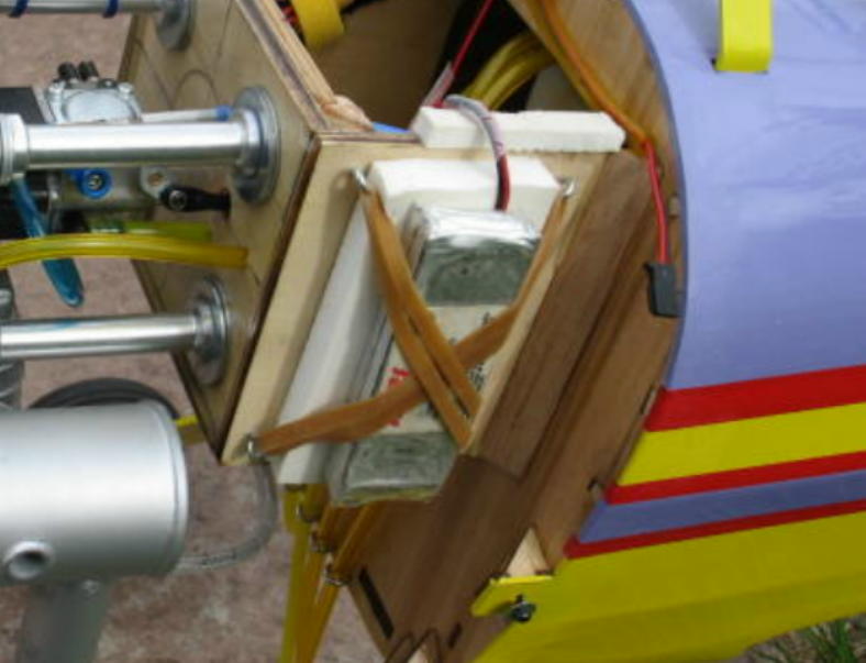

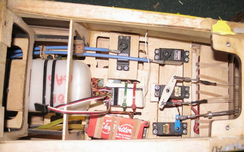

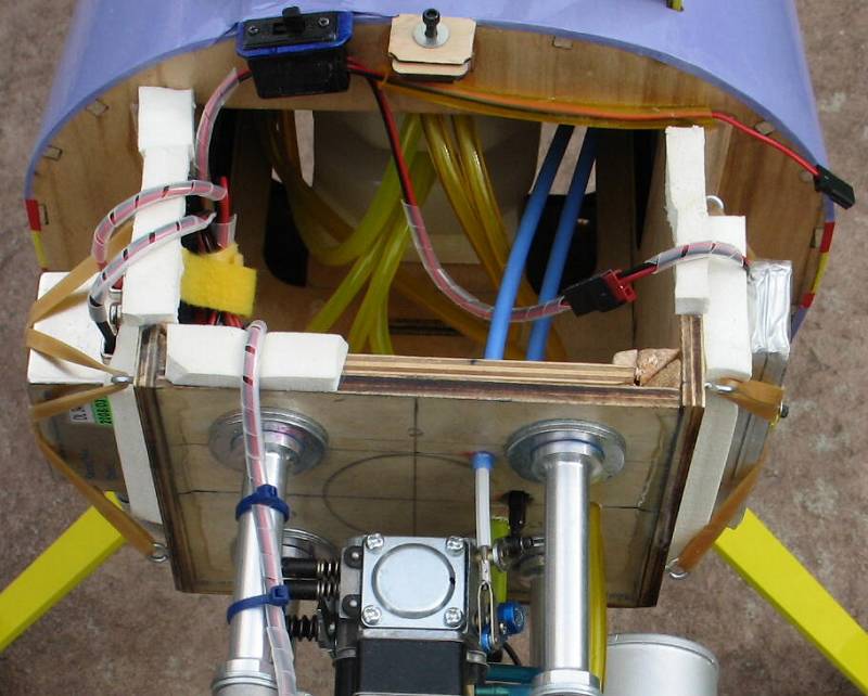

Hi switch26,
I mounted the ignition module and battery on a foam base and rubber bands. (See Photos) Gas engine tend to vibrate a lot more that glow. You will need to check everything after a good days flying, as screws, bolts, nuts, set screws, etc… will come loose.
You will also need to keep all ignition components, including battery and ignition switches 10 inches away from the receiver, servos and Rx battery. 10 inches will assure you do not get glitches in your control electronics.
I also used a High Tech Blue Aluminium Servo Arm on the throttle, as the one that comes with the Walbro Carb is useless.

Very nice setup Bud,do you have to change the rubber bands quite often?looks like a vibration free setup,i'll see what i can come up with,that would be a better signature than mine,LOL
by the way i'll be running spektrum so i dont think i'll have any glitches with it but i am still going to mount the bateries,switches and servos as far as i can for peace of mind,oh yea i forgot to ask is it important to have an engine cut off module?i see alot of advertisement about them

Hi switch26
I had to change the rubber bands on the battery side once, as smoke oil (I use a mixture of diesel fuel and ATF for smoke oil) got on them and harden the rubber. The ignition module rubber bands have 60 flights on them and still look like new. I use foam and rubber bands for everything, I mounted my Rx battery and my smoke pump with rubber bands.
Opinions very a lot when it comes to ignition cut off switches, and there are a variety of switches to use, mechanical, electrical and fibre optics. I just hooked up my choke to a servo and I use that to cut the engine. In my humble opinion it kills two birds with one stone, as I did not need to hook up some fancy and complicated mechanical choke leaver to start the engine, and eliminated a switch component that can give me problems. I just flip a transmitter switch for choking and killing, it’s very convenient.
Geppino
Hi doublesixes
Geppino
I was messing with the needles today and looks like I can lean the idle a bit and still have it reliable. It still burbles in the low/mid range but occasionally. I think I will continue fine tuning it tomorrow. One thing that I tried, is to let the engine idle at 1720 rpm for about 20 secs then throttle up in an instant. If there's no hesitation and instant response, then it most likely will behave OK in flight. If, on the other hand it shows the faintest sign of hesitation or responds slower than instant, the engine may quit in the air.
I fly a very light plane and I'd say that 30% of the time, my engine is idling because of my flying style so I'm at a higher risk of deadstick than pilots that run their engines in their mid to high ranges. I need instant response from idle since I'm doing (or trying) 3D stuff close to the deck. Fortunately I had all my flameouts 2 mistakes high!

very good idea using a servo for the choke but i already have 8 servos on the plane as it is,ill be running a lithium battery pack with a regulator to drom the voltage down to 6 volts,im also going to run a lithium for the ignition and voltage regulator to drop the voltage to 5 volts,i dont know as of now if i will be able to run a smoke system,i would like to but i would have to come up with some ideas and build the system with a servo tray,the great planes pitts is built very simple and should be easy to build the system,but for now all i want to do is to fly the plane,heres another cool signature i i like

ORIGINAL: switch26
wont the engine flood if you cheke it?
My DL50 needs to be primed with ignition off and the choke on. Usually 10 or more revolutions of the prop, then I turn the ignition on and flip it 2 to 3 times more with choke on, until it pops, then choke off, flip one more time and away it goes. In my case this is how my DL50 wants to start, it's very consistent.
Geppino
