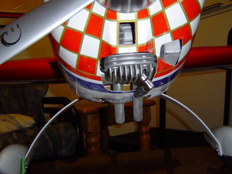

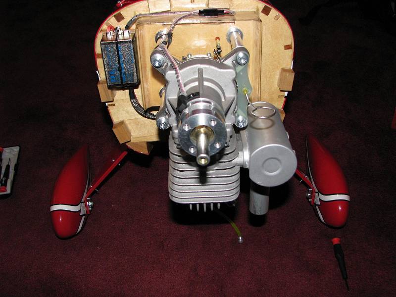

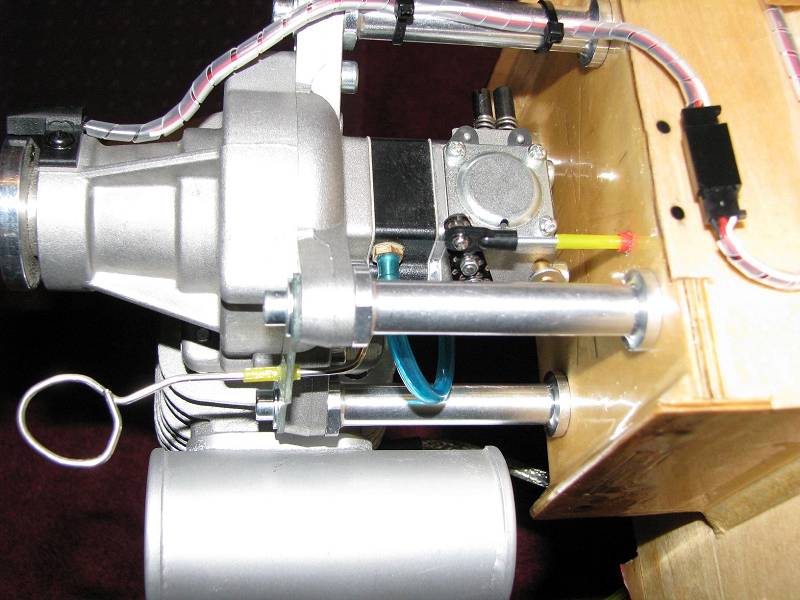

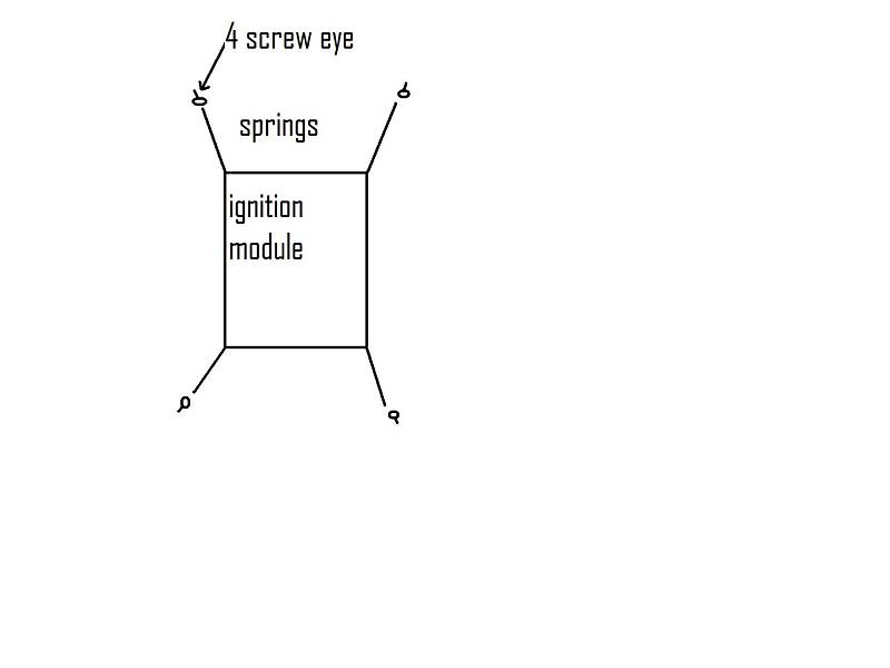

ok guys here's my engine setup,it is all done but i still need to figure out where to mount the gas filler tubing,any ideas on that?i have a fuel dot,something very simple but i think it should work just fine,i just don't know where to mount the fuel dot,i also need to get a couple hose clamps to keep the hoses and wires in place,will probably make a trip to the hobby shop,by the way can the DL 50 be broken in with a 20x10 prop since i already have one?
i wouldn't want to buy two different props,i think im going to go with a 23x8,as for the pictures,you may not see it but the ignition is mounted on a small platform and has some vibration isolation padding,it is from a gel insole for women's shoes,very good for this application,i had them laying around since the wife didn't like them i put them to good use i had a real good idea for isolating the ignition but i don't have a whole lot of space there,i was going to suspend it with four low tension springs mounted on a piece of either G10 or lite ply,should work great for the plane that has plenty of room for it,here's a ruff sketch of the isolating platform

Looks good.

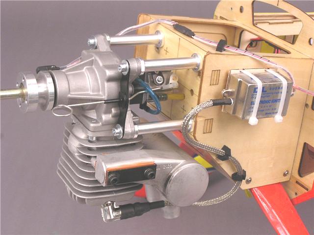

You may want to wrap your ignition cable to the plug with the larger plastic wrap if it came with some. I can't see it in the picture if it is there. Both of my DL's had some included to protect the shielding on the wire. You can see it in this photo..

yea i am going to use the plastic wrap on it,i had it on but i took it off to work on it,but yea is looking good so far,i had a hard time with the cowling seems Great planes made it about 1 or 2mm shorter but i moved it around till i got a good fit on the plane,it only extends about 2mm on top of the planes nose,4mm would of been great but what can you do?i didnt want the spinner to extend too far forward

Good looking install, there! Good job.
I would not go to a 23 x 8 from the 20 x 10... more like a 22 x 8....you'll be much happier when it's new and producing better thrust without overheating. A 23" is a lotta load when new.

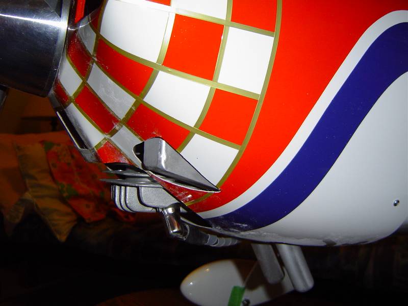

It looks like the carb is to close to the fire wall, you you may need to cut out around the carb intake.
oh no!!! i was afraid of that,i would really rather not cut the firewall but i guess i wont have a choice,ill try it like that and see how it behaves,ill cut around the carb if i have to but we'll see,how is everyone suporting the ignition wire?im really having a hard time finding the wire clips for the spark plug wire,i thought about making my own out of either wood or plastic stock cut me a big enough pice to make a wire holder then make a hole and cut across the hole to split into two and that way it will hold the wire,epoxy one half to the firewall and put the other half over it to make a complete clamp,any ideas?the LHS doesnt have anything,i went to Radio Shack and they dont have anything i can use

If your looking for wire clips, try the local auto parts store. You should be able to find some in different colors for a little bling.

i tryed the auto parts store,home depot,and radio shack,no luck,they have a few clips but not what i was expecting to find,i'll keep looking or i'll figure out something

Try to find the little plastic mounts that go on automobile valve covers that holds the spark plug wires in position. They have *those* for certain at the local auto parts store.
