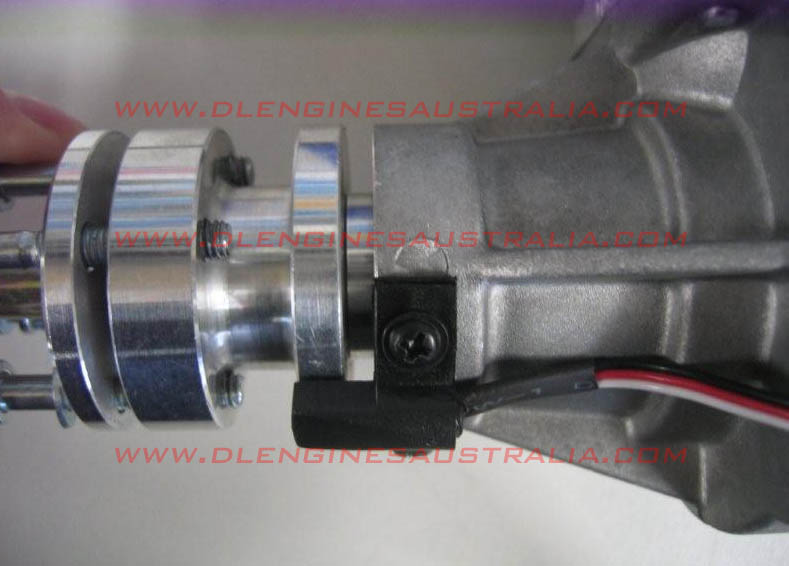

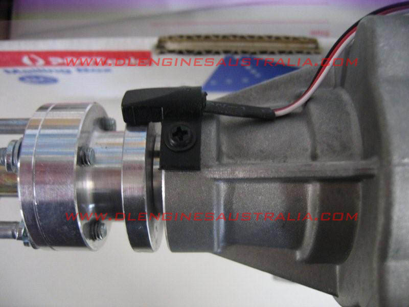

ORIGINAL: salerno
how do you detirmine if bracket has slipped? i checked the bracket and there were no old screw indentation where it was tightened on from factory, is there a way to check where it should be? what degree are they set from factory?
Hi Andrew
On every sensor I have removed there is a slight mark/indentation in the plastic from the flat washer heads of the screws that hold the sensor in place.
As a starting point, I find looking down at the sensor the edge of the plastic sensor bracket is ~ 0.5mm (from memory) from the centreline on crankcase. I will double check that measurement and email you.
Hope that helps with a starting point. Let me know how you get on tonight.
Cheers
Scott.
EDIT - Typo on oreintation of motor/sensor
Old 07-29-2008 | 09:42 PM
  #2334
Bob Pastorello's Avatar
My Feedback: (198)
Posts: 6,707
From: El Reno, OK
Default RE: DL-50 engine
ORIGINAL: captinjohn
Where is the best price for a DL50? Thanks, Capt,n
THere is more to it than price - you know that.
In the US, it's either DL USA or Valleyview, IMO.
Nowhere else matters.
Old 07-29-2008 | 10:19 PM
  #2335
Posts: 12,957
From: Hesperia Michigan, MI
Bob...Your right on...I shhould have asked where is best service with a good price. Best regards Capt,n[X(]
Old 07-30-2008 | 02:21 AM
  #2336
Joined: Oct 2007
Posts: 119
From: Western Australia, AUSTRALIA
ORIGINAL: dlenginesaustralia
ORIGINAL: salerno
Hi Andrew
Cheers
Scott.
Hey Andrew
Heres pics of the default sensor position as from DL Factory. Pic from bottom & from side.
Cheers
Scott
DL Engines and Hobby Australia
www.dlenginesaustralia.com/dlshop
ID:	1000642   Click image for larger version
