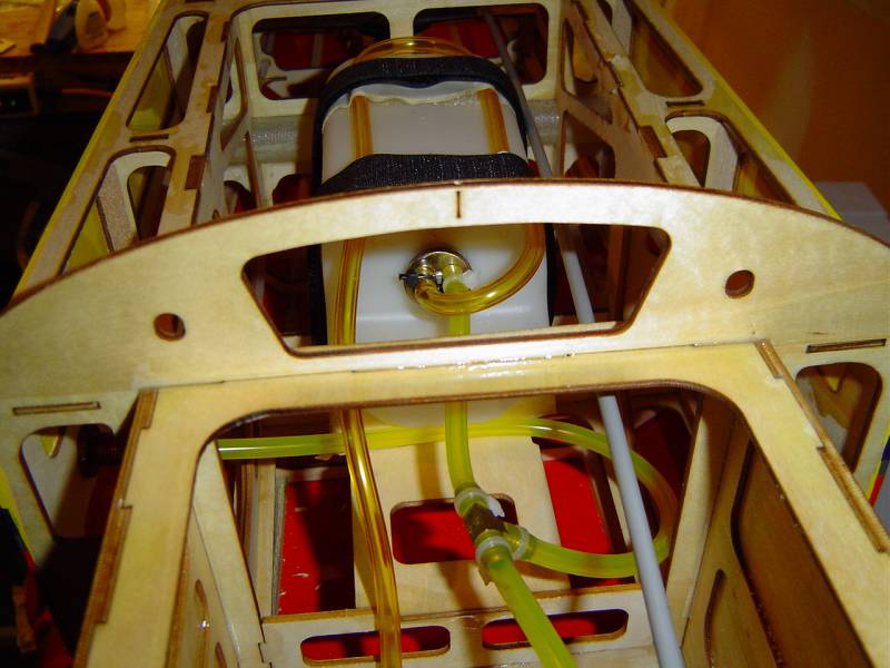

I hate to break up the party But can someone please send me some photo's of their fuel system with a fuel dot installed. I am not sure how to run the vent part of the system????? Thanks Eric in so cal 80 + deg today. But to windy to fly, Same for tomorrow

Here ya go

Thanks great photo's. So it looks like you t right into the line that goes from the tank to the carb right? And then the vent line comes off the tank and does a big loop and then is set up so it drips out the bottom when it is full right? I can't see that well where your vent line goes but is that right? Thanks for that help. The rate I am going and the money not dry yet. I should be in the air by mid week next week

You got it all right Eric, you can let the vent line exit anywhere convenient on the bottom of the fuse or cowl. The loop in the vent line on top of the tank is the most important part. It will keep fuel from being able to siphon out of the tank and if the plane is tipped up on it's nose only a few drops if anything at all can leak out.

I picked up a useful tidbit when looking at your photo. I don't know if it is yours, but that is a great idea to have the "T" facing away from the fuel dot location.
I use the H9 fuel dots and they sometimes pop out (but not the plugs, thankfully!!) because my fuel line runs straight from the "T" to the fuel dot fitting. Your arrangement would put an end to that.
Thanks!

I use the Madison products Miracle fuelers. They are 1/4 turn and work awesome. Never pop out, just twist them out when you want them out. Twist them back in.
http://www.qualityrcproducts.com/pro...clefueler.html

Do you have an inline fuel filter? If not, do yourself a favor and put one in.

Bob, yes I did that on purpose and it seems to work good.
Chuck I don't run filters on my planes. I use a felt type filter on the pickup in my gas can as well as an inline filter on the filler hose going to the plane. So far I haven't had any problems with gunk building up in my carb screen. That's not saying it won't happen. But so far it has been working for me.
