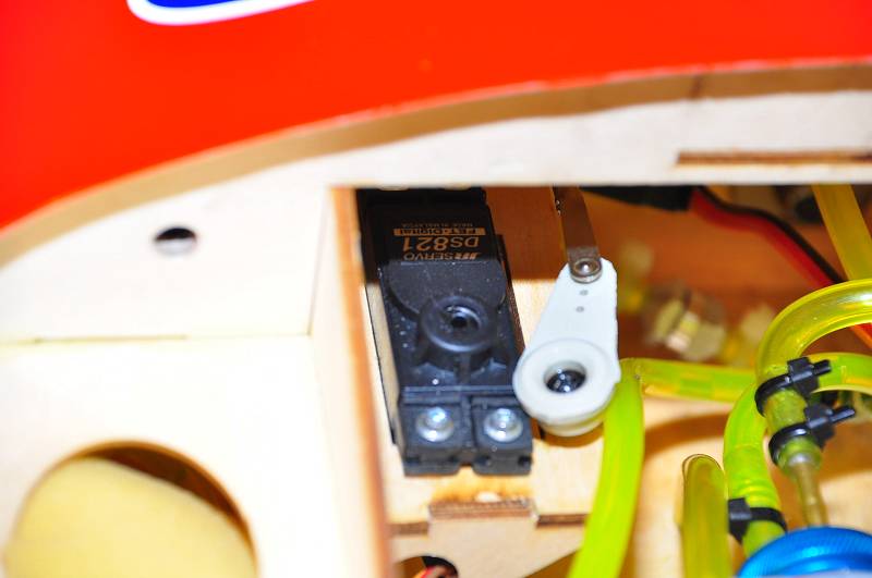

Old 04-18-2009 | 08:12 PM
  #4598
dan4466's Avatar
My Feedback: (68)
Posts: 588
From: perry, Lansing MI
Default RE: DL-50 engine
Tried to start my DL50 tonight to show someone and couldn't get it started. After trying everything I noticed this. It just snapped. This is my first gas engine and I was shocked. Plane doesn't really vibrate that much. Have just been breaking in the engine. It has about two hrs on it and was gonna make the maiden flight tomorrow. Guess I'll be getting a MG servo. I know there was a lot of talk about MG servos for the throttle, but I went thru my last several yrs of MAN and RCReport magizines and everyone uses standard servos for the throttle on gassers. There was a couple of digitals, but I saw none of the reveiwers using MG servos on the throttle, so I figured I was fine. Guess not.
Old 04-18-2009 | 08:17 PM
  #4599
Joined: Jul 2008
Posts: 369
From: Miami beach, FL
Looks like you had the throttle too far open. Always be sure there's a little play left. Even the strongest metal gear servo will die eventually w/o a properly setup throttle linkage.
Old 04-18-2009 | 08:24 PM
  #4600
Super08's Avatar
Joined: Dec 2007
Posts: 4,121
From: Fort McMurray, AB, CANADA
That is something I am not sure everyone checks. I always set my endpoint short a few clicks from where the servo stops buzzing so it will never be pushing up against the stop on the carb at full throttle. All that does is transmit any vibration directly to the servo by being under constant pressure. Just something I do, others mileage may vary.
