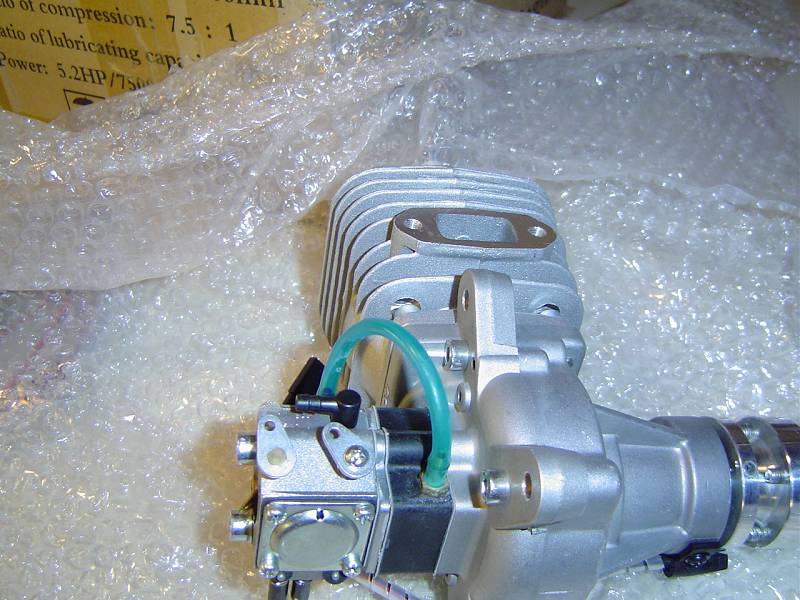

Well im not really excited about putting that vent hole are watever yall called it. Can someone post a pic off how they did it are what it looks like, im not really shure what yall are talking about. Next time I fly it im going to try and do some tuning and see if I can fix it like that, but from what I can understand from you all, thats not going to help. If someone could post some pics I would greatly appreciate it.

Moki the vent is the small hole in the side of the square plate with the circular raised section. When a problem with mixture is encountered inside a cowl it can be rotated to a different direction. If that doesn't work a 1/8" brass tube can be soldered to it and a length of fuel line run into the inside of the fuselage etc. If you search the tread there are a bunch of posts and pictures on how to do it.

Here's 1 of the metering diaphragm 8-32 barb. The other three are the velocity stack I just installed.
You just tap the vent hole on an angle for 8-32. Have somebody silver solder the thing in after you snug it up....not too tight. Or use red lock tite like I did. Then grind the inside almost flush so it doesn't restrict the metering diaphragm movement. Very easy to do.

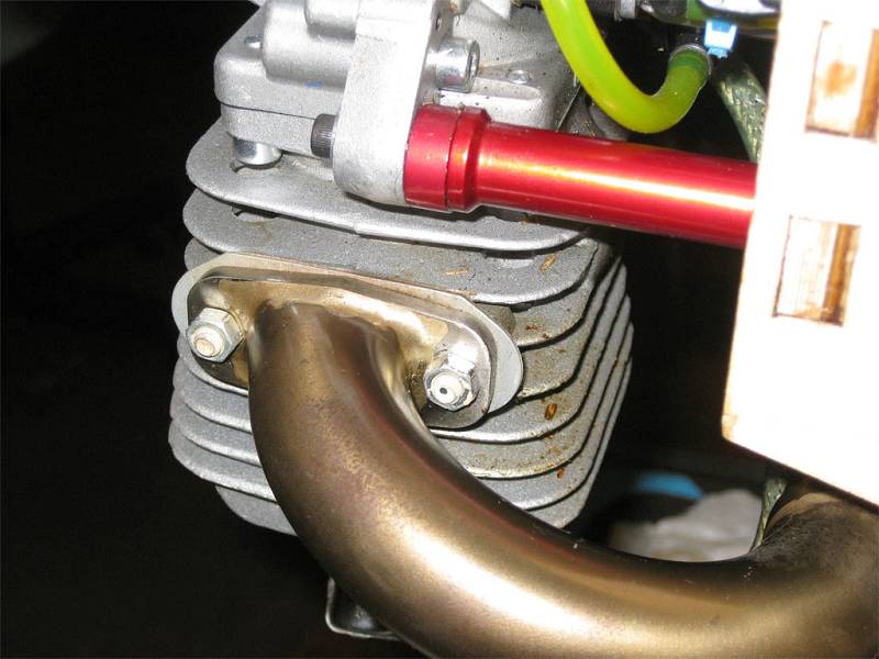

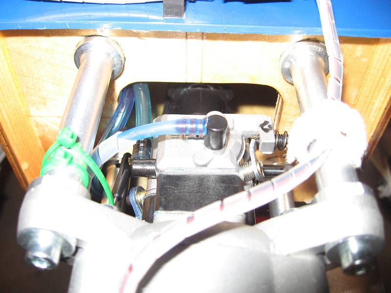

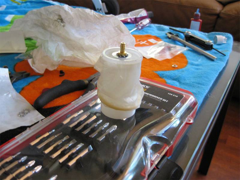

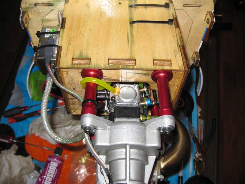

Had to replace the fuel lines so here some pics of carb vent setup w/ condom of my EF Extra 300. For the old people, the last pic shows how well the header is holding after 200+ flights w/ the gasket that came w/ the engine.
