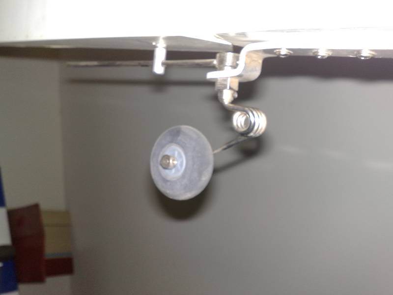

I hate those pull-pull springy things, they're not positive enough in windy conditions. I use one like this; http://www.troybuiltmodels.com/items/TBMTW33CF.html
Old 05-07-2009 | 11:57 AM
  #4752
Joined: Jul 2008
Posts: 369
From: Miami beach, FL
Default RE: DL-50 engine
Thanks I like that better too because it'll be a drop-in replacement for my EF Extra. Early versions of this plane had a similar tail wheel of very poor quality.

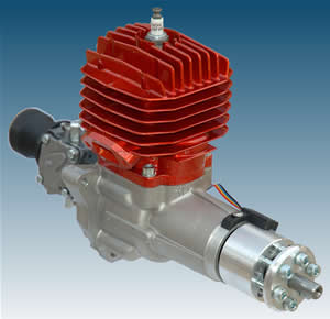

ORIGINAL: JoeAirPort
That was not the case with me. It clearly sputtered in knife edge only one direction. Also it seemed lean inverted. This totally too that problem away. No doubt about it.
Joe
Hey Joe!
Since I am from Bulgaria it will be a bit harder to get the velocity stack. In all cases i think it really improves the engine's work and gives some more power. So from where d oyou have yours? I have a friend in USA and maybe I can ship it to his address and he will bring it to me.
Would appreciate your help!
Best regards!
Old 05-07-2009 | 01:12 PM
  #4754
JoeAirPort's Avatar
My Feedback: (41)
Joined: Aug 2003
Posts: 10,259
From: Milwaukee, WI
ORIGINAL: Pilot013
Joe
Hey Joe!
Best regards!
I got mine from Jody at ValleyviewRC.
They are very inexpensive. Less than $5 US.
Mine's running so good that for less than $5 they go on all of mine from now on.
http://en.wikipedia.org/wiki/Velocity_stack

Before you do that try soldering a 1/8" id brass tube to a section of flat brass plate. Drill a hole in the brass plate that permits attachment to the face of the carb plate, orienting the end of the brass tube into and at the edge of the carb opening. Don't restrict the choke plate with the brass tube. The other end of the brass tube is connected via a section of fuel tubing to the opening in the diaphragm plate. No shipping costs and no parts costs for things you likely have laying around the shop now. The problem has nothing to do with the carb inlet design itself.

ORIGINAL: Tired Old Man
You mean like a 3W? I know of that system. You just make sure the metering vent and the air inlet are at the same pressure? I got the v-stack for almost nothing from Jody at Valleyview. Takes 1 minute to install it (I'm slow). Had the 8-32 barb laying around. Had some tygon to run it into the fuse. It's all done. I always wondered if that 3W system worked. I saw it on their engines so I call it the 3W system.

Not to be argumentative but I worked with Joe on his running quality issue pretty much from the beginning. Each change was made individually by itself to see the results of that change. Improvement was noted, but the last issue to clear up was a mixture change in only 1 or 2 flight attitudes. I had had the exact same experience before on a 50cc plane with a rear carb and as a last resort I put the v-stack on to get the intake air from a less turbulent source inside the engine box, it worked. Joe wanted to try it, appearantly his results were similar to mine. Velocity stacks are not a cure all and seldom do much of anything if the things are running well to start with but there are applications that can create conditions where a velocity stack can have a beneficial effect.
BTW, pretty much all of the 3W singles with rear carbs look like these.

Not all, even excluding the few side carbed versions. Their bottom carb mounted twins use a "snorkle" with a diaphragm tube to minimize the same issue that you and Joe have been dealing with.
Nothing wrong at all with trying a velocity stack but for some a stack may generate space or access issues. Just something to try before going to a stack. I'm sure I'll remember something that I'll want to add in this but it'll be another post when it happens....

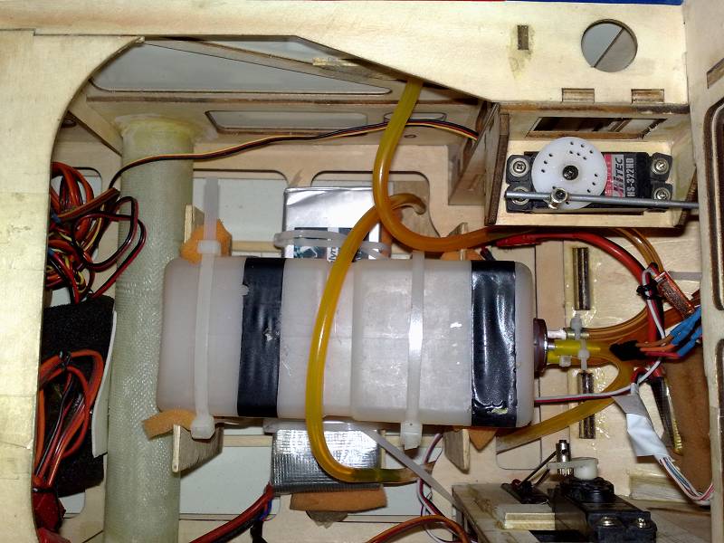

Hi Joe
I removed the tail wheel assembly and checked its Wt its 50 g, havnt replaced it though. Managed to get rid of 160 g nose Wt by moving the Rx batteries forward on the side of the engine box. I will put on the 22 x 8 JXF and give it a try this Sunday. Our field is located at 600 ft ASL but the ambient temperatures are very high around 110 F, I am hesitating to lean the engine fully it will probably overheat or should I lean it to peak RPM ?
Thanks for all your input guys.

You could save another 2-3oz by replacing that servo operated switch, with a fiberoptic alternative, if you must have a second way of killing the engine aside from dropping the trim on your throttle.
