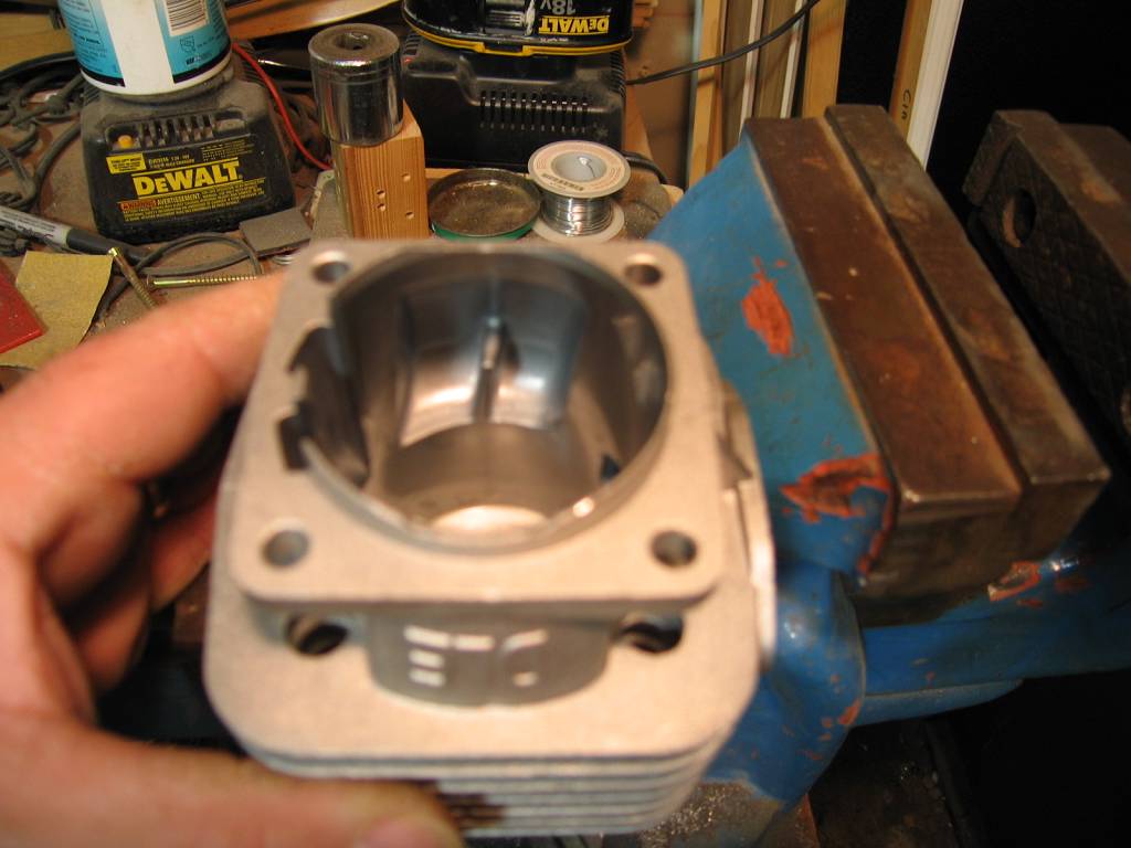

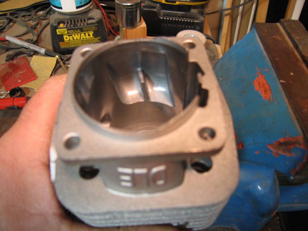

Your right, I was just being a pill, most have not seen the new porting though.

I was impressed to see the clean crisp ports in the 30. A far cry from the early DL50.
What's the difference between pressure die cast and pressure injection cast?
The new cylinders look like the quality of an investment casting.
