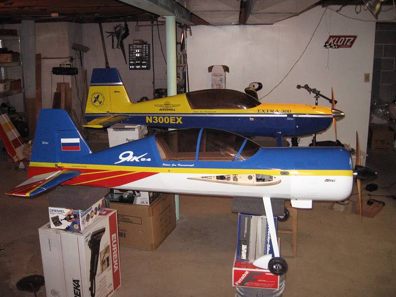

No question. Especially with the stock exhaust. The two planes in the pic are 88.5" wing span. The Yak is 17#, 13 oz, The Extra 17# 10 oz. The power is incredible. The best I have had on any plane. I think even 19 pounds would be do-able but no more than that for fast verticals and strong hover pull outs. Even on windy days the DL-50 has enough to get me away from the ground in close calls. Technically the Extra is a DLE-55 but I can't tell the difference in power.
