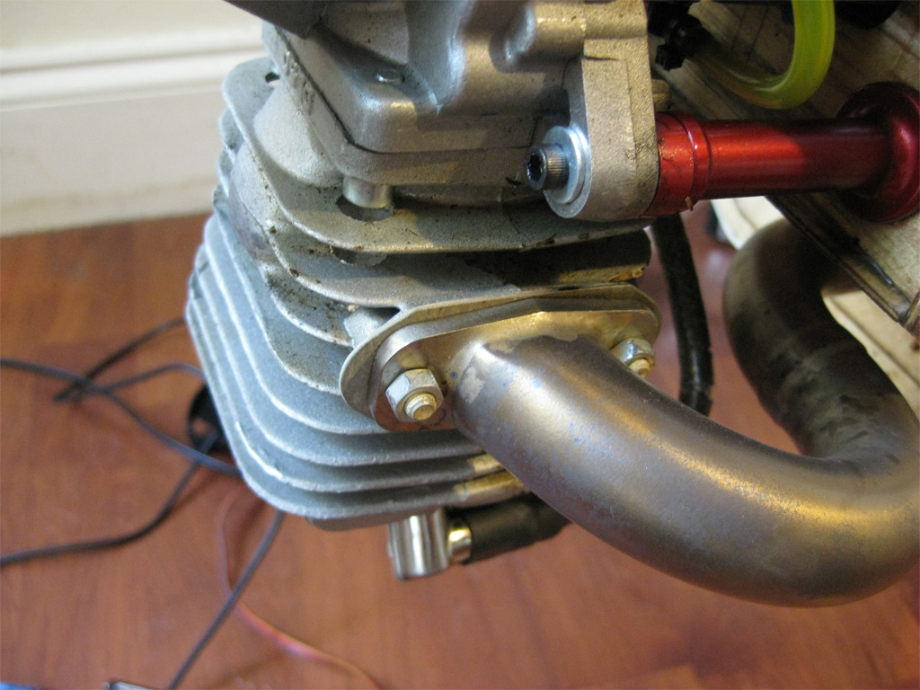

Attached the exhaust of my DL50 after 250+ flights. No signs of any leakage w/ stock gasket. Only used some heat-resistant loctite.
