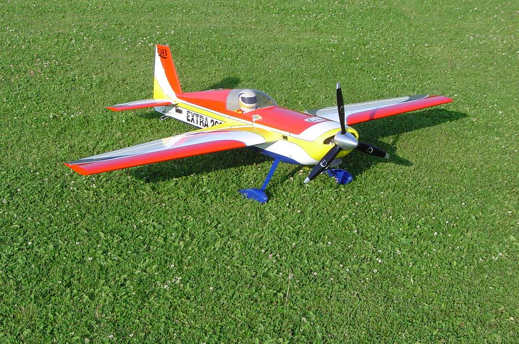

Actually the DL works good in this airframe. Myself and others hae done it. There is room for a 22" prop but you do have to watch your landings. I found a 20" three blade worked very well.

looks nice!!!!!!!!!! i can imagine that think getting out of hovers... lol.

I can't even begin to explain what the vertical is like!

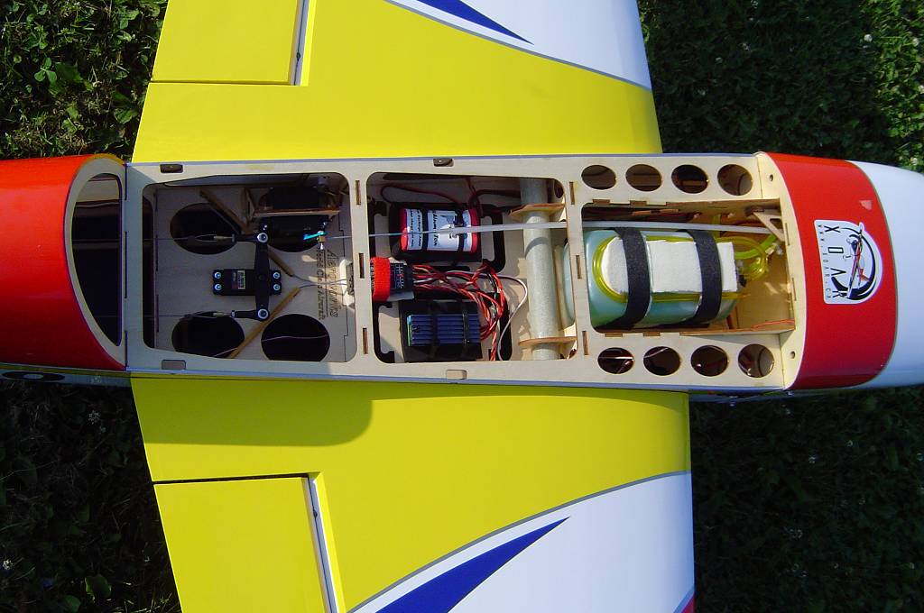

To make it fit you need to get shorter standoffs and put the carb through the firewall or remove the firewall and move it back and reattach it. Either way works good. By mounting the throttle servo as far back as you can it will avoid adding any weight to balance it with the DLE.

Very neat installation Super08 [sm=thumbup.gif]
I wish mine were this neat !
