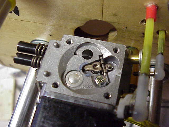

Does anyone know what you set the paddle on your metering needle under the diaphragm? I'm thinking 1/32 above the carb body but can't remember!
Old 03-30-2010 | 09:29 PM
  #5992
Super08's Avatar
Joined: Dec 2007
Posts: 4,121
From: Fort McMurray, AB, CANADA
Default RE: DL-50 engine
It should be flush with the metal of the carb body on each side of it.

Super08, thanks for the info. Is there ever an exception or what happens if it's to high or above the carb body? Thanks again. Roy
Old 03-31-2010 | 10:19 PM
  #5994
Super08's Avatar
Joined: Dec 2007
Posts: 4,121
I am no carb expert, but if it is foo far one way it will cause the carb to be lean. If it is too far the other way it will make the carb richer and if too far will not let the needle valve close causing fuel to run out of the engine even when shut off.
Old 03-31-2010 | 10:23 PM
  #5995
Super08's Avatar
Joined: Dec 2007
Posts: 4,121
It also depends of which series of carb. The WT and WJ carbs it is to be set flush with the flat area that surrounds the end of the lever. Other carbs such as the HDA are set differently. The carb on the DL/DLE are WT series.
Old 04-01-2010 | 12:18 AM
  #5996
jedijody's Avatar
Joined: Mar 2005
Posts: 2,812
For the WA, WJ, and WT series carbs there are no exceptions, the end of the lever is to be flush with the surrounding casting. If it is to high it will run rich in the midrange, to low and it will run lean in transition and will be impossible to get a good idle and still be able to transition. Doug is right, if way out to high it will flood constantly and leak fuel even when not running, way to low and there will be no go fast.  If one has a very good understanding of how these carbs work and speaks/listens/feels fluent engine, one can make very small adjustments to the lever height to get an engine to work better in the mid RPM range BUT, all other contributing factors must be checked, verified and or corrected first or you could just be masking or moving a problem to rear it's ugly head somewhere else. Reeds, gaskets, pulse lines/passages, fuel pump parts, filters, pop off pressure, and timing all should be verified and or corrected before attempting to alter the internal carb settings.

Thanks everyone. It's no way around it. I have it setting to high. Cranks good but runs rich on bottem. rough midrange but a good high end. I will play with it and see what happens. Everyone have a Great and happy Easter. Roy
Old 04-03-2010 | 08:12 AM
  #5998
My Feedback: (106)
Joined: Nov 2003
Posts: 2,540
From: Martinsville, VA
OK Guys. I forgot a photo is worth a thousand words. When you say even with the surrounding body, I take it to be "Even with the area I marked in blue??? thanks all and Happy Easter. Roy
Old 04-03-2010 | 08:31 AM
  #5999
jedijody's Avatar
Joined: Mar 2005
Posts: 2,812
That is correct.
