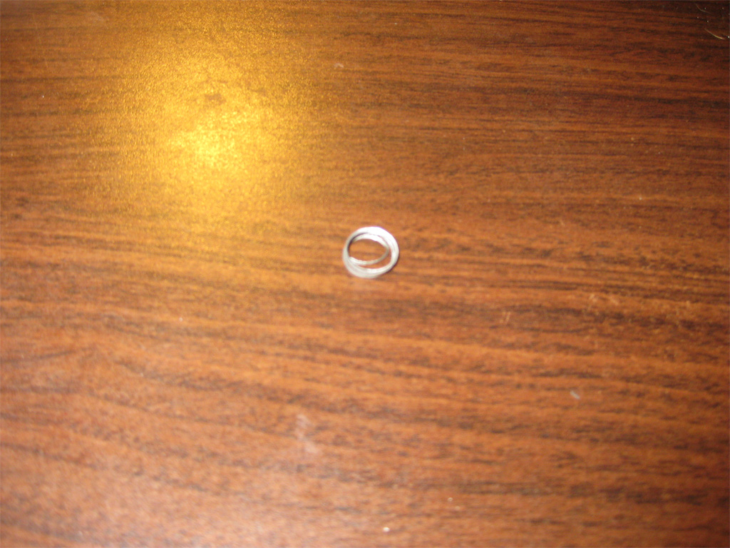

Well I put the new piston in, spark plug went in rough, took it out and some brittle spring fell out with it I guess this is a RIP heli-coil. What size do I need and are there any local stores carrying these things?

Looks like your spark plug pulled the threads out of the head. The thread size is 10mm x 1.0. The Heli-Coil kits should be available at a good auto parts store or fastener wholesaler like Fastenal, the kits are a little spendy so you might try a good local small engine repair shop, it would be a common exersize for them.
Old 10-07-2009 | 08:37 PM
  #5742
Joined: Jul 2008
Posts: 369
From: Miami beach, FL
Default RE: DL-50 engine
ORIGINAL: jedijody
This s*cks
I'll make some calls tomorrow AM or else I'll order a kit from Amazon. Not that expensive http://www.amazon.com/Heli-Coil-5542.../dp/B000CMJS7M

That's what I mean, kind of spendy. You already have a new piston and ring, a new jug is only $15 more than that Heli-coil kit, or a Heli-Coil installed at a small engine shop would only cost about $10. When the cost of repair exceeds 50% of the new value I usually opt for replacement.

I managed to strip one of the muffler bolt holes out in mine. It is m5x.8 I bought a complete heli-coil kit on ebay for $5.00 and fixed it in 10 minutes. Try ebay, lots of different size kits there.
